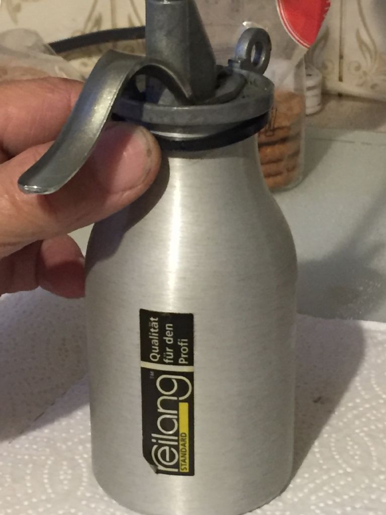

                img_9912.jpgI put some hypoy oil in mine and the seal has swollen out of it's groove and no longer seals!

                                  The only thing I didn't like about the Reilang is the rubber washer. It slips out as you tighten the top. It won't happen the first time when it's dry, only when it has some oil on it. I replaced it with a snug-fitting o-ring, and it's been perfect since”
                                  You shouldn’t have to modify a £30+ Oil can.

                                    I have had my Reilang for many years, now, and have not had any problems with the O ring swelling, or slipping out, and that is with SAE 20/40 or 20/50 engine oil.
