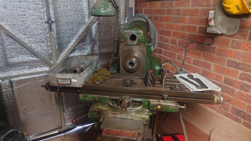

                          Mill is a Victoria/Elliott U2 – 4HP.
                          A recent acquisition, a tool/project combo. She has been sat a while and needs a good overhaul to recommission to a fully serviceable condition. She runs nice and quietly in all gears and 2 out of 3 power feeds are functioning as they should. When I tested her at the sellers property it took a bit of tinkering to free off some of the feed controls and I'm hoping that once the feed control gearbox comes apart, the issue will be rectifiable.
                          Initial cleanup underway to see whats under the grime, initial inspections are encouraging.

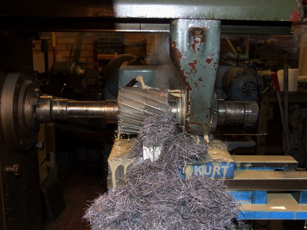

                              That's a good solid mill, will have no problem driving slab mills. Universal as well, which is a nice feature to have, especially if you want to make helical gears.
                              Like Nigel I have a Clarkson T&C grinder with the accessories to sharpen slab mills and S&F cutters. Thus far I've never needed to use it, but the facility is there when I do.
                              With a horizantal mill you really need to understand the cutting forces and clamp the work accordingly. Slab mills and S&F cutters want to lift the work, especially with deeper cuts. I learnt the hard way that the laissez aller clamping methods I could get away with on the Bridgeport are nowhere near adequate for the horizontal mill.

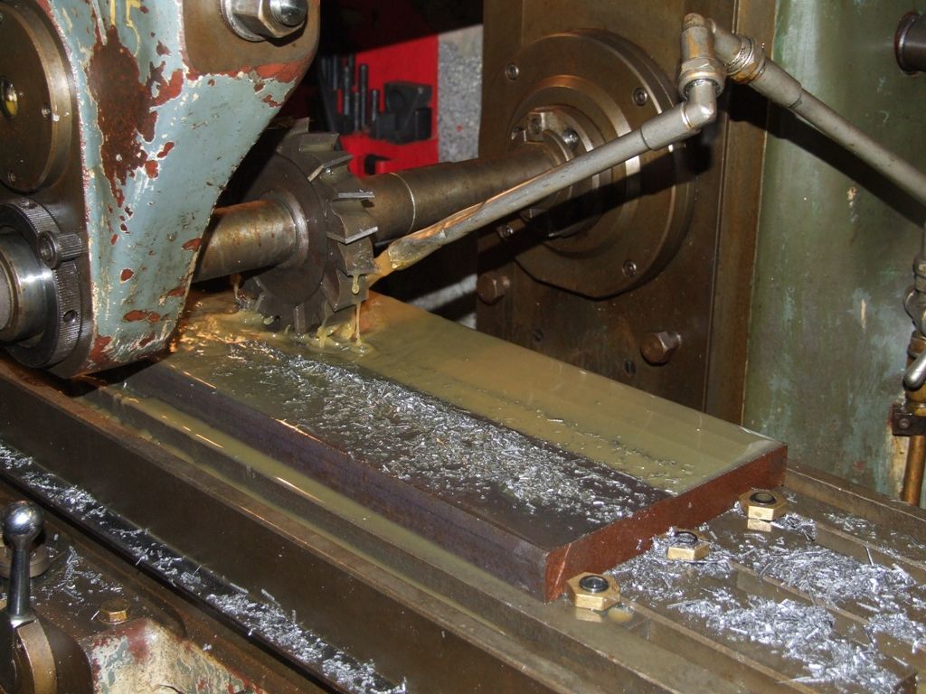

                                      To an extent, but not always needed. In the picture in my last post the slab mill is cutting two steel blocks, total width of cut is 1.5". The depth of cut was 2.5mm. I tried a DOC of 5mm, but on the initial cut the work was lifted from the vice as there was significantly more upwards force than with a 2.5mm DOC. On the other hand in this picture there is nothing clamping the steel block down to the table:
                                      There is a steel block clamped to the table out of sight on the left to react the horizontal cutting forces. The workpiece is held in place with the three eccentric hexagon clamps on the right. The DOC is shallow, just enough to remove the hot rolled scale. It's all about understanding the magnitude and direction of the cutting forces.

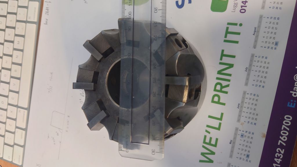

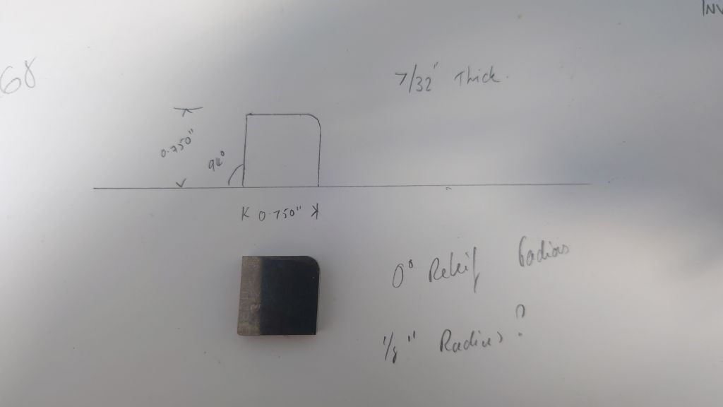

                                        And if anyone can help identify these inserts and where I might get some more I would be grateful!…

                                          They look very similar to the inserts I use in a facemill here.
                                          The same SNUN 1905xx inserts should fit -the 'ordinary' ones have a similar corner radius to yours. These, not so much…
                                          **LINK**
                                          The last time I looked, Jurassic tools had some SNUN 1905xx inserts for sale on their website (usual disclaimer, just a customer etc.)

                                            Many thanks Stueeee, that's really helpful. Jurassic tools don't have any listed currently but their site is a new one to me and looks like a good place to keep an eye on. The Ebay ones will work for me, the radius is not important as the inserts are canted over in my holder and with luck I can get 4 edges from those, if I don't drive them too deep on each pass!
