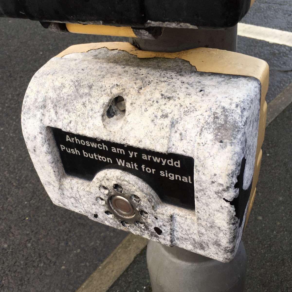

                          #781159
                            Powder Coated:
                            IMG_0564
                            Need I say more ?
                            #781165
                            Fulmen
                              @fulmen
                              I think you do. This isn’t a strong argument for anything other than the fact that powder coating isn’t magic.
                              Is your claim that no paints can produce this result? Or that all powder coats will end up like this?
                              #781177
                              noel shelley
                                @noelshelley55608
                                More a case of don’t use alloy (die cast ) in this location ? Hot dip galv or stainless for this job ? Noel.
                                #781210
                                  The point [if any] was that powder-coat is an impervious skin when first applied, and is oft-touted as the answer to a Maiden’s prayer.
                                  Once it cracks, however … moisture creeps under it by capillary action, and the rot sets in.
