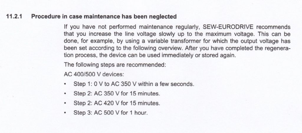

  • #345903
    Paul Fallert
      @paulfallert28101
      In an allegedly serious posting on Practical Machinist Forum, a VFD unit left unused for several years was placed into initial service by a professional electrician on behalf of an end user. The test run went well. Then, on the next run, the capacitors blew up and shredded the VFD interior destroying the VFD. Fortunately no-one was injured. The professional then consulted the VFD instruction manual and to his shock only on page 300+ it stated that if the VFD is not used for 1 year (or left on the shelf at the stockist), the capacitors must be reformed, or else!. Additional time in excess of one year required more extensive reformation of the capacitors.
      I checked Snopes.com to see if this were "fake news", with a "not found" resultant.
      Does this requirement apply to all brands of VFD? The poster said that those who restore ancient radio sets are well-aware of the need to reform their capacitors or they will blow up the entire power supply.
      I was aware that VFD's do not like to be unplugged at the supply end, but rather are to be turned off at the control panel.
      Does this reformation admonition also apply to the newish brushless PWM DC motor supply units which contain large power supply capacitors?

                Mike Poole
                  @mikepoole82104
                  Here is the procedure for an SEW Eurodrive inverter that has not been powered for over 2 years
                  Mike

                            Robbo
                              @robbo
                              Standard practice for Siemens Micromaster VFDs was to reform the capacitors if they had not been used for specified periods, using a Variac.
                              The time taken at each step varied with the out of use time, if 1 year or less then no reforming, if 1 – 2 years then full power applied for 1 hour before use, 2 – 3 years then the Variac is used to apply : 25% for 30 mins, 50% for 30 mins, 75% for 30 mins, 100% for 30 mins. Total time 2 hours
                              If 3 years or more then the Variac is used for the same percentage times, but the intervals are 2 hours. Total time 8 hours.
                              This advice was contained early on in the user manual, under "Electrical Installation"
                              This doesn't apply to 400 volt Static Phase Converters, (Transwave type) which use a different capacitor.
