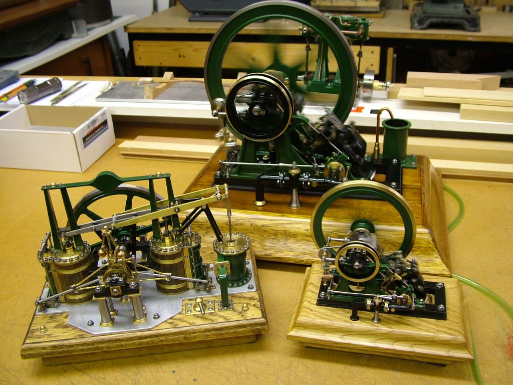

      Hi all, newbie question here. I like the Julius de Waal drawings, which are all over the internet, but they are usually way too big for me. I shudder to think how big a boiler would be required to run a twin at, say 50mm bore by 80mm stroke. My question is this. Can I simply divide all the given dimensions by, say, 50%, (or 75% or whatever) and still end up with a working model?
      All advice gratefully received! Cheers, Tony

          Funny enough Julius tends to do just the opposite as most of his drawings are enlarged versions of an original design. If you look along the bottom of most drawings you will see the source and can look that up to see what the original size was.
          Within reason most parts will be OK just being halved etc though you will have to watch that some parts don't get too flimsy or make the call up/down to suit nominal sizes,
          Also be aware that he has not built any of these engines so there are the odd errors, fits that are questionable or parts that just can't be assembled from time to time

            Just bear in mind also Tony, that if you reduce dimensions by say 50% you quarter the volume of the part.
            I have recently done this to another design by scaling to 5/8 of original size. All dimensions simply multiplied by .625.
            Doing that will not change the design providing you don't begin to round up or down the dimensions to any great extent as doing so will soon have an accumulative effect.
            It does mean having to work to some unusual dimensions at times.
            Good Luck – Tug

                        There's nothing 'wrong' with Julius's drawings as far as a model project is concerned. As Jason says they are unproved but the information is there to enable a build. Mistakes happen on all drawings to the most part certainly a rare occurance not to have any. For my own part I do not round up or down save the third digit and never rely on stock size material to fit – everything done to dimension. That's a choice we all have.
                        One of the issues facing the scaled down model is fastenings but that's not insurmountable – my good friend Chris Collison has scaled down to half size many of the Anthony Mount designs and others – here is the half size Mc'Onie running in front of the original on my workbench. The other is a halfscale Galloways Non Dead Centre engine from the same source. He has recently finished a Stuart Twin Victoria to bring to well over twenty his 'halfers'
                        I believe he told me his smallest fastening is 12 BA and he works the other fastenings in relationship.
                        As far as I am aware they are direct halfscale dimensions with no compromises save air/steam passages which are enlarged if the part allows for better air flow – though they run faster than their original none have suffered any flywheel issues
                        Proof indeed that this is a viable concept Tony so don't be put off your aim – you will have a lot of calculations to do (see another thread smiley) but your thoughts and intention are definitely feasible
                        As before Good Luck yes
                        Regards – Tug

                          Well plenty of models have been built from his drawings and although a little crowded for my taste the isometric views and assembly drawings are a big step up from the usual model engineering drawings. Particularly for the beginner who may have difficulty visualising a part from traditional plans & elevations and/or not have much idea of how all the parts fit together.
                          I have scaled down and up quite a few engines both steam and IC and never had a problem with the flywheels having to be scaled differently, what is the reason that it won't work?
                          Another batch of scaled down engines by the late Tony Boxall, mostly Anthony mount designs again every part scale by the same amount
