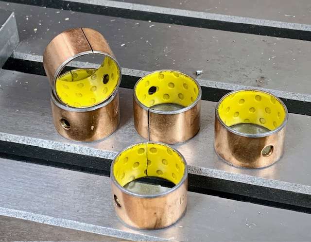

      All, I need to replace the bushes in my electric gate openers. The originals have been in place for about 15 years, and are completely worn out. The latest version of the openers don’t use bushes any more, so I can’t get them from the manufacturer. The only ones I could source are 15mm deep, but the plate they will be fitted to is only 10 mm thick. They are for a 20 mm diameter spigot:
      IMG_5171
      What is the best way to remove the excess 5 mm height?
      I thought of clamping them around a 20 mm diameter bar with a small Jubilee clip, and then turning them to length in the lathe.
      Thanks.

        Light cuts, looks good from here.

            If you already have the new bushes, then fit them on the 20mm bar and simply clamp them in the lathe chuck with 6 or 7 mm sticking out. Turn off the 5mm in several passes, no jubilee clips required. BearingBoys are a very good source of anything to do with bearings, I can recommend them.

              For the life of me I couldn’t find any 10mm deep ones. I got these from Simply Bearings. I suspeced someone would immediately find the right ones, but no big deal.
              I dare say the holes in the 10mm actuator plates will be oversized by the time I’ve got rid of the corrosion, and the spigots will be worn too, so I might end up making my own anyway. Plan is to Loctite them into place and hope for the best. Thought I’d at least try to buy some and try them under the assumption that they will be better than what they are now (badly deformed and a rattle fit).
              If they last another 15 years, by that time I’ll be beyond caring anyway!
