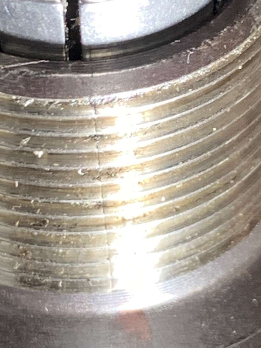

      I have a Nikken NX-5 spindle speeder that I picked up very cheaply on account of the owner crash-driving the collet with cutter so hard into the spindle nose taper that he could not get it out and the wedging created a hairline crack down one side of the spindle nose thread. I have managed to remove the collet and everything seems to work surprisingly well, but obviously I want to keep the crack closed when tightening the collet nut and to this end I am thinking nickel electroplating the nut thread to make it a tighter fit onto the nose makes sense. I think I have read here that some firm(s) do a nickel electroplating job to a user specified thickness in microns. Is this so, and any recommended places to get it done? My other question is how to calculate the absolute minimum play twixt nut thread and nose thread to avoid binding? The thread is M20 x 1.0mm pitch. Any advice much appreciated.
      #749083
      Adam Harris
        @adamharris13683
        How long should nickel electroplating by a few microns an M20 x 1.0 nut take? If a matter of minutes/hours, perhaps best would be to visit the shop and specify a number of microns and repeat according to trial and error until fit just tight enough ?

                              Thanks everyone. The crack is hairline albeit all the way through and stops short of the base of the threaded part. I think turning it down in a lathe for a sleeve is not viable for 2 reasons – 1) whether in lathe or on mill, the action of a cutter might well exacerbate/extend the crack catching on it at each revolution and two 2) I am loathe to attempt to disassemble the head to extract the spindle for working on, especially when Nikken say it must be returned to their facilities for any disassembly, and without removing the spindle there is great difficulty in holding the nose as the body is vast and the opposing flats at the base of the nose very narrow. It would have to be a milling job with a complicated set up.

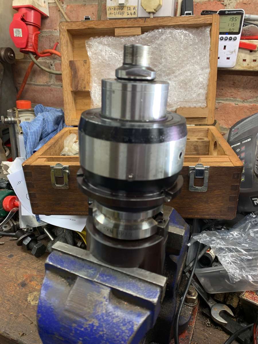

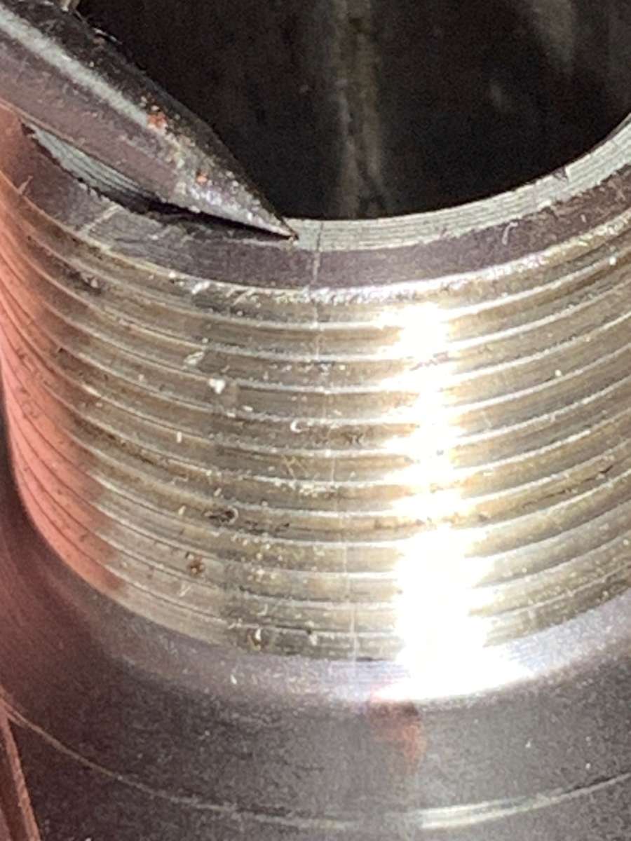

                                  IMG_6229IMG_6228IMG_6230

                                    You can see in the 3rd photo how the crack opens when a collet is pushed in. Not easy to know how much more/less it opens with the nut tightened up hard on the collet as obviously cannot view crack when under the nut. You can see in the 2nd photo the width of the head’s body compared with the 2 little flats to hold the spindle (18mm long and 5mm high at the highest point). Excuse the horrible clutter on the bench!
                                    #749191
                                    Adam Harris
                                      @adamharris13683
                                      I could press a very short but fat sleeve (ring) onto the base of the threaded nose where there are a couple of surplus threads in order to prevent the crack extending. I could bore out a bit of the nut to enable that sleeve to be a bit longer but then I am reducing the nut’s own ability to counteract the widening of the crack…
                                      #749198
                                      Adam Harris
                                        @adamharris13683
                                        The body of the nose is quite a lot thicker at the bottom of the threaded part (tapered socket for SK10 collets) than the top so it is rather worrying that the crack does go all the way to the bottom of the threaded part, albeit it does not appear to go any further than that.
                                        #749203
                                        Adam Harris
                                          @adamharris13683
                                          By the way, a new threaded spindle from Nikken is £678 and they imagine it may need other parts, thus totalling £1169 excluding labour so a bodge followed by very tender use is what I am looking for! A new NX5 is just shy of £4000

                                            This may be bonkers, but:
                                            I would consider making a solid ‘blank collet’ to fill the hole … then smear it with an anaerobic retainer and set it in place using the existing  [well-greased] nut.
                                            Then remove the nut, and machine the blank, in situ, to take a ‘next size down’ collet.
                                            [ if you see what I mean ]
                                            #749221
                                            simondavies3
                                              @simondavies3
                                              Have you considered tightening a collet to open the crack, apply one of the mega-strength Loctites (or whichever brand you prefer) like 601 or 648 ( exact to be proposed by more expert than me, then swiftly remove collet to allow crack to minimise and the Loctite to (hopefully) permanently re-join the crack.
                                              #749224
                                              Adam Harris
                                                @adamharris13683
                                                Might be a good idea Michael – they do an SK6 collet which takes up to 6mm cutter which would be good enough for me. I could make an SK6 taper sleeve (same taper externally and internally) and glue it into the SK10 sleeve somehow. Then put some weld onto the nut nose and bore it out for the SK6 collets. What glue/anaerobic retainer would you recomend? I could hold the crack tight closed while gluing with an appropriate jubilee clip. Do you think the wall of the SK6 sleeve would be thick enough for purpose?
                                                #749228
                                                Zan
                                                  @zan
                                                  If the crack opens when the collet is pushed in this could be worth a try it’s non destructive and relatively simple non destructive and no heat
                                                  1 machine a dummy collet
                                                  2 put a flat on the taper
                                                  3 clamp in situ to open the crack
                                                  4 dribble Locktite on crack and it may wick into the crack
                                                  Edit…….opps already mentioned above. didn’t see it!
                                                  #749232
                                                  Adam Harris
                                                    @adamharris13683
                                                    Do you think Loctite could really stop the crack opening when torquing down the nut on the collet?
