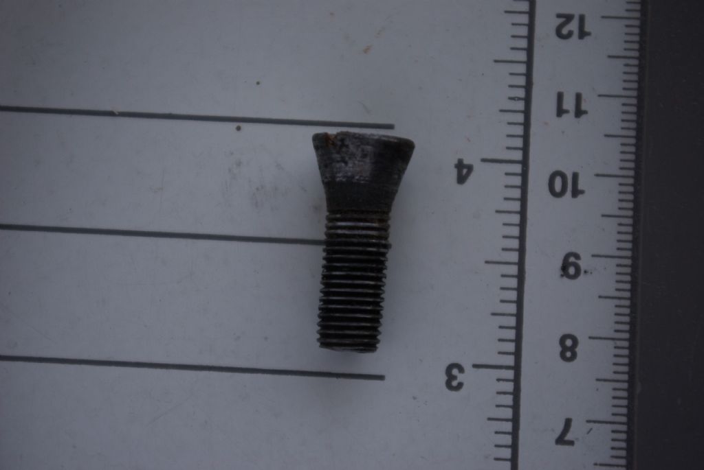

              It might be worth noting that the screws (at least those in my Record vice) are not the usual 90 or 120 degree countersunk screws but have an included angle nearer to 60/75 degrees.
              So if you destroy the originals you might just find it difficult to get replacements.

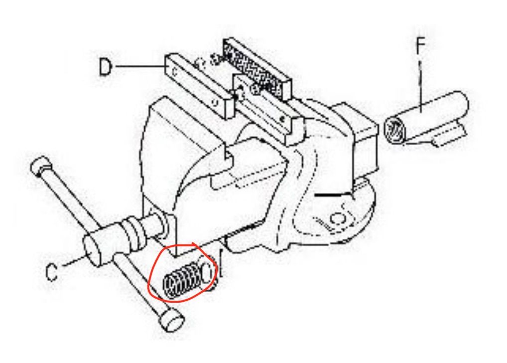

                Another question: what spec is the helical spring (circled)? The previous owner had abused the cross pin that holds the spring, and in the process mangled up the spring rendering it useless. It needs replacement.
                #460034
                Kiwi Bloke
                  @kiwibloke62605
                  Sorry, I haven't got a No.1, but in smaller and larger Record vices, the spring is an entirely non-critical, ultra-crude anti-backlash component. Anything that can be made to fit should be OK, or you could even fit a tube. A spring is, however, preferable because it will take some of the rattle out of the vice.

                        I've removed one of my screws (I liberally coated them with copper grease when I rebuilt my vice) and would report that the screws are 1" long x 5/16" with a thread of 26tpi. The included angle is 60degrees – so a "Record Special"

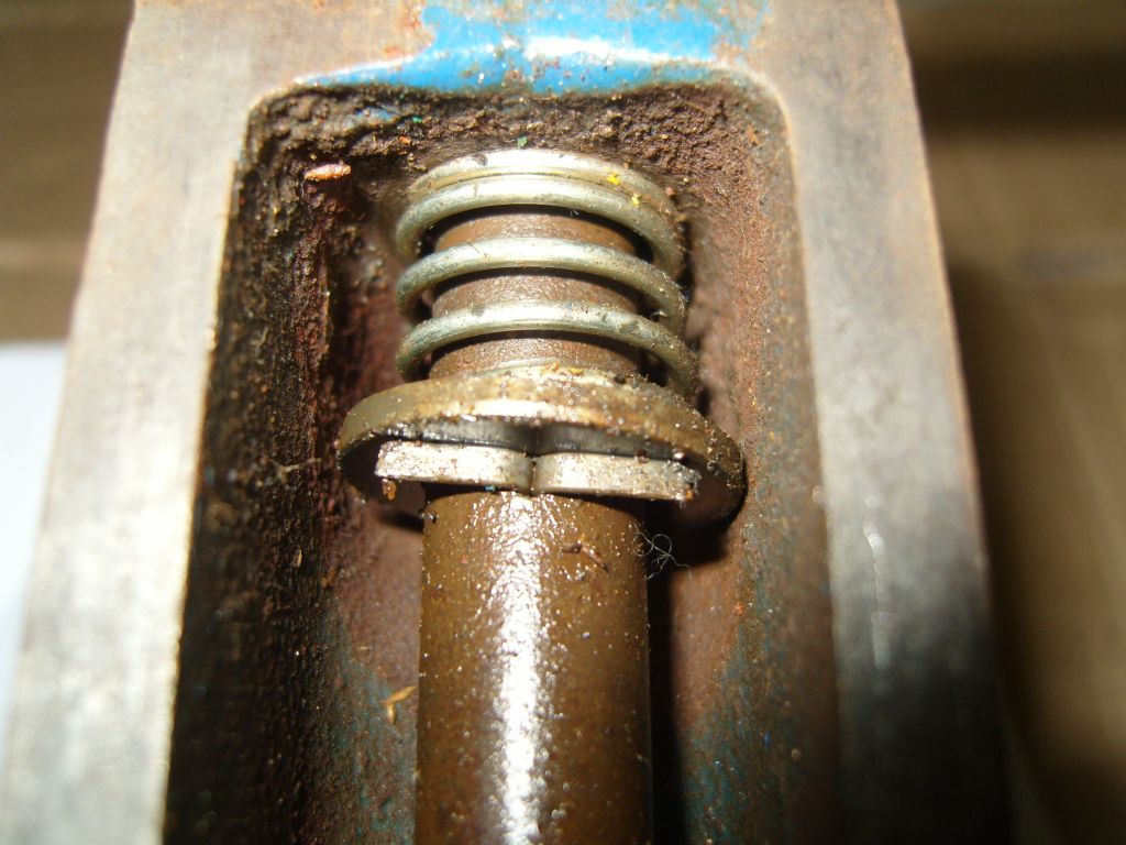

                          Hi choochoo_baloo, a photo below of my No.1 spring, can't tell you the free length of it, but I had a look at it today as it is not fixed to anything at the moment. It has five turns inclusive of the ends and the wire is about 1.5mm diameter.
                          Hope this helps.
