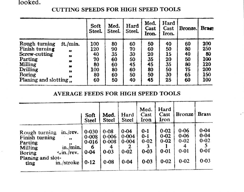

            #463494
            mechman48
              @mechman48
              A couple of pics for you to print off & keep for ref… ref.Mechanical World Year Book 1975/76
              George.

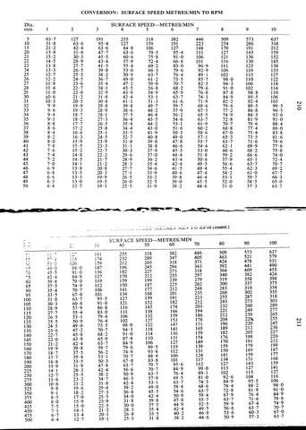

                #463498
                mechman48
                  @mechman48
                  Chris… another ref chart for you … ref Model Engineer's Handbook by Tubal Cain 2nd edtion.
                  George.

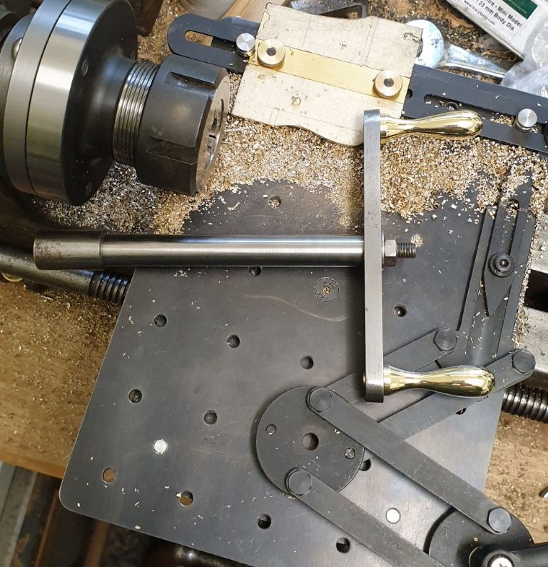

                                    #465679
                                    Chris V
                                      @chrisv
                                      Good morning, Just an update after all the helpful tips earlier about lathe speed/finish on my brass turnings with the Turnado. Speed has remained the same (waiting on a new belt) but larger radius tools sorted my issue out.
                                      I finished the batch of cone finial turnings and just made the pair of handles shown below for my tapping tool.
                                      I was very surprised though that the finish on leaded steel was much better off the tool than on brass.
                                      I think an Acorn nut is next, baby steps!
                                      Thanks once again and stay safe.
                                      Chris.
