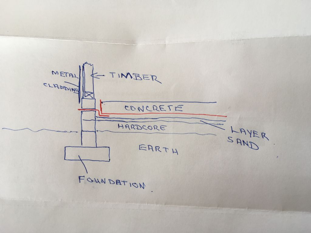

                              RMA & John P have pretty much said everything — I'm not a builder but have done fair bit of DIY so my thoughts are as per sketch below added to the comments above relating to wood [sleepers] for what you are doing these are definite no! Use bricks or blocks, blocks are quicker but bricks are stronger — your choice ?
                              One thing in particular is a layer of sand over the compacted hardcore is a must to protect the DP membrane from the hardcore
                              One error on the sketch — let the metal cladding go BELOW the DPC in the brickwork by say 2" [50mm] or a brick !

                                Just to add a tip you might not be aware of. The above diagram is fine and I agree with bringing the cladding down to below DPC. The hardcore needs to be good stuff, Ideally small chunks that fit together well. I have a wacker to compact this sort of thing, if you can get your hands on one it will make life easier. However I've found small hardcore will settle quite well by moving it around as you put it in. Whatever you have it needs to be compact.
                                Sand (or blinding as it's called) needs to fill all the gaps in the hardcore, it's no good just laying it on the top. Obviously the wacker can be used for this operation, but if you can't get one, a little tip is to wash the sand into the hardcore using a hosepipe. When you're happy with that, leave at least an inch on top for the membrane to lay on. Try and get the membrane over the wall and lay the DPC on top of that, bedding it in with some mortar. and then build on top until you have the right thickness for your concrete floor.
