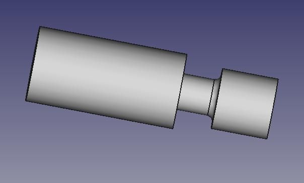

                                Try doing a 'spark test' on the old rod.
                                en.wikipedia.org/wiki/Spark_testing
                                This might help determine what the original problem was.
                                #564192
                                  Posted by Robert Smith 24 on 25/09/2021 08:13:08:
                                  The pin was hard and fractured at the shoulder of the 2BA thread and 1/4" pin.
                                  Sounds like a classic fatigue crack caused by shoulder acting as a stress raiser. Best to avoid sharp transitions especially where heat-treatment is applied too: on purpose or accidental tempering is liable to cause micro-fractures, and these are particularly likely to occur at sharp transitions. Parts become much weaker than they should and are very liable to fail when stressed repeatedly.
                                  In this example one side of the groove is chamfered to relieve stress leaving the other side seriously weaker.
                                  So manufacturing defect(s) rather than using the wrong steel.

                                      The sharp transition from minor to major diameter of the pin will be addressed when I machine up a new one.

                                        Went through a Q & A scenario a few years ago when a mate had managed to wrangle the con rod between boiler feed pump rod and eccentric drive on a Simplex. Hydraulic lock etc. and all points east (and west). Transpired that looking vertically downwards on drive everything in line BUT, horizontally, the pump rod and eccentric centre lines weren't. Worth checking.
                                        Regards Ian.

                                            Following from the above, as I need to replace the pin which articulates the eccentric rod with the pump piston, I am considering replacing it with a case hardened mild steel version. The original was hardened and tempered silver steel and that of course broke.
                                            I am doubtful that I could hold a precise tempering temperature long enough to achieve the correct temper all through. Could I please solicit opinions as to whether case hardened mild steel is suitable?

                                                    From the comfort of my armchair, I think Silver Steel was the right choice. Some yield strengths from the Model Engineer's Handbook:
                                                    • Aluminium, 5 tons per square inch
                                                    • 60:40 Brass, 8 tons per square inch
                                                    • Malleable Iron, 8 to 10 tons per square inch
                                                    • Dural, 15 to 19 tons per square inch
                                                    • Free Cutting Mild Steel, 20 tons per square inch
                                                    • Mild Steel, 24 tons per square inch
                                                    • Stainless Steel, 36 tons per square inch
                                                    • High Tensile Steel, 40 tons per square inch
                                                    • Silver Steel, 35 to 50 tons per square inch
                                                    Bearing pins are worth hardening if they are subject to high wear AND are difficult to replace.
                                                    Unhardened Silver Steel is stronger than most common metals and could be used as a pin without heat treating it. Not the best possible, but pretty good compared with common alternatives.
                                                    The performance of Silver Steel can be improved by heat treating it, and this is probably where Robert's pin went wrong. Working with small parts and a blowlamp, it's quite easy to botch the heat-treatment. For best results it's necessary to heat the part to the correct temperature, (cherry red in dim light whatever that is), hold that temperature steady for a time related to the weight of the part, quench the part without allowing the it to cool en-route, and then remove the part at about 200°C and put it straight into a pre-heated oven to slowly anneal it.
                                                    Plenty of opportunities to get it wrong:
                                                    • Steel not hot enough or too hot for the incorrect time. (Too long or too short)
                                                    • Steel cools on the way to the quench
                                                    • Insufficient quench liquid (bucket rather than cupful)
                                                    • Failing to stir the part if the coolant is water
                                                    • Cooling too quickly in the quench causes Silver Steel to become brittle and – in the worst case – to crack. Problem here is microcracks, invisible to the eye, which severely weaken the part, especially if it's repeatedly stressed as a pump pin would be.
                                                    My inexpert experience of silver steel suggests it's fairly forgiving of mistakes. However, early on I had a high failure rate – either not hard, or super-brittle. Better now. I think the main difference is not flapping about, instead: smoothly heating up to about the right temperature, holding it roughly for the right length of time, not too hot, and then putting the part straight into the quench and stirring vigorously.
                                                    How the part is held can be problematic too. Pliers act as a heat-sink, likely to make one end of a short pin much cooler than the other on the way to the quench. Various ways of avoiding that, for example making the pin much longer than required and grinding it to length at the un-held end.
                                                    If the part comes out very hard, it needs to be annealed. Small parts are fairly easy – they can held at 200°C for half an hour in a domestic oven. Might be necessary to get a divorce before this is allowed…
                                                    My advice, persist with Silver Steel.
