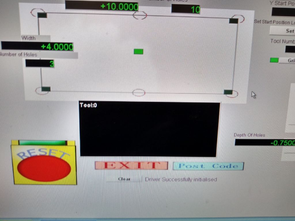

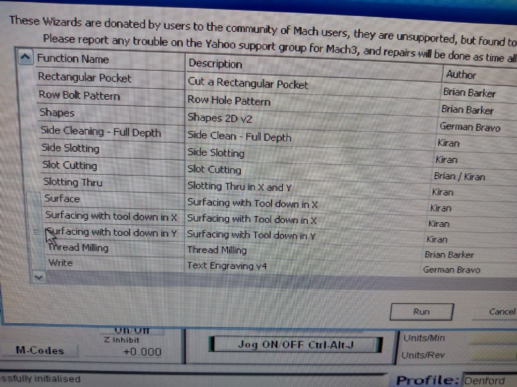

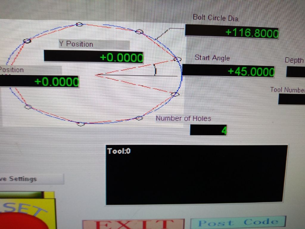

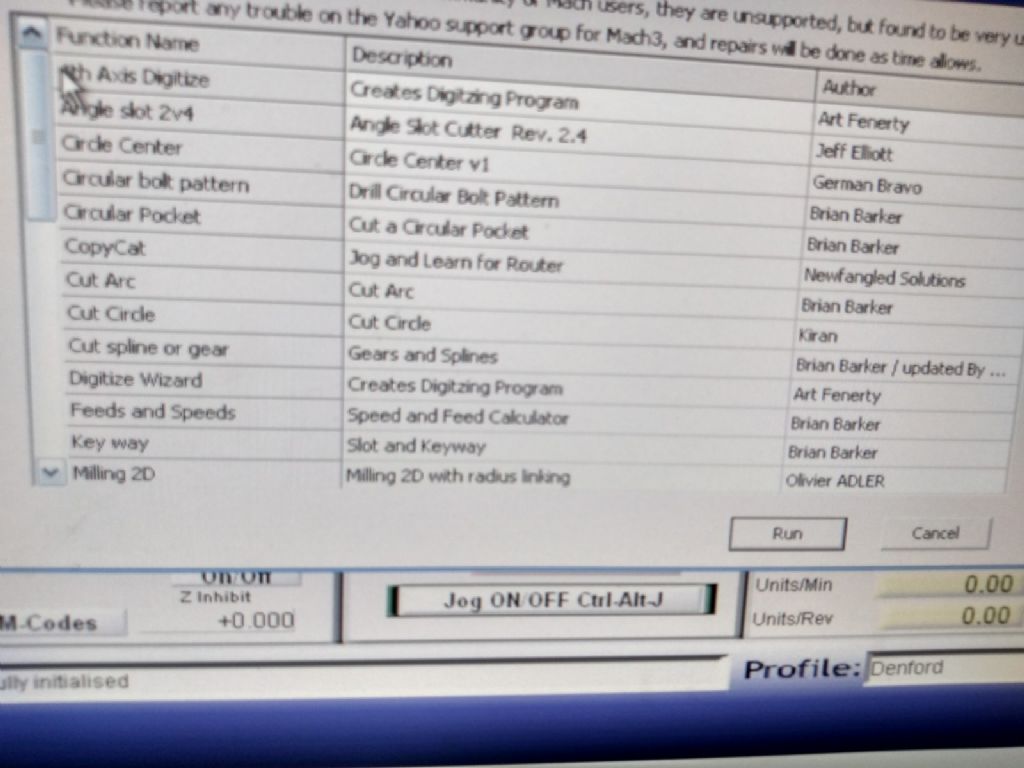

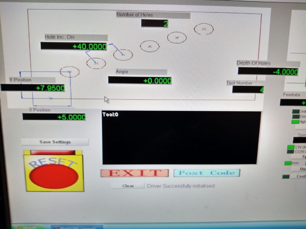

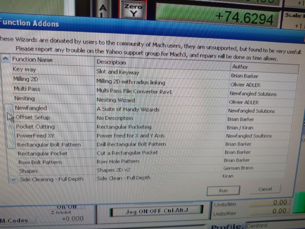

          I've taken a few screen photos of Mach3 to show the wizards. First 3 is the full list.
          Then 3 of the config forms for the bolt patterns.
          BUT – if you are just planning a mill conversion I suggest that you DON'T use Mach 3!! This is because its development stopped years ago, NFS no longer support it and bugs only get fixed by courtesy of users. The availability of surplus PCs that can drive the parallel port is drying up, and even if you use a separate motion controller that probably isn't supported in M3 if it (the controller) gets updated, and there's a stream of issues with Windows releases that create new incompatibilities.
          If you stick with Mach, go to Mach 4, you will then really need a separate motion controller. I'm not familiar with M4 but I'm sure it has a similar range of wizards. Or there are a number of other systems out there.
