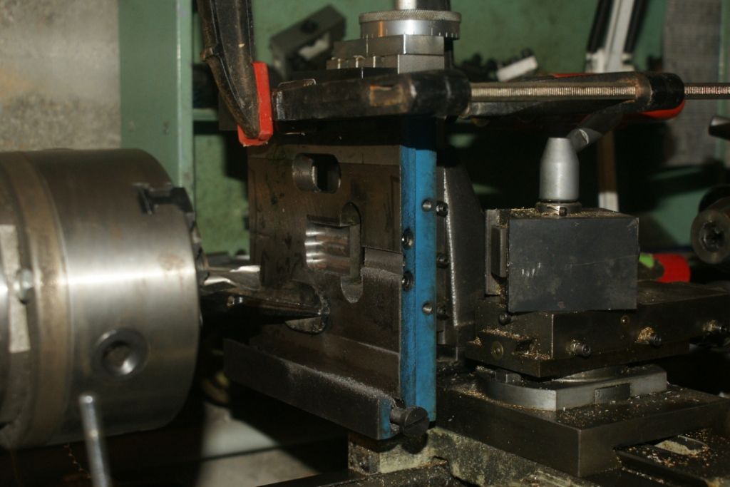

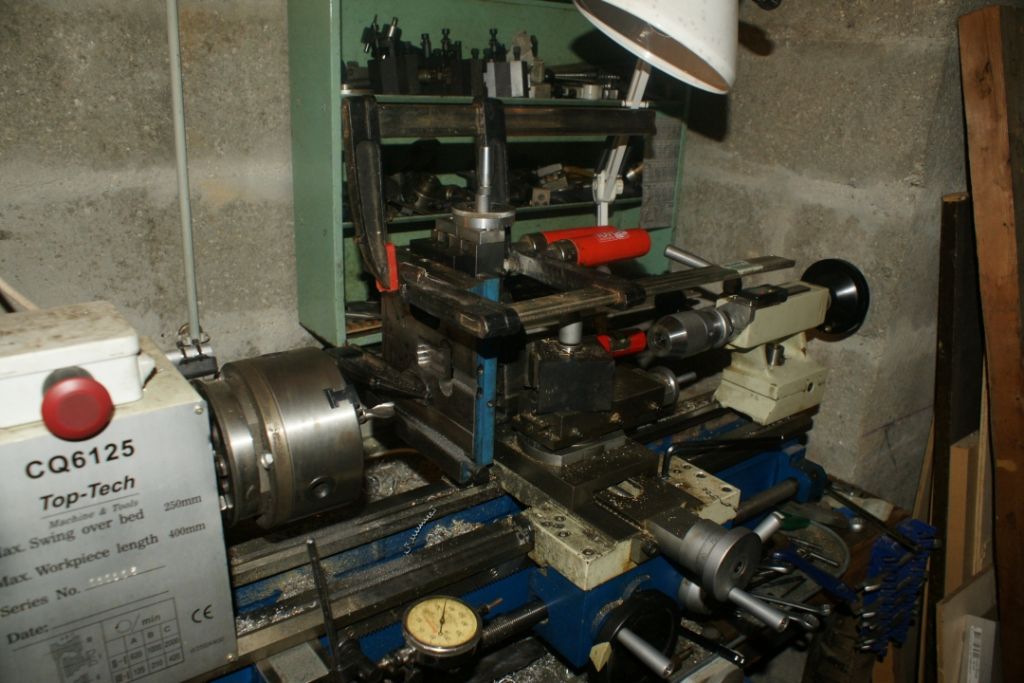

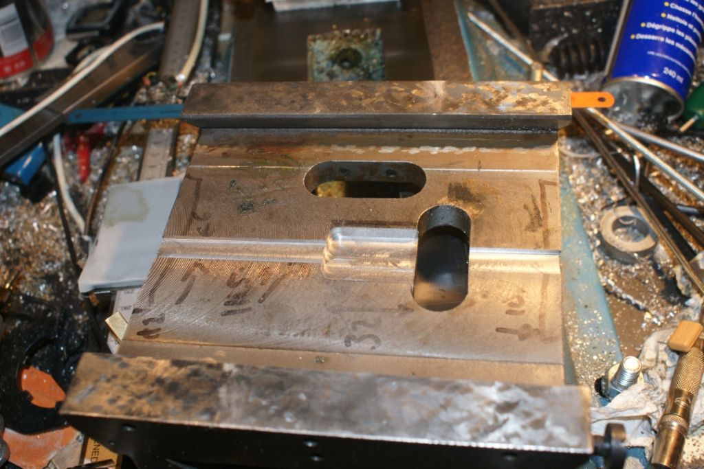

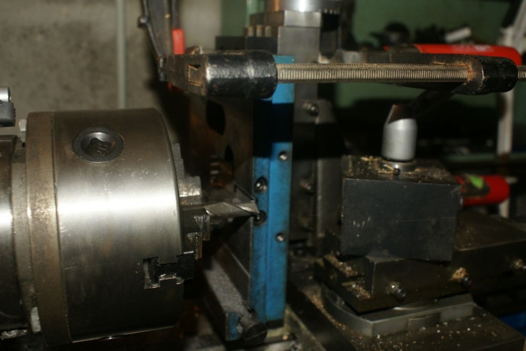

                                                This is how I did it 10 years ago – from (distant) memory, the big clamps were not the only means of holding the mill table to the lathe's vertical slide
                                                BR
                                                Simon
                                                and the result looks like this:
