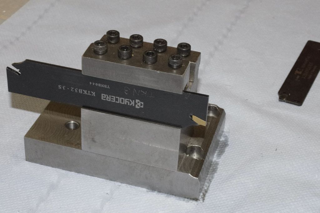

                          With apologies for being flippant I wrote this some time ago
                          Alan
                          Vertical Parting Tool
                          A while ago I tried out a vertical parting tool it worked ok but I must admit I did not give it exhaustive testing to destruction etc.
                          In order to clarify the operation of a vertical parting tool here is my rather primitive description of how I think it works.
                          Imagine that you are the parting tool holder whereby your two hands are held straight out from you body. You hands are gripped together and your fists are the cutting edge. You have a friend who represents the metal being cut and he (If you are a front parting tool) pushes down on your hands while you do you best to resist him pushing down. You can see that he can quite easily push your arms down. If you want to now become a rear parting tool you can turn round 180 degrees and your friend would now push your hands upwards still he can easily overcome your resistance to him pushing up. So in order to stiffen you up, say you are frozen solid or have rigor mortise and are wearing a large pair of lead diving boots to anchor you down. When your friend (or should I now say de-parting undertaker) pushes down on you hands he will not be able to move your arms down because they are rigidly fixed to your body and he have to apply more force until you tip forward on you toes. Note that as you tip forward you rotate about your toes moving your cutting tool hands deeper into the metal being cut. If you are now rotated 180 degrees to become a rear parting tool your friend (some friend) now has to apply more upward force until you tip backwards on your heels. Also note that your cutting tool hands now move away from the metal being cut as you rotate backwards on your heels. Now you have to play the part of a vertical parting tool as I am proposing, so you now can be thawed out or de- rigor mortised. So lay flat on your back and push one arm vertically upwards and clench your fist to form the cutting tool. Your friend now has to apply considerably more force to overcome your vertical arm. Your arm will be in direct compression and until your elbow or wrist give way you will have much less a problem resisting his downward cutting force. It will also not matter if you are a front or rear vertical parting tool as long as the rotating force is pushing down on your hands. You can now get up and go back to your work or whatever you were doing. I apologise for being so flippant but I hope it does explain the reasoning.
                          Regards
                          Alan

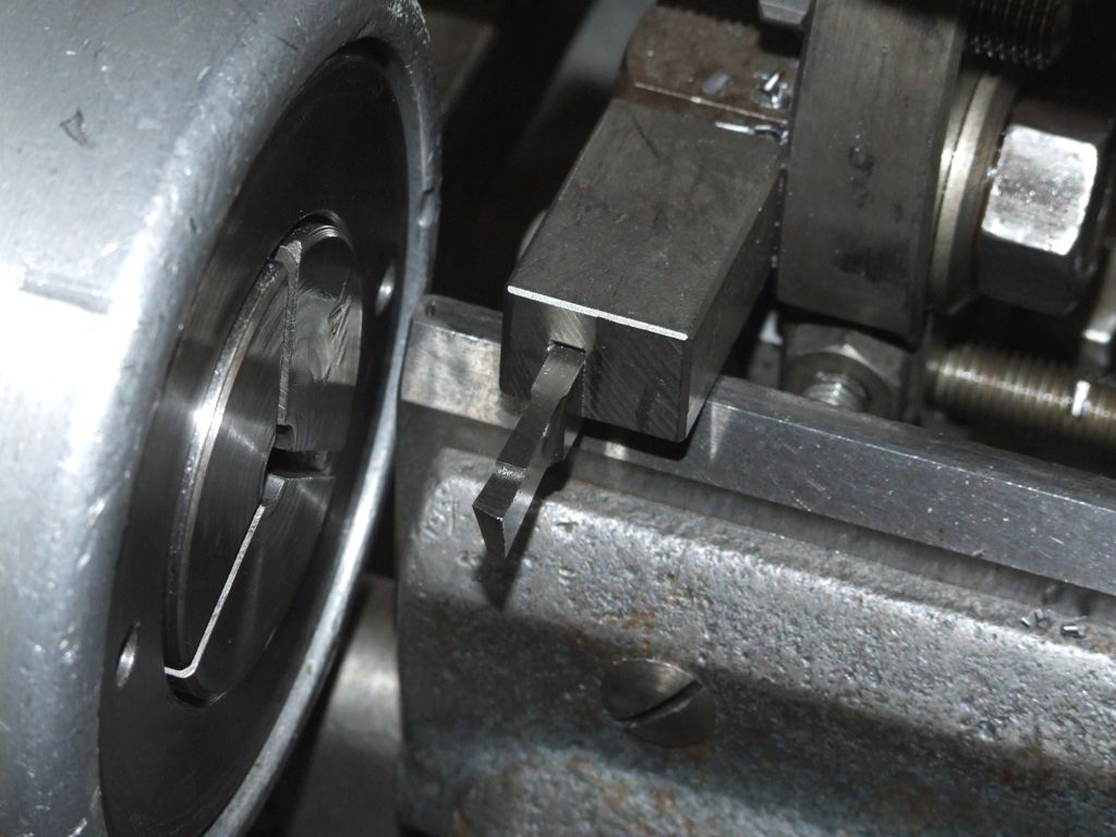

                              Some of the photos posted seem to show the parting off tool mounted in the rear post with the cutting face upwards. In other words to part off the lathe would have to run backwards. I strongly believe a lathe, for any cutting, only rotates one way. I hope my observation is wrong.
                              I use a rear tool post on the Myford but have yet to do so on the little lathe. Watching the parting off bronze on the little lathe the build up of chips, trapped between the tool and the work, is alarmingly rapid. This leads me to believe a rear tool post works because it prevents this build up chips, just let gavity work.
                              JA

                                Sorry JA, clearly wrong. The lathe can be used either way if the chuck will not be unscrewed. So between centres, collets, bolted on chucks and D1 type mounted chucks can be used either way.
                                See this threading technique where the part is spun in reverse with an inverted tool to cut R/H threads with the tool moving away from the headstock.
                                Martin C

                                    Posted by JA on 23/03/2023 11:35:45:
                                    JA
                                    Nope, your observation is correct!
                                    An advantage of Far Eastern lathes is their design is more modern than classic machines. Not entirely a good thing when applied to cut costs, but a good thing in that these machines can cut forwards or backwards equally well, almost. There are a few exceptions, such as when a DC motor is low-power reverse because it has staggered brushes, but my 3-phase lathe can spin its bolt-on chuck at full power either clockwise or anti-clockwise. And the power-traverse controls work in either direction too.
                                    So I can part-off from the rear with an upside down cutter spinning anti-clockwise, or I can part-off with the cutter facing up with the chuck spinning clockwise. Gravity is alleged to  keep swarf out of the slot in the first set-up, but the saddle could lift. In the second way, spinning clockwise, the cutting forces can't lift the saddle, so the set-up is more rigid, a good thing!
                                    I don't run clockwise all that often but it has value. The only real objection I can think of is carelessly taking a conventional cut on a lathe set for clockwise running, which won't work. But I'm self-taught and my understanding is full of odd gaps and misunderstandings. Is there another reason why I shouldn't run my lathe backwards?

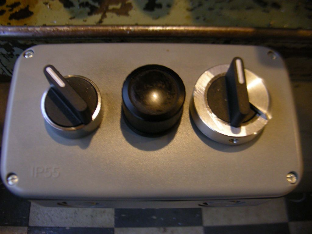

                                        Posted by SillyOldDuffer on 23/03/2023 13:07:54:
                                        conventional cut on a lathe set for clockwise running, which won't work….
                                        Unintentionally running in reverse can have damaging consequences. To guard against this when eg screwcutting away from the chuck I use a simple stop or gate on the forward reverse switch on my Willson lathe:
                                        A poor photo; the stop is the shiny thing on the right hand switch; when not in use it lives on the left hand one from where it is readily available.

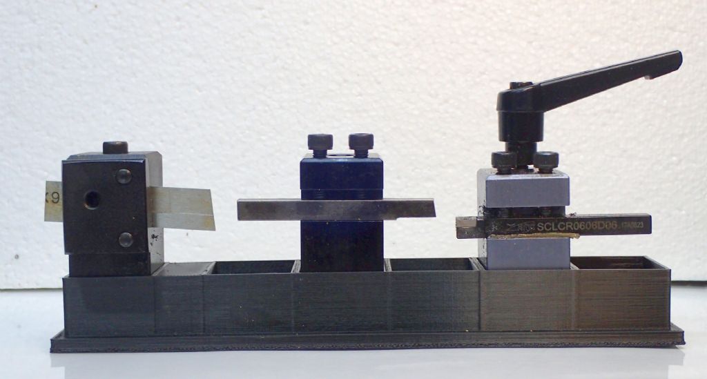

                                          To answer the original question about Taig Toolposts. The rear toolpost is different. This is a quick shot of three of mine.
                                          Centre height from the cross slide is 31mm
                                          On the right is a standard Taig Toolpost 45mm high, bottom of slot is 25mm from base. Top of 6mm Tool sits on centre height.
                                          In the centre is a Taig Rear Toolpost with the tool mounted upside down. Overall height 51mm, bottom of slot is 31mm up from base – so inverted the tool sits on centre height.
                                          On the left for completeness is a Taig rear mounting parting toolpost that uses a T shaped blade. The holder is inclined so that the blade can be set on centre height.
                                          Hope this helps
                                          The ones I use a lot get the handles as seen on the right. The less commonly used rely on the standard cap screw.
                                          Sorry – didn't see Bernard's response!
