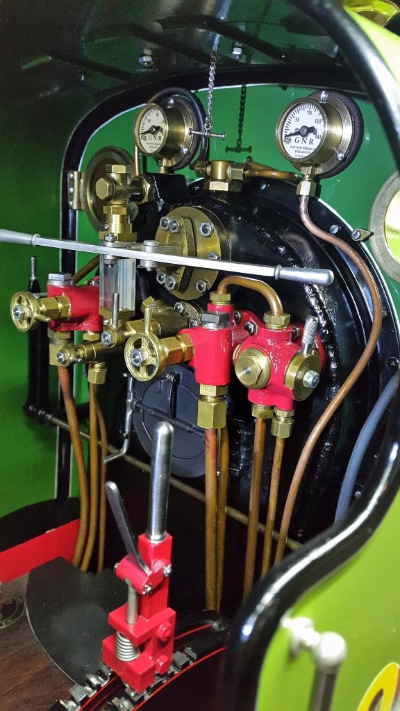

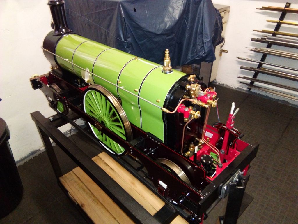

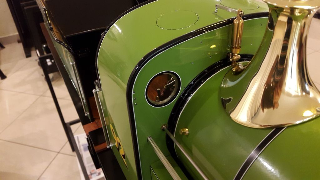

Hi Michael, as Luker has pointed out the cleading will be held near the spectacle plate by a length of right angle which has been rolled to match the boiler.
Looking at photos of No.1, Luker's excellent model looks correct, I don't have a close-up of a Stirling having not built one but can share one of my photos which shows the angle as fitted to Flying Scotsman. As you can see the angle is bolted or riveted to the spectacle plate and the cleading slides under, note that it's not fixed to the cleading so that it can expand as the boiler heats up.
Hope this helps
