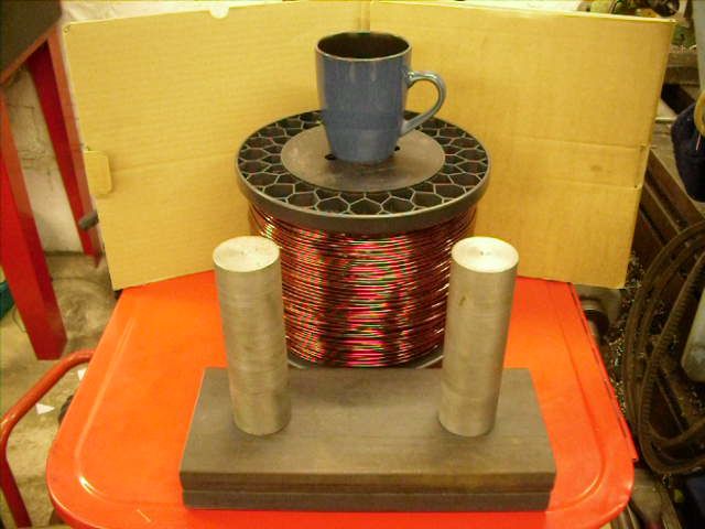

                    Well this has reminded me that I made a start on a magneto remagnetiser almost six years ago. I bought a roll of insulated copper wire and machined up a pair of mild steel cores and cut a slab of mild steel for the base, I then machined up a second set of cores of a larger diameter to those shown, but I haven't got much further with it yet.
                    Apparently soft ingot iron should ideally be used for the coil cores because of its low carbon content, so it does not retain any magnetism when power to the remagnetiser is switched off, unfortunately it is quite expensive at this size but mild steel is usable. I downloaded and printed off the instructions and have them filed away somewhere.
                    Magneto charger.
