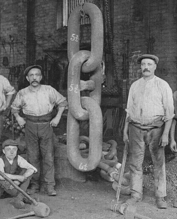

                    Hi
                    Hingley and sons
                    Surely a member can CNC rout a foam mold or copy?
                    This image defines the scale.
                    5 to 6inches thick
                    **LINK**
                    #636336
                      Posted by John McNamara on 06/03/2023 02:07:25:
                      5 to 6inches thick
                      **LINK**
                      Unfortunately, John … that link appears to be dead

                              Grindstone Cowboy
                                @grindstonecowboy
                                Edit – just realised the irony of using the word 'link' in this instance smiley
                                Possibly not working for Michael and Roy as they are not logged into Facebook? I don't know, but here's the picture from the link.
                                Rob
                                Edited By Grindstone Cowboy on 06/03/2023 09:18:39

                                        Presumably, only the middle link has a cross member because the chain is just three links long.
