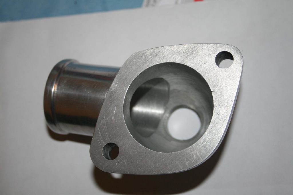

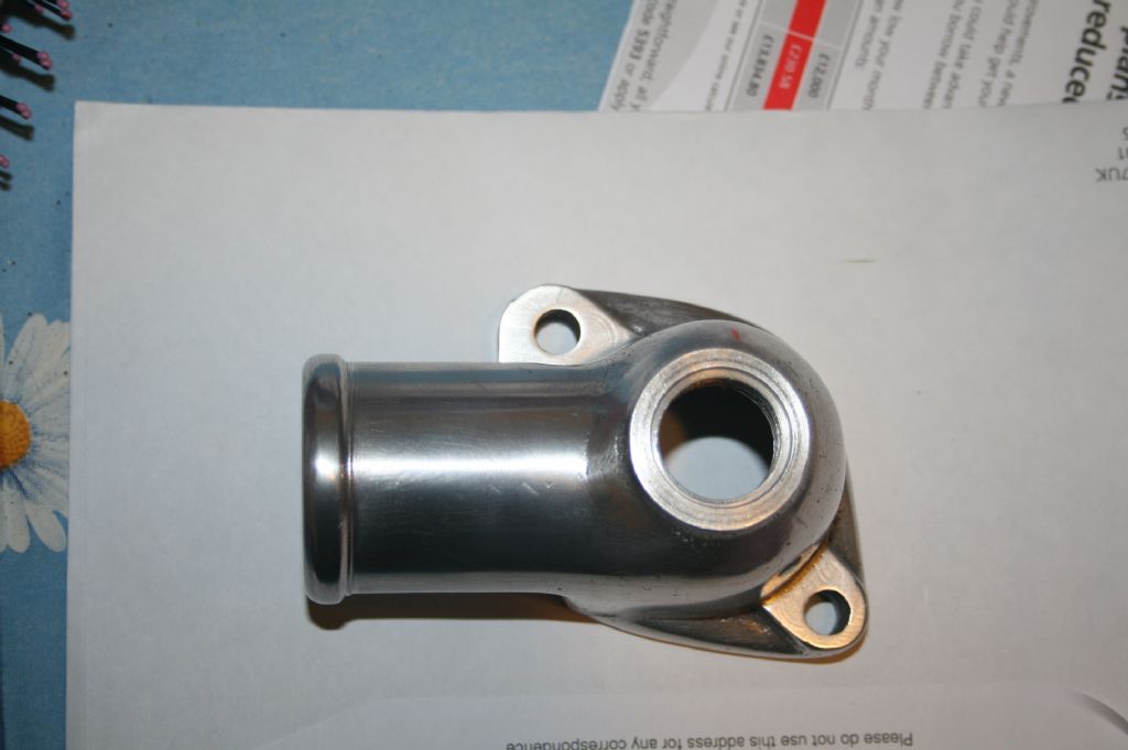

                    Some other Mk1 parts i remade ..Thermostat housings for 1600 xr2 and 1300 . Like this, but a smaller outlet elbow . Cast dozens and sold them all on ebay and the club . I made this one for an Escort 1600 Xflow with a temperature take off modified for an electric fan . Cast and machined in da forge !!  No CNC here…sad

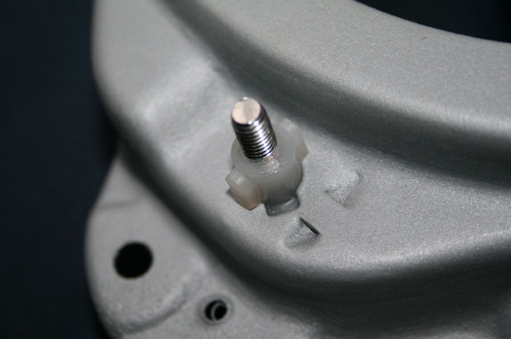

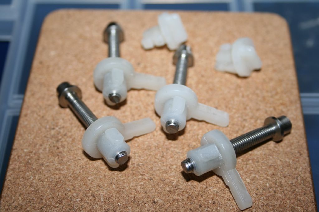

                    XR2 round headlight adjusters and clips …in HDPE . For these I bought a benchtop injection machine from a school, made the moulds and made hundreds of the pesky things !! Screws were modified stainless items . Made more money by selling the machine back to another school ..

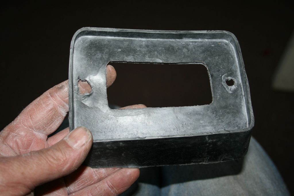

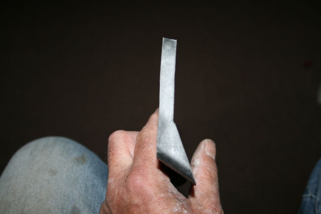

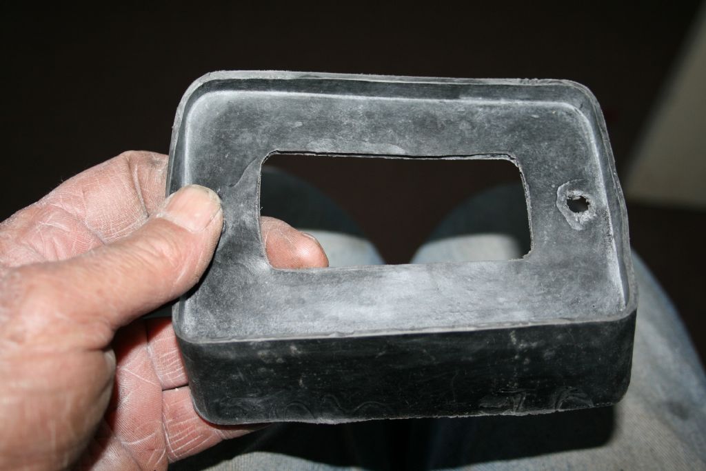

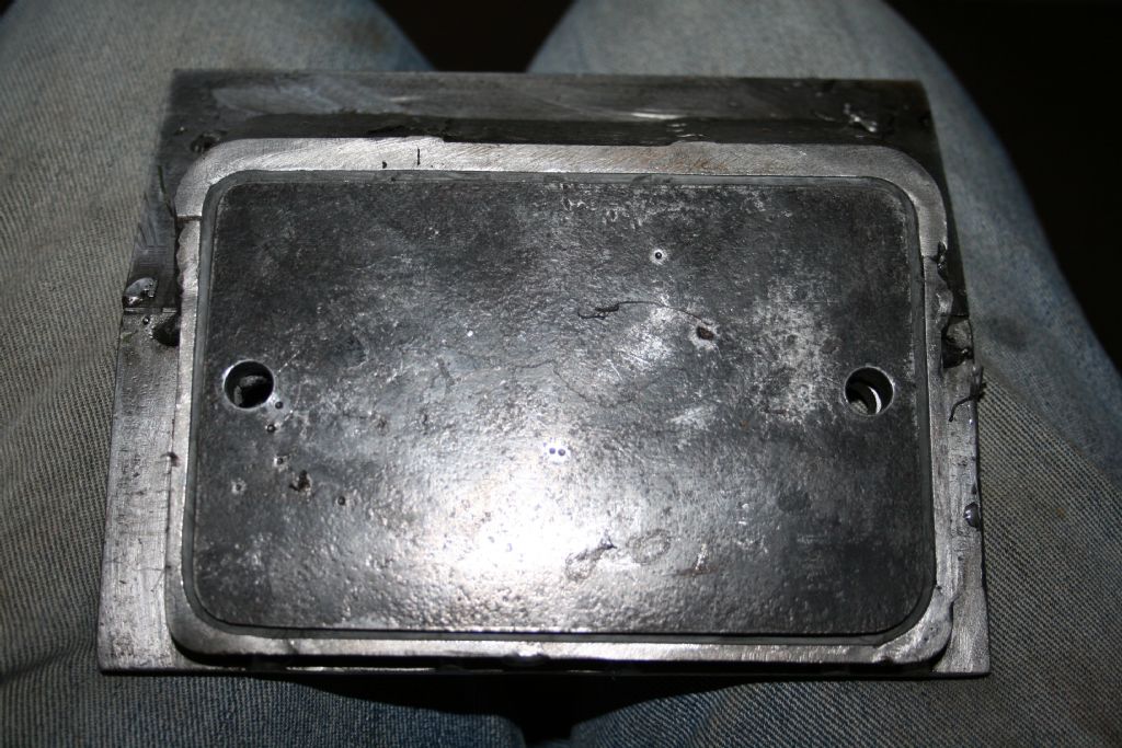

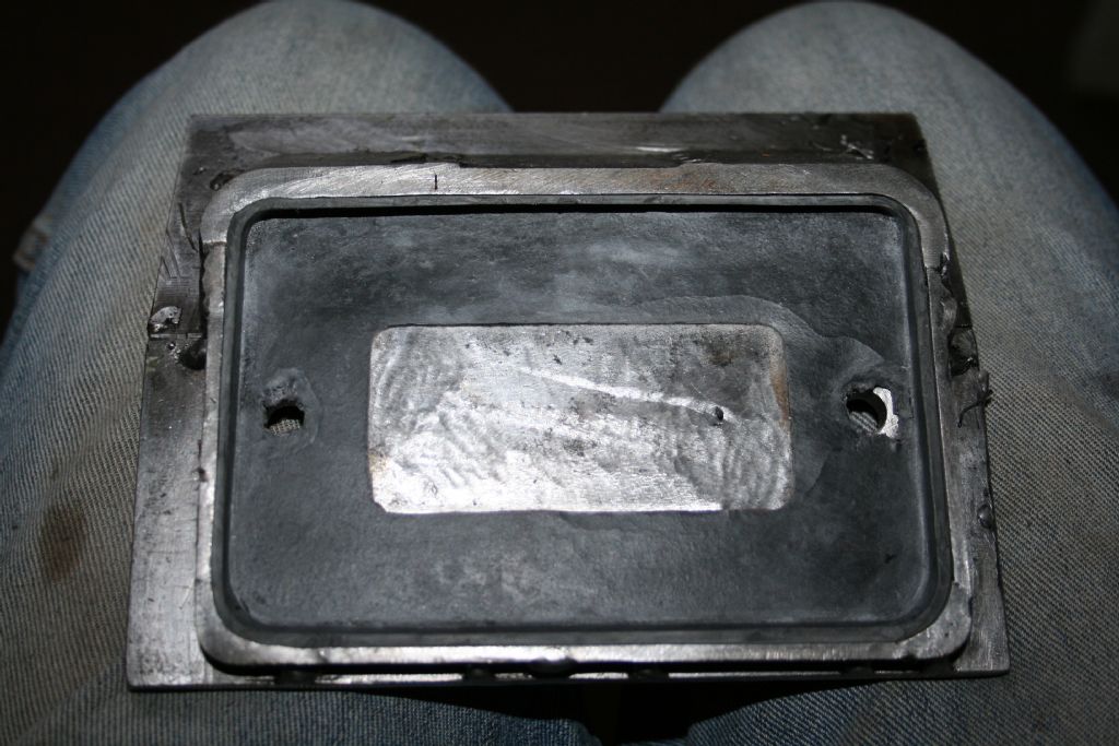

                      Did a bit of corner filling of the mould ,with weld .. and power filed it back to a better radius . Made 2 plates , to fit the front and it bolts together ok… then i gravity filled it with 2 part urethane / silicone stuff i had , clamped it together and left it to cure..what a mess !!
                      1/2 hour later I HAD to see what it looked like…Too  soon , the rubber had stuck to the bolts and as i undid them , it tore the casting .. and there are a few voids , but hey ho , it's looking promising . laugh Can't wait till i get the vulcanizing rubber and cast it under pressure
