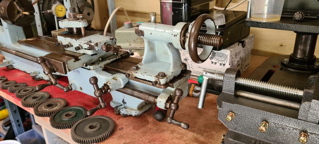

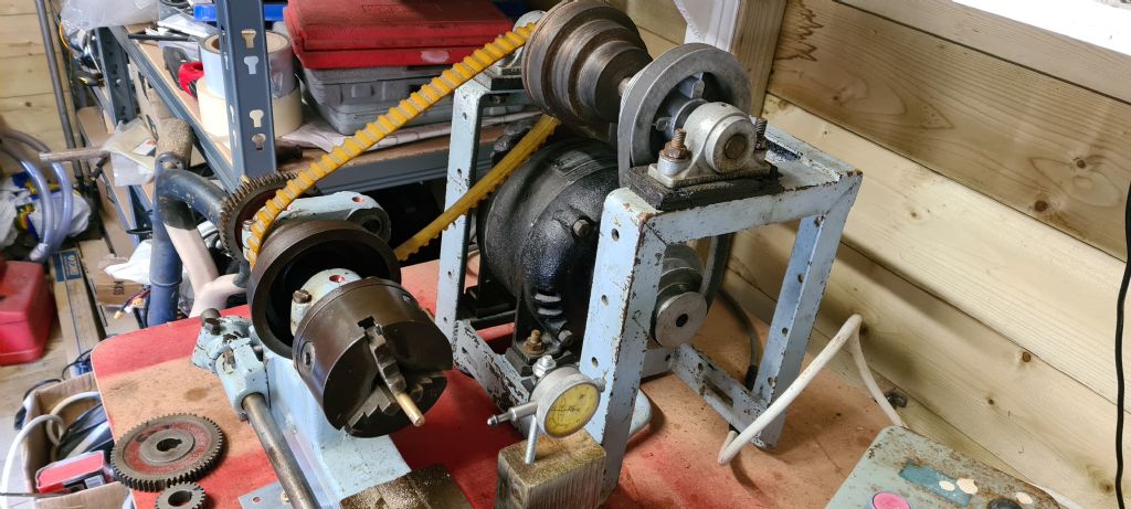

                              Hi all I've just acquired my first lathe it's a RandA and I'm currently establishing if I have any missing parts hence reviving this thread instead of starting a new one, trust that's okay.
                              So I'm missing the back gear shaft I think that's the correct terminology and wondered if anyone would be kind enough to provide me a sketch/dimensions so I can make a replacement.
                              Also what grade of steel would be required for the shaft and does it need to be hardened?
                              Thanks in advance.
                              Mario
                              #552986
                              bernard towers
                                @bernardtowers37738
                                Out of interest flat drive belts are still made, they are made from a modern oil proof material and usually coloured green. Try transmission suppliers/ bearing suppliers like Hayley’s etc.
                                #553009
                                Mario Jones
                                  @mariojones44715
                                  I have a belt that came with the lathe and the main spindle including the chuck and three pulleys, there's also a gear on the end. I also have a secondary/lay shaft with three timber pulleys run off a motor with a further three pulleys so there's plenty of options to change speed.
                                  I spent a couple of hours cleaning, oiling and adjusting everything and set the lathe up temporarily on my work bench she runs great.
                                  Also just ordered some spindle oil as I really have no idea what I'm doing and learning as I go, I could see the holes and worked out it must be for oil to lubricate the bushes, in fact I was surprised to learn it didn't run on conventional bearings.
                                  For now I loosened the spindle clamps, washed the oil ways through with WD40 and compressed air several times and put a drop of 30w engine oil with just a spec of WD40 to thin it slightly just so I could try running her. I've adjusted the clamps and end float C nuts to the point where you can just by feel find a little play, I read this was req'd to leave a small margin for expansion due to heat and to check by touch for heat in the spindle carriage after running. I think I have it set perfectly to be fair I'm fairly good in terms of thinking things through and working out how things work etc but still have a lot to learn.
                                  Anyway back to the main topic I am certainly missing the back gear shaft although the change wheels appear to be complete and present. One problem though the main change wheel 60t I believe that engages with the spindle gear has two missing teeth, but I'm fairly sure I can get this repaired.

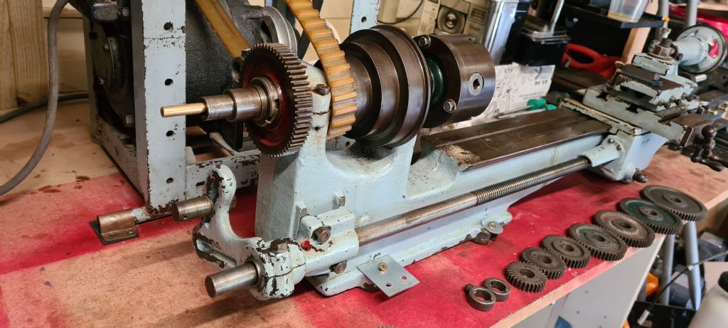

                                    Hi Mario, do you have the swivelling bush that the backgear shaft runs in? which is shown in the photo below.
                                    The shaft is 5 / 8" in diameter and is precision ground but it is not hardened and a piece of silver steel as purchased should be OK or even something like EN8. I will have a measure up of my father's old one and get the length and the size of the gears and post them later.
                                    Regards Nick.
                                    Edited By Nicholas Farr on 07/07/2021 13:55:28
                                    #553082
                                    Mario Jones
                                      @mariojones44715
                                      Hi Nick,
                                      Yes I do have the swivel bushing as your picture, if you can spare the time to have a measure up that would be great & thank you. I'm sure the information you provide will also be useful to others who happen upon this thread and may help keep more of these lathes in service.
                                      I'll try to work out how to post some pictures of the lathe I have so you can see what I'm working with.
                                      #553088
                                      Howard Lewis
                                        @howardlewis46836

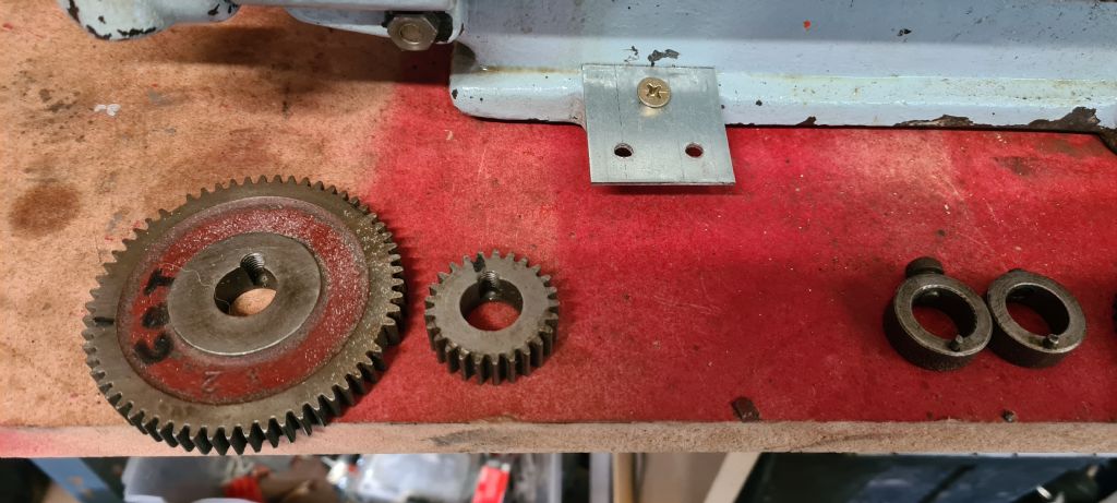

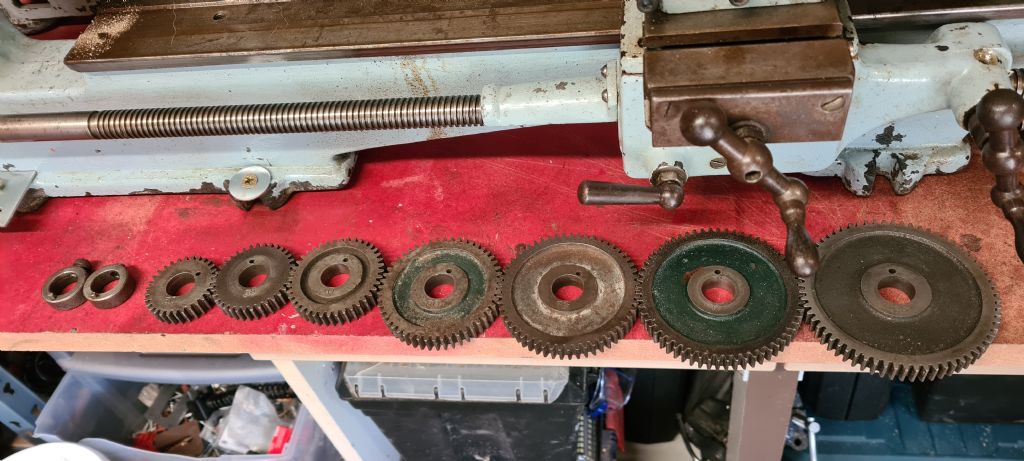

                                        When you are searching for a gear, it is important to know the dimensions, but also the DP and Pressure Angle.
                                        Gears with different DP will not mesh properly, if at all.
                                        Gears with different Pressure Angles will not mesh properly.
                                        Take a gear, count then teeth.
                                        Measure OD of the gear in Inches (Teeth +2 ) /OD = DP.
                                        You will not be able to measure the Pressure Angle, so you need gears of similar vintage
                                        Modern gears will be 20 degree P A, so not suitable.
                                        Drummond, or Myford gears will, be 14.5 degrees. Myford gears will be 20 DP. Gears for the 7 Series will have a keyway, so you will need to drill a hole, partway through for the driving pin.
                                        In this way 7 Series gears can be used on the earlier ML1, 2, 3 and 4 lathes.
                                        If you can find a gear of the right DP, PA and width, you may be able to modify to fit your lathe mby either boring out, or by bushing the centre.
                                        Howard

                                            Hello Howard thanks for the info, re My Ford change gears I have a set that came with the lathe, they seem to mesh with the RandA gears fine but as you said they have a key way not a hole.

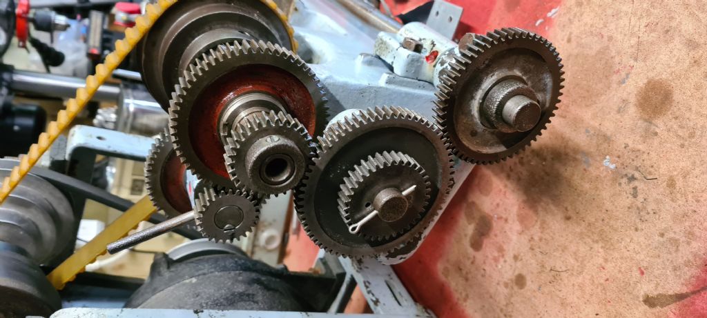

                                                  Gears for the Myford 7 Series are more likely to be available, so if you have one gear with a hole for the driving pin, it can be drilled through and used as a template to drill the Myford 7 Series gears. with both mounted on a 5/8" diameter (From memory ) shaft.
                                                  When I did this, the hole was positioned opposite the keyway.
                                                  Howard
                                                  #553107
                                                  Mario Jones
                                                    @mariojones44715
                                                    Thanks Howard that makes sense.
                                                    Nigel apologies if you have taken the time to measure the spindle I was digging through the bits and pieces I have with the lathe and pretty sure I've happened upon the missing spindle.
                                                    Athough I do appear to be missing a pin from the change gear arm.
                                                    #553117
                                                    Mario Jones
                                                      @mariojones44715
                                                      It only bloody works 🙂
