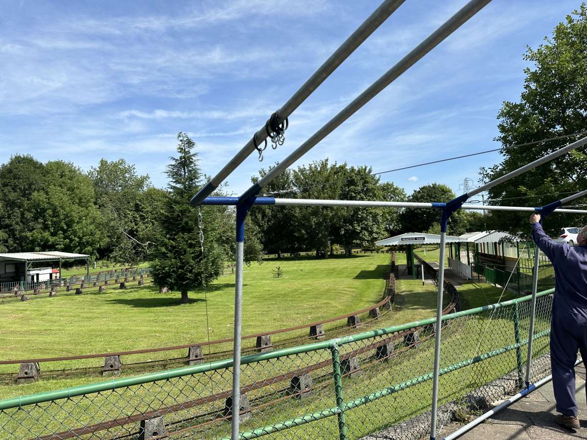

      Our club are deliberating an extension to our existing raised level 5″ / 3.5″ track layout.
      The existing track is built on concrete “tank teeth” plinths with steel strip rails joined by spacer tubes and studding.
      This obviously involves casting a lot of plinths (about 300).
      Existing track
      IMG_2101
      We have a supply of scaffolding tubes and the adjustable feet for same and are considering whether they could be used instead. Pole driven into the ground around 3 to 4 feet and foot upside down on top for fine level adjustment.

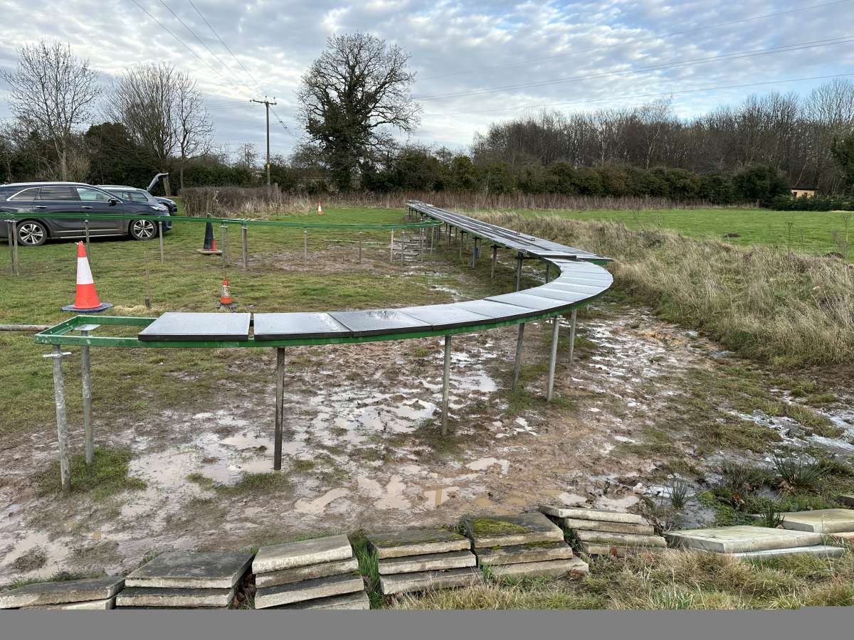

      We have recently built a Gauge 1 layout using this method but passenger trains weigh a bit more!
      Gauge 1 Method
      IMG_0209
      Obviously the track posts would be a lot lower in the ground than this.
      So, does anyone know of a club track that has something similar? We are interested in the stability aspects of a single pole. I suspect there maybe tracks that have similar single pole but maybe concreted in the ground?

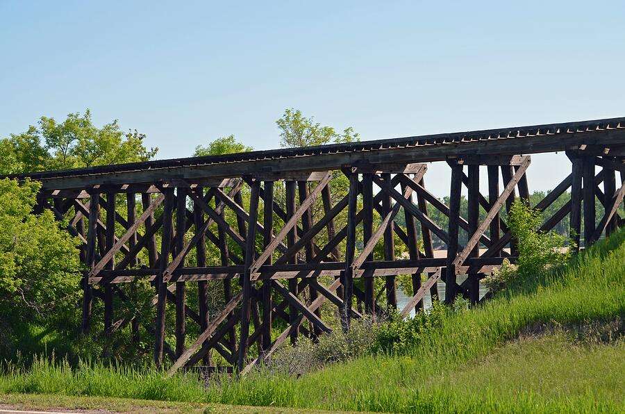

                        In addition to the problems mentioned by others, my concern with poles is rigidity.   Trains require a firm bed that won’t move much, which is why railways never use suspension bridges.  They’re too bouncy and it doesn’t take much movement to derail a train.
                        Scaffold poles are springs and there’s nothing to stop the single poles shown in Les’ prototype photo, bending and recovering with a flipping action.  The track won’t break when a heavy train takes that curve at speed, but the poles will bend and release the energy when the loco hits the straight, or brakes, risking derailment.
                        Les says the poles will be shorter, which will reduce spring considerably, but it’s still dodgy, and might resonate.   I think the posts have to be cross-braced and stayed as well.  Wood has a similar bendy problem, so elaborately braced ‘A’ frames are typical in railway bridges.  They resist sideways and fore-aft movement.
                        wooden-railroad
                        Speed limit likely too, and ideally no tight curves!
                        I’m sure scaffolding will work, but single poles are risky.   The existing raised track on concrete blocks is much less bendy design.  Scaffolding needs more thought – what could possibly go wrong?  Building a test track is a really good idea, but it needs to be long enough to run a heavier than normal train at double speed.

                                    Speaking as chairman of the Newton Abbot club, and despite comments above to the contrary, you can build a 3.5/5/7.25 raised track sitting on single scaffold poles. Ours has been sitting there happily without moving for longer than the 12 years or so that I have been a member. I understand that the poles were originally inserted by pushing with a large bucket on the end of a JCB arm!
                                    Les – if you would care to send me PM via this site with an email address, I would be happy to discuss details.
                                    Is this another triumph of experience over armchair theory? Said strictly tongue-in-cheek…
