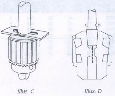

      Hello all,
      Can anyone help with a "stuck chuck"on my Raglan miller? I bought an ex-school miller and was puzzled about the Osbourne Titanic chuck fitted as it didn't seem to function correctly. All has been revealed recently when I managed to acquire a replacement chuck off ebay with all the component parts easily seen. It then became apparent that the locking sleeve on the chuck fitted to the miller had at some time in the past been installed the wrong way round resulting in the thing becoming completely wedged in the chuck body. All attempts at removing this from the chuck have failed up to now, including my making an expanding internal collet to pull it out and so think I will admit defeat and replace the chuck with the ebay chuck.
      The second difficulty is the chuck itself seems really stuck tight on the 2MT taper. I have tried several sharp blows on the end of the drawbar to release it, but no movement so far! Any advice on removing the chuck or the sleeve welcomed please! I'm worried about damaging the spindle bearings if I keep wellying it with increasingly heavy hammers!

          Have you seen the U shaped wedges advertised by one or two advertisers on this website? It might help also to warm up the spindle by running it for a while.

            Thanks for your advice Bazyle, not sure about the u shaped wedges but I'll look into it. No space at all to get to the 2MT unfortunately, but really sound advice about supporting the bearing whilst bashing thanks! Vaguely remenber your advice about loosening the chuck after use from a long ago apprenticeship!

              Kevin Bennett
                @kevinbennett25223
                hi u shaped wedges like the photo
                ty Kevin

                    thanks for all the advice, checked out u shaped wedges but cannot get near the MT as it is buried in the headstock. I'll try the side machining advice also to worry it out.
