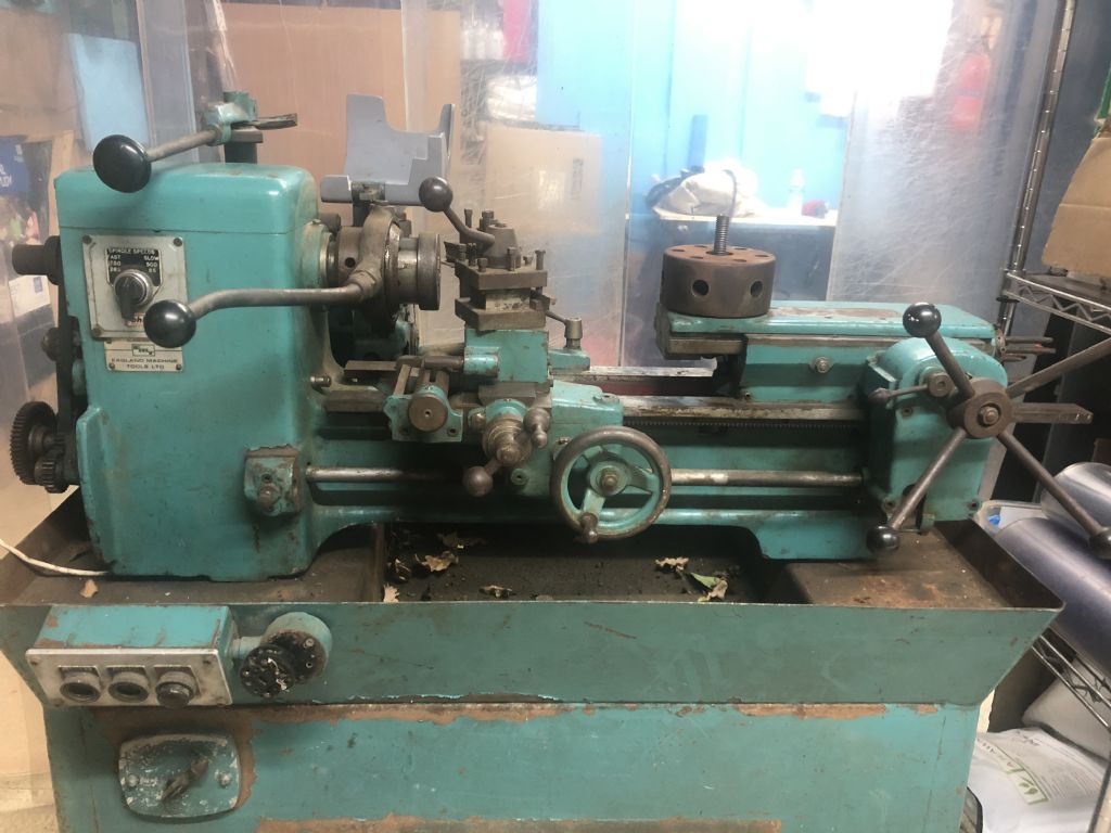

      Dear Folks,
      I've been reading this forum, and oh my what great advice!
      I have been gifted this lathe (Raglan Capstan MKII), I pick it up this week from Frimley Green and travel home to Saracens Head (Lincs)
      Apart from using my friends ML7, my last experience of lathe work was at school (some 40+ years ago).
      I can't seem to find a lot of information on this lathe (ordered a reprint manual from Tony at lathes.co.uk)
      My list of jobs: 1. clean and lubricate; 2. re-wire as there are no cables wired in; 3. work out what the boxes at rear of lathe do.
      Any advice or tips appreciated.
      P.S. I was going to attach photos, but I'm new to this platform and can't work it out.
      Kindest regards
      ANDREW

        My first lathe, a gift from a friend

            @Gray62 thank you – See my other photos too

              Hi Andrew, I know nothing about a raglan but as a capstan is it 3Ph ? I know a bit about lathes in general. If you need help or advice about wiring it up I;m not far from you. When moving it bear in mind it will be very heavy and may not be very stable. Good Luck Noel
              Just seen the pics, YES it will be VERY heavy and top heavy. It's got a lever operated collet chuck and the capstan looks as though it is like the myford an attachment. When collecting see if there are any collets for it, there may be many bits that are for the capstan. N

                #581627
                Howard Lewis
                  @howardlewis46836
                  What wonderful friends to have!
                  It looks as if you might need to find some fittings for the Capstan, such as holders for say, Centre, Roller boxes (Leading and Trailing ), Die Box or Die Holder, Tap Holder, .
                  If all else fails, you could fabricate / machine some of these Each one is basically a flange with a body with a central bore to hold the particular tool.
                  If so, probably the first job will be to make some form of adaptor that allows a conventional 3 or 4 jaw chuck to be mounted; unless you can find someone to do the work for you.

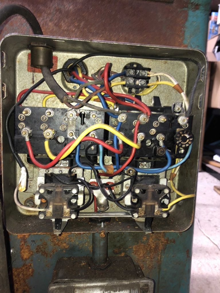

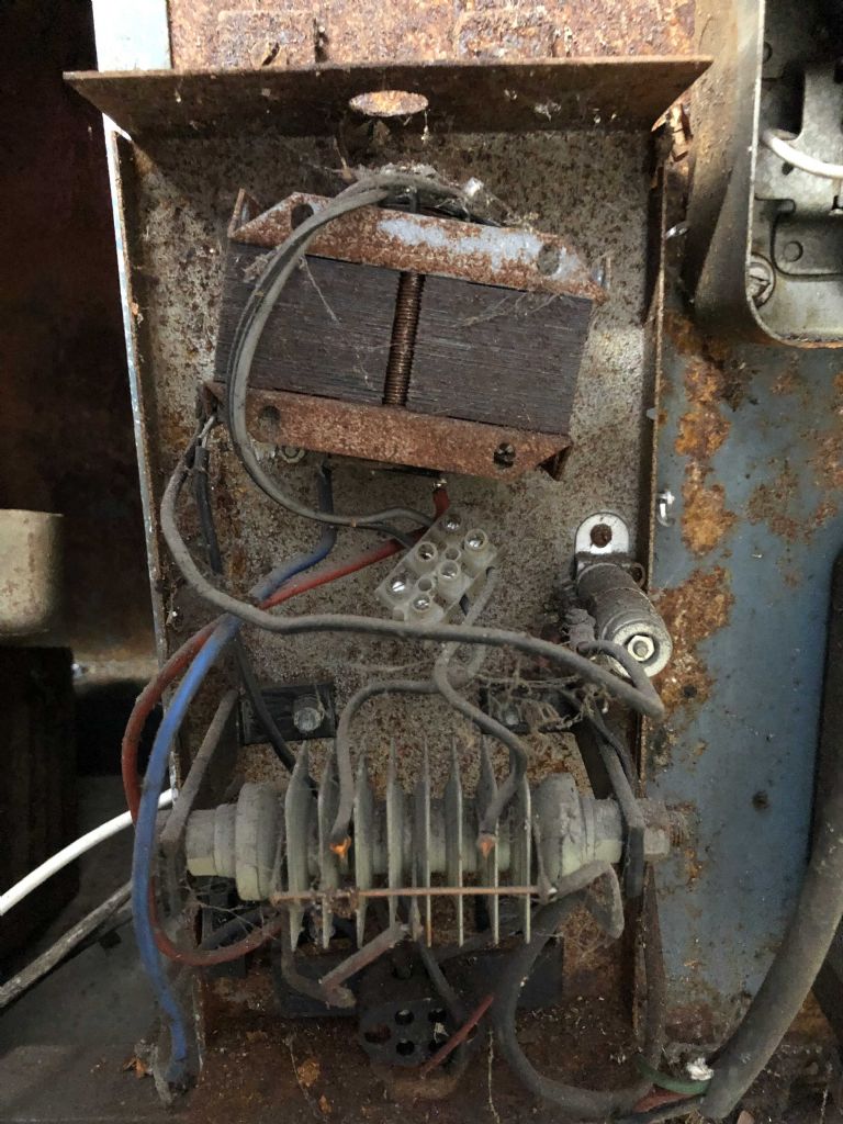

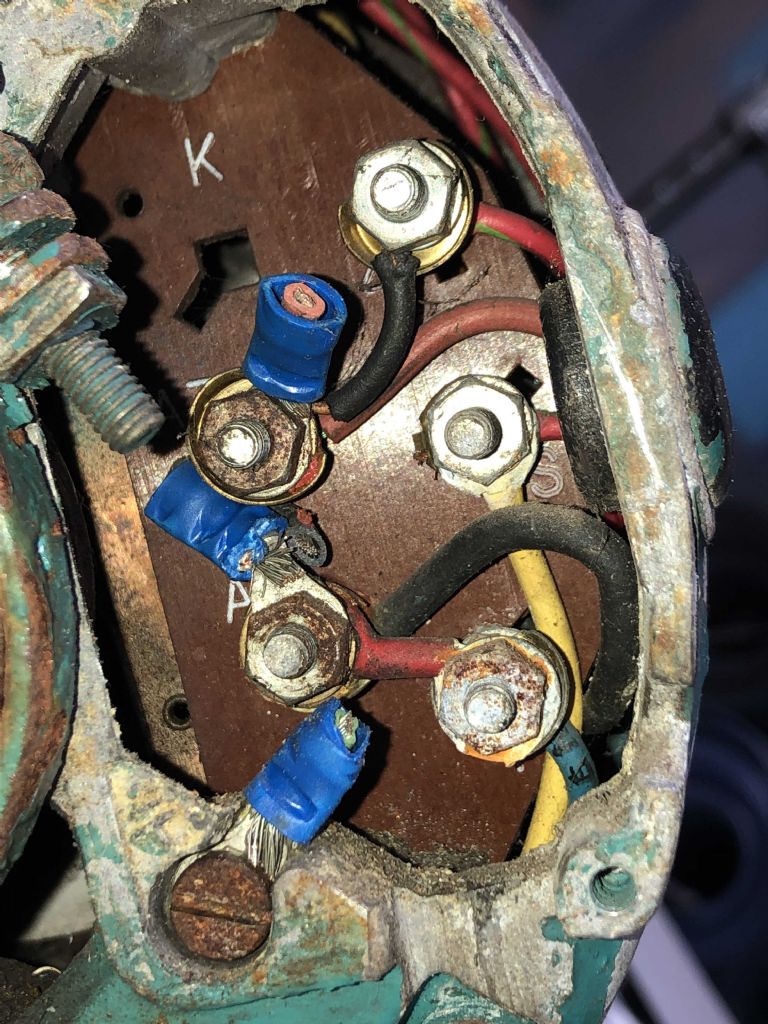

                          Dear Folks,
                          I have take some photos of the motor (single phase) and the two boxes at the rear of the lathe. Oh my the control box (whatever that is used for), has relays, etc. I wonder if I need to use this, or if this is for a three-phase input?
                          I just wonder what the general view is: (1) use existing controls or (2) bypass and re-wire? I am concerned if this control, panel NEEDS to be used for the electro-magnetic clutch, any ideas?
                          Regards
                          ANDREW
                          img_2231 conv.jpegimg_2229 conv.jpegimg_2244 conv.jpegDear Folks,
                          I have take some photos of the motor (single phase) and the two boxes at the rear of the lathe. Oh my the control box (whatever that is used for), has relays, etc. I wonder if I need to use this, or if this is for a threephase input?

                            Anonymous
                              The item with square fins, below the transformer, is a selenium rectifier, mostly likely to provide DC for the electromagnetic clutch.So you will need the panel to use the clutch.

                                I've just noticed your posting about this Raglan Capstan machine. This looks to be a very rare powered capstan model. It has two electro magnetic clutches inside the headstock and this allows instant speed changes to be accomplished for capstan work. I have some pictures of the insides of the headstock and a diagram of the headstock arrangement. These are like no other Raglan machine and was intended purely for capstan type work.
                                I believe the spindle may also be the 'LOO' type with a taper register, not the threaded type nose as used by 'normal' Raglans,
                                The way these capstans work was to set them up for mass production of small items (bolts, nuts, studs, short turned specials) To cut a thread for instance requires a Coventry style Die Head with corresponding dies of the correct thread, the cross slide operates as a fixed chamfer and cut off slide. There is only a power shaft at the front of the bed to power the capstan.
                                A very desirable machine – but only if you want to produce 500 1/4" UNF studs!

                                  I have seen this machine, very clever ! 3/4hp motor with variable speed pulleys feeding 2 electro clutches, giving stepless speeds of 85 to 1750. 24v dc for the clutches. The mandrel has a lever operated collet chuck. The cross slide has 4 stops, 4 way tool post and rear tool post for parting off. The saddle has 4 stops. The capstan is six station and driven off an auxilliary shaft via change wheels. Built for Small production work, a fascinating machine. Noel.
