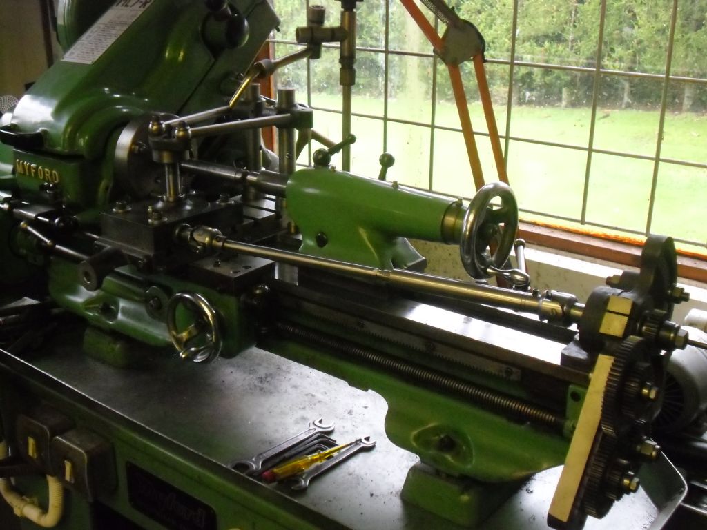

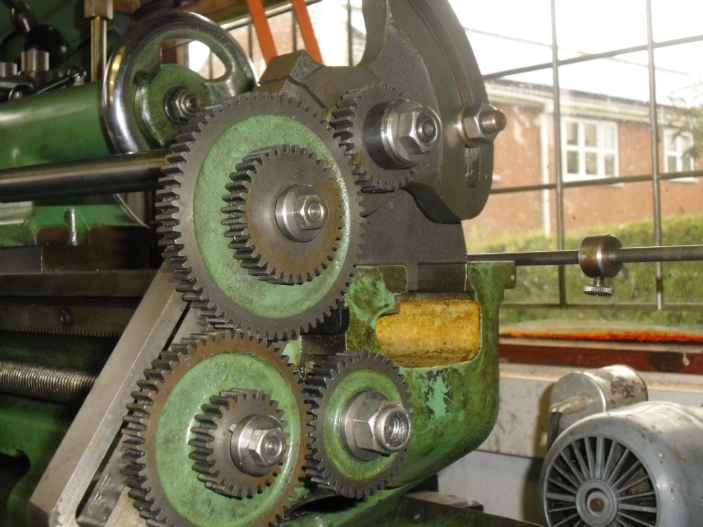

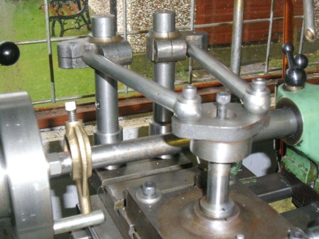

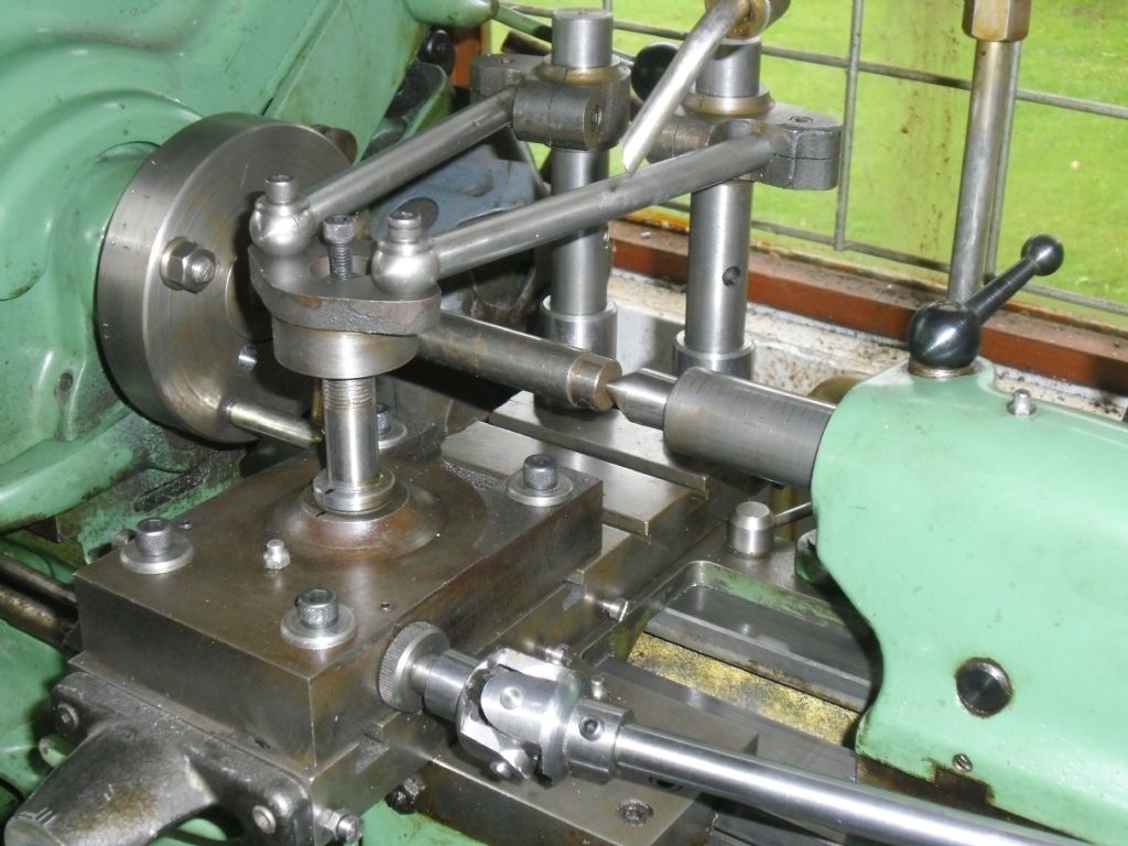

          Here are some photo's of the temporary set-up of the Radford Worm Wheel Hobber. I set the attachment up temporarily on the lathe and used the gears given Radford's example to cut a 30T worm-wheel. You have to imagine that the hob is mounted on the arbor between the centres and the gear blank is mounted on the vertical spindle. The catch plate shown is my interpretation of Radford's indexing catchplate, which he mentioned but never described, which in theory enables anything up to six-start threads and worms to be cut but in in reality three is probably the maximum achievable. I used it to cut the two-start worm and it worked a treat. The gear set-up appeared to work but I could not immediately explain why. The leadscrew was set to cut 20TPI, but it plays no part in the hobbing process except transmitting rotation to the banjo at the tailstock end of the lathe. There is a 40T gear on the end of the leadscrew and a 30T gear on end of the drive shaft. All the other gears are idlers. Subsequently, a forum member kindly PM'd me with some very helpful information. At this point in time I haven't completely got my head around it but I hope the penny will drop soon!

                I apologise if I didn't explain my confusion very clearly but in any event it has been resolved by a forum member who contacted me via the messaging centre so I will respect his privacy. My confusion arose because I had got it into my head that the 32T worm wheel and two-start worm formed part of the gear ratios that determined the number of teeth being cut which they do but only to the extent of producing a 2:1 reduction. Although the 8TPI Myford leadscrew plays no part in the hobbing process, except to transmit rotation to the banjo at the tailstock, it is obviously taken into account when calculating the speed reduction when cutting a thread or the number of teeth on a worm wheel. The 2.5 times speed reduction required to cut a 20TPI thread, i.e. 1/20" axial travel of the screw-cutting tool per revolution of the lathe mandrel, would be converted by the Radford device to a 1/20 rotation of the gear blank if it were a 1:1 ratio. Because the worm gearing reduces this by 2:1 it produces 1/40 of revolution of the gear blank. The increase in speed of 40:30 that Radford used increases this to 1/30 of a revolution, therefore 30 teeth. The penny finally dropped for this bear of little brain!
