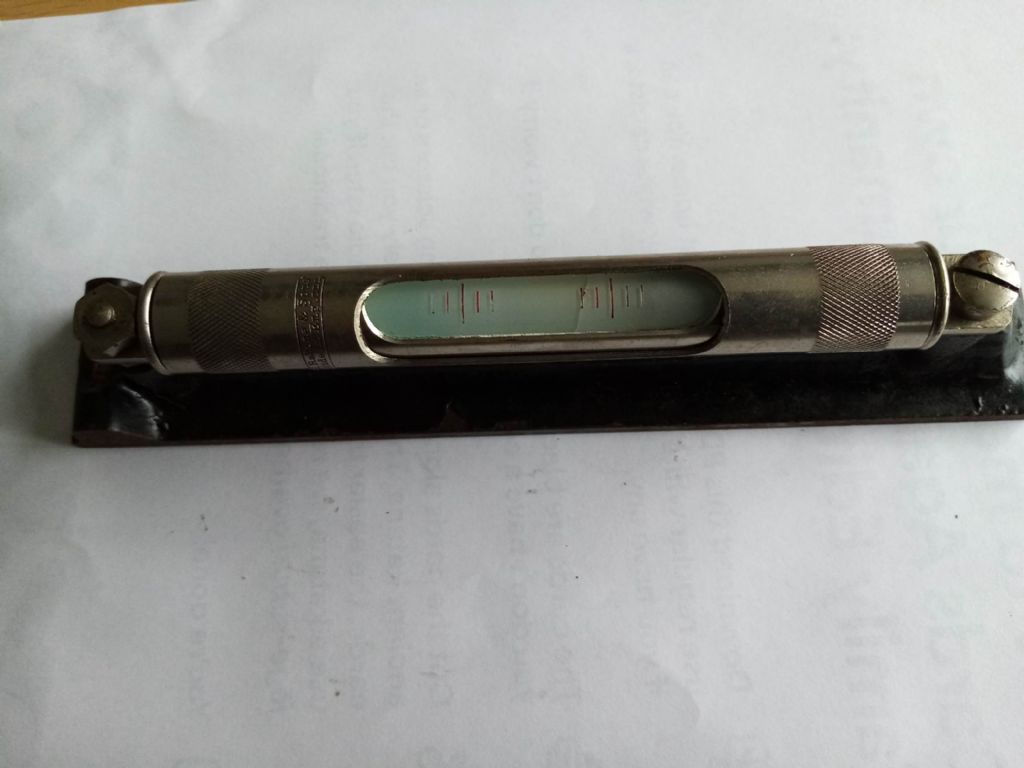

      img_20200428_171823.jpgHi all
      Over the moon when I won this on ebay.
      Got it for a tenner, bargain I thought till it arrived today.
      The glass phial is cracked and the bubble has escaped.
      Tried to source a replacement but everybody seems only to have up to 11mm in diameter.
      The Rabone tube has an i. D of 14mm.
      Does anybody a, have one theycansell or b, have any idea where to get one from

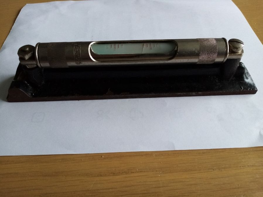

          I'd be inclined (sorry, not intended as a pun) to make up some tubular spacers and use the 11mm ones.
          Or these people might be able to help – no connection, just searched for Rabone level spares.

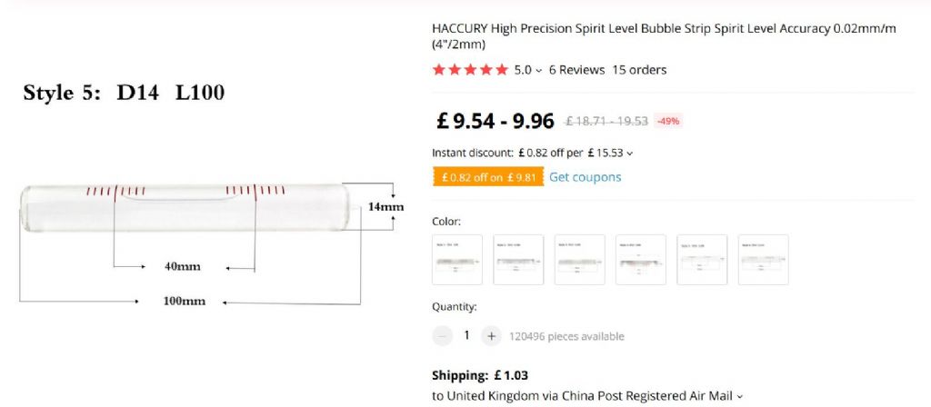

            I picked up one of these from Aliexpress in China. Don't know how the accuracy compares with the real thing but better than a broken one.

                The dia. of the bubble tube can be anything you can get. better if you can get one that has lines etched on it. Mounting a bubble smaller than the tube dia.is easy using some paper made into a sort of concertina form, folding it layer by layer till you get a sliding fit. cap/fill the ennds with plaster of paris making sure that the sealing point is clear and under no pressure from the plaster of paris.

                          I can confirm that the paper concertina and plaster of Paris method of repair works very well indeed. I am afraid that I have forgotten the source of the new capsule, but one of the above replies gives a starting point.
                          The main problem was getting the end cap off without damaging it, putting it back on was almost as bad! It was a force fit on my example..
