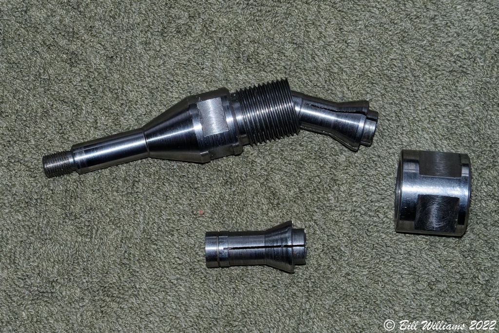

                  As well as a bunch of blank arbors, I also made a couple of longer rods which can be used for setting up, and a small collet chuck + Collets.
                  The little chuck duplicates the end of my 110V die grinder, so I can use mounted grinding points on the Quorn.

                        Just a quick photo of the collet chuck for the Quorn, to take ¼" & 6mm mounted grinding points, or even carbide burrs.
                        I'd forgotten, It looks like I already had a photo in the album of the one on a long spindle/arbor too.
                        The lower right one is the Clarkson adaptor for their milling chuck(s)
                        Bill
