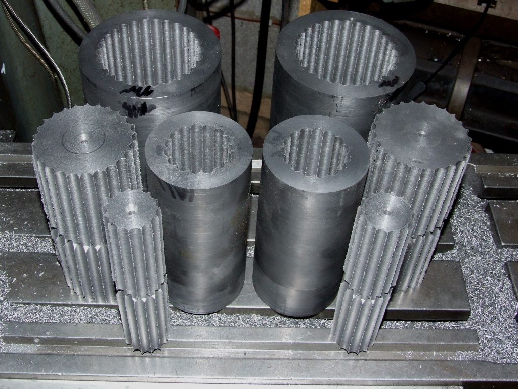

            I do 99% of my drilling on the vertical mill and it would be a real PITA not to have a proper quill feed. I use the knee when milling to precise depths, but not for drilling. My mill has a quill handle like a pillar drill, a precise feed wheel and power downfeed on the quill. I don't use power downfeed very often, but it is useful when there are a lot of deep holes needed in order to remove waste material:

                      Posted by Andrew Johnston on 20/10/2021 11:38:26:
                      Thats impressive
                      Can you tell us how you cut between the drill holes?
                      …or is it close enough to tease out?

                          Posted by Ady1 on 20/10/2021 13:13:48:
                          I didn't need to. The number of holes and drill size, on a pre-determined PCD, were chosen so that the holes overlapped by a few thou. After drilling a sharp tap with a nylon faced mallet was enough to break any remaining webs and for the core to fall out.
