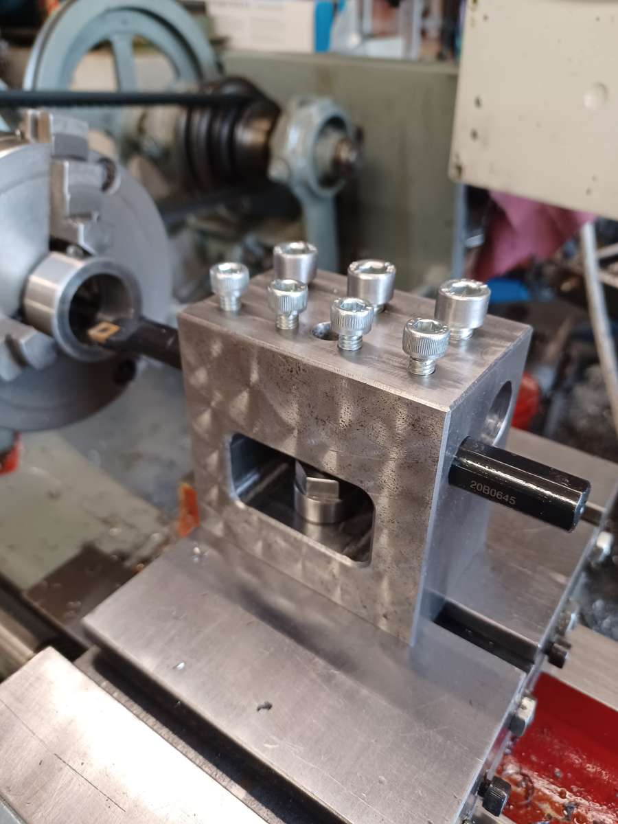

        hi have a look at this from RDG just check the center height for your lathe.
        https://www.rdgtools.co.uk/acatalog/QUICK-CHANGE-TOOLPOST-SET-FOR-MYFORD-LATHE-WITH-PARTING—VEE-HOLDER—MYFQUICK.html
        On my lathe, an M Type lathe, i have made special tool holders which bolt to the cross slide as this allows me to hold tools more sturdy on center height.
        20190316_164659
        rear toolpost for part off tool.
        20230910_171836
        the boring bar holder with 2 diferant size tool holder bores. perhaps you could do somthing similar to fit your lathe.
        David

            Just be aware that while a QCTP system is very handy, these can reduce tools rigidity slightly and particularly if you are looking to use ‘heavier’ tools and taking deeper cuts this may be a problem.
            The rear toolpost in David Georges’ post is a very good idea. There are numerous published articles and Youtubes on how to make. I just recently knocked one up (no specific design, made it up as I went along) and it works a treat, specifically for parting-off.

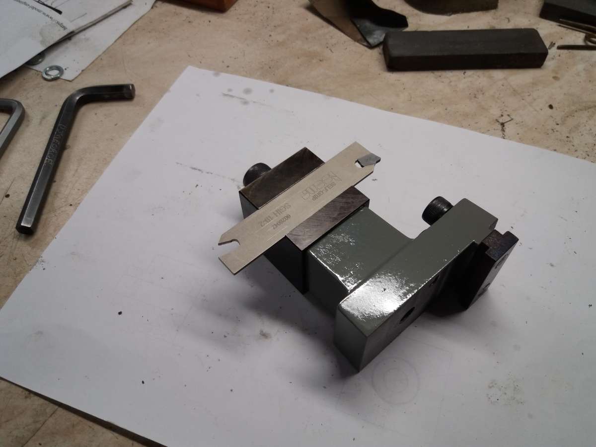

                Here it is again:

                      Id like to see a pic of your parting off tool. Actually, that is one main issue I have with using the standard T-post.
                      I have an HSS blade tool (maybe it came when I bought the lathe), and the design of it doesn’t allow the clamp-nuts to get a proper grip. Obviously, chatter is a problem with parting anyway – better to Hacksaw than this thing.

                        Is this yours John H?
                        eBay item number:374485044113

                          Macolm
                            @macolm
                            I would recomend the wedge type 250-111 toolpost. The rigidity is very good, and I almost always just use it for parting off rather than a rear toolpost I also have for my Bantam lathe. It is also more rigid than the previous four way toolpost it replaced.
                            A useful advantage is the precise location of the toolholders, allowing to swap tools and get back to exact sub thou cutting edge positions, for example when making several identical parts.
