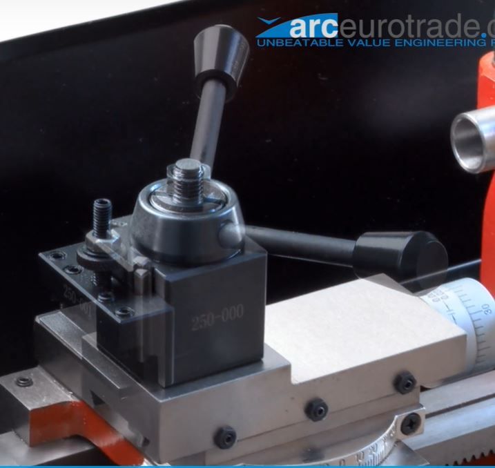

                          Well, I've got to disagree with the 4-way enthusiasts here.
                          I think a QCTP transforms using a lathe. Yes, the holders a fairly expensive, but you don't have to buy loads at once, you don't have to fool around with shims, just a simple screw height adjustment to set each tool up, you can take a toolholder out, noting the setting on your dials, put in another one and use that, then swap back to the original and know that the dial setting is still good (yes, I know that a 4-way should index properly, but on a cheap lathe it probably won't, and the indexing mechanism only works with the toolpost and topslide aligned – no setting the topslide round to clear the tailstock)
                          Also, it takes up less room than one of those four way abominations with its tools sprouting out in inconvenient directions ready to take a chunk out of your hand when you're trying to mic the workpiece (and you can hardly ever use all four positions with a sensible combination of tools).
                          I have one of these:
                          https://www.arceurotrade.co.uk/Catalogue/Machines-Accessories/Lathe-Accessories/Tool-Posts/Model-000-Quick-Change-Tool-Post-Set
                          It would have probably been better to have the next size up, but I re-used it from another lathe and I don't have any problems with the rigidity of it – parting off diameter is only limited by the lack of low speed torque of the brush motor on my lathe, and the maximum depth (15mm) of the carbide insert toolholder I usually use – I have gone considerably deeper in stainless steel with a blade type holder, but I worry about cooking the motor with such antics. Of course you have to have the holder set accurately to centre height, but that's easy with a Quick Change toolholder…

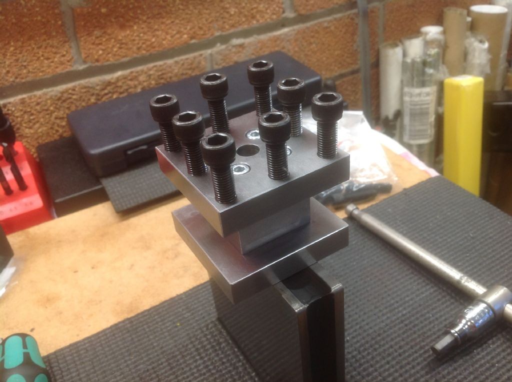

                                                Bill Phinn
                                                  @billphinn90025
                                                  Posted by JasonB on 24/07/2023 14:17:04:
                                                  Posted by Bill Phinn on 24/07/2023 13:56:04:
                                                  Posted by Clive Foster on 24/07/2023 12:59:33:
                                                  +1 for the multiple identical 4 way or 2 way posts as an effective alternative to a QC system f
                                                  This is the way I want to go, Clive, with my 8×16 [M10 toolpost stud] lathe. The only snag is finding someone who actually sells standalone 4 way toolposts. QCTPs, by contrast, can be found everywhere.
                                                  If anyone knows a source, please let me know.
                                                  They are not hard to make, I did one while still at school for my Unimat3.
                                                  OK, Jason, you shamed me into it. The clamp screws are 5/16" UNF.
                                                  I've acquired a QCTP as well in the meantime, so eventually I'll be in a better position to decide which I prefer.
                                                  #656462
                                                    Looks good bill, keep us posted!
