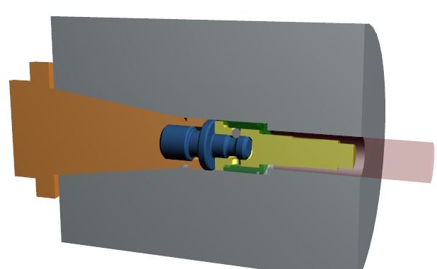

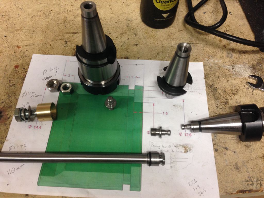

      My used Taiwanese Bridgeport clone milling machine has a NMTB30 taper for the spindle tooling. As I now live in Canada, this has been a bit of a hassle, since almost all tooling for these machines is R8 here. Tooling in general in North America is very expensive – it`s either locally made and expensive or it`s imported (Chinese or Indian, the usual suspects) with the price hiked up so it costs about twice as much as it would in the UK. I ended up buying most of my spindle tooling from the UK and was a lot better off even after duty and shipping. However, I now have a mixture of M10 and M12 threaded NMTB tooling.
      The NMTB30 has an ISO30 taper and a short parallel shank with either an M10 or M12 internal thread for a drawbar. I've become rather tired of having to swap over the drawbar from M10 to M12 each time I want to change from the M10 threaded drill chuck (drills, centre finder etc) to the M12 threaded collet chuck (milling cutters etc), so I started to think about quick change systems.
      The normal solution in N America is a power drawbar. This is basically an air powered impact driver mounted on top of the head. There is also an air solenoid that engages the impact driver with the top of the spindle before it starts to turn. This presumably works pretty well with R8 tooling but wouldn't be quite so effective with the NMTB and MT tooling which requires more encouragement to eject. It would also require a compressed air supply which I don't currently plan on installing.
      "Proper" quick change tooling used on CNC machines uses a pull stud mounted on each of the tools and a claw device that positively locks onto the stud and pulls it into the spindle (usually against some form of taper). There are also other systems that use a ball and ramp system rather like the concept you see used in industrial and garden hose couplings. Either way, these systems generally require a sprung draw bar to retain the tooling and some means of compression / ejection. Some quick patent searches come up with the obvious solutions, mostly expired long ago. I wasn't going to be inventing anything particularly novel here.
      I didn't fancy the impact driver approach , either air or electrical. It just sounded too messy and probably not appropriate for a fixed taper. The industrial pull stud equivalent of my NMTB system (called BT30 etc) requires space inside the spindle for the pull stud gubbins that simply doesn't exisit in my machine. I measured up the (tiny) space available in my spindle and got scheming (and modelling).
      The parallel shank on the NMTB30 doesn't actually contact the spindle bore, so apart from housing the M10/M12 thread it has no functional purpose in my setup. I could chop much of it off as long as there is enough thread remaining in the (hardened) body to accept a pull stud. By doing so, I would have a cavity of about 17mm diameter and around 30mm length in which to accommodate some gubbins of my own device.
      Here's what I came up with. A fairly conventional pull stud (to my own dimensions, by necessity), a mating socket with four captive 1/8" ball bearings, a sliding collar with a ramp to drive the balls into the groove in the pull stud and an o-ring to cause the collar to drag within the spindle cavity. Beyond that, a draw bar would extend up above the head. This would have a compression spring to keep the tooling engaged and an end stop and bearing bearing so that the draw bar and spring could be compressed by raising the spindle against it, to allow tool removal. Sounds simple enough but would require some critical machining. My skills are closer to the agricultural engineer than the watchmaker, so this would be a challenge…

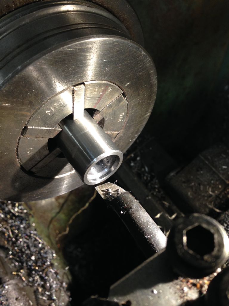

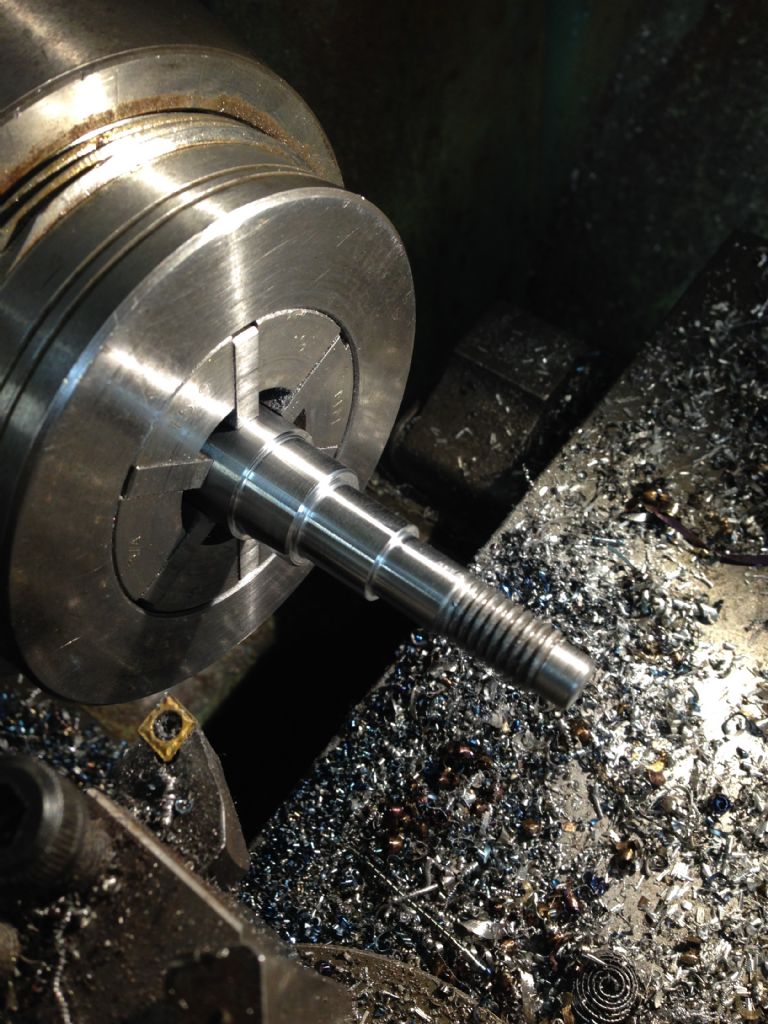

          1 - assembly section
          Once I`d acquired some ball bearings from a local bike shop and a few 1/8" ball-ended slot drills, I had everything I needed to get started.
          The stepped outside profile and M10 thread was pretty straightforward using carbide indexable tooling and M10 die.
          3 - turning the body
          Boring the holes for the ball bearings required precise setup in the milling machine. The holes were cut with a ball-ended slot drill such that the 3.2mm diameter ball only emerges 0.9mm into the central bore at full engagement, otherwise the balls would fall out between tool changes. I set up the work individually for each hole using a center finder and the DRO and carefully bored to the precise depth. The cutter was slightly under size relative to the ball, so I moved the cutter to give an additional 0.1mm in all 4 X and Y directions. This worked well – the balls are free to move but aren't in any danger of falling out.
          5 - finished body

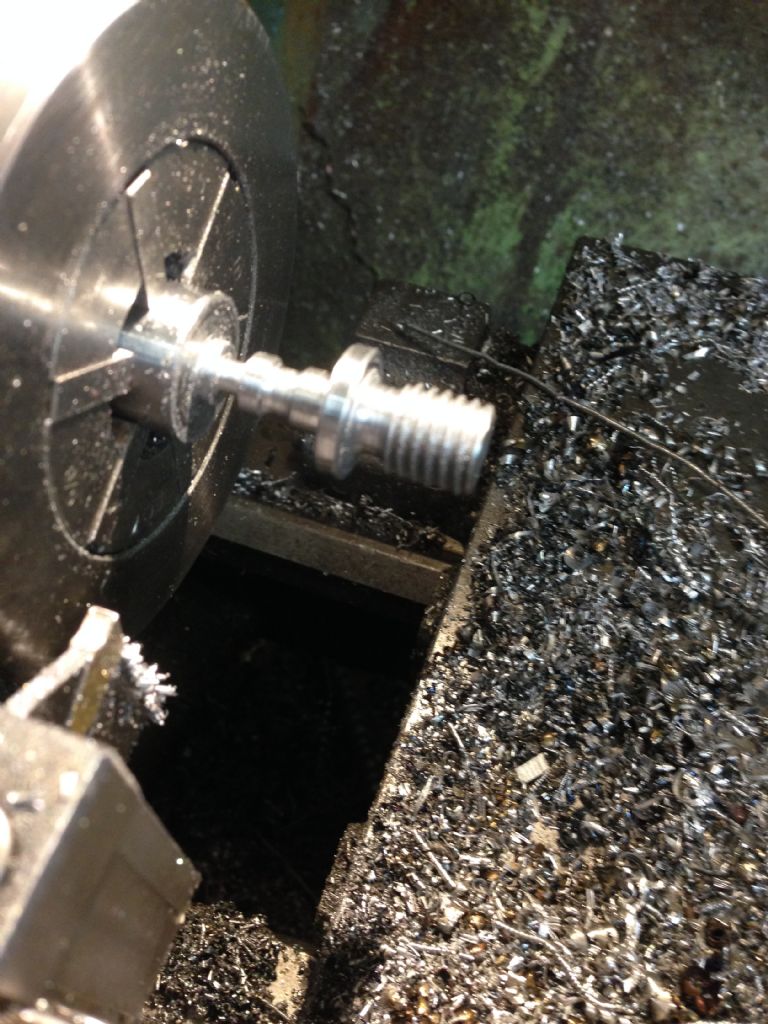

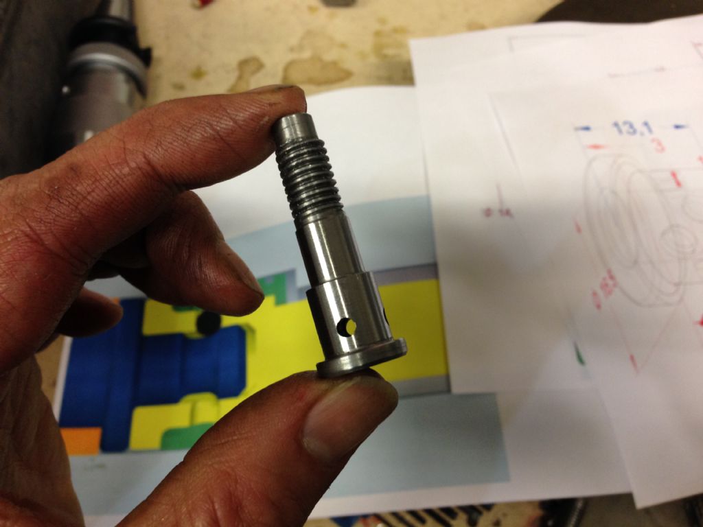

          The pull stud had to be machined “backwards“ ie with the large M10 or M12 thread at the tailstock end. I don`t have an M12 die any more(!), so had to set up my (imperial) Bantam to cut the M12 x 1.75 thread. Once you start cutting with this setup, you mustn`t disengage the half nuts. Then I turned the head of the stud using a parting tool and 1.6mm radius tool, before parting it off.
          6 - machining the pull stud

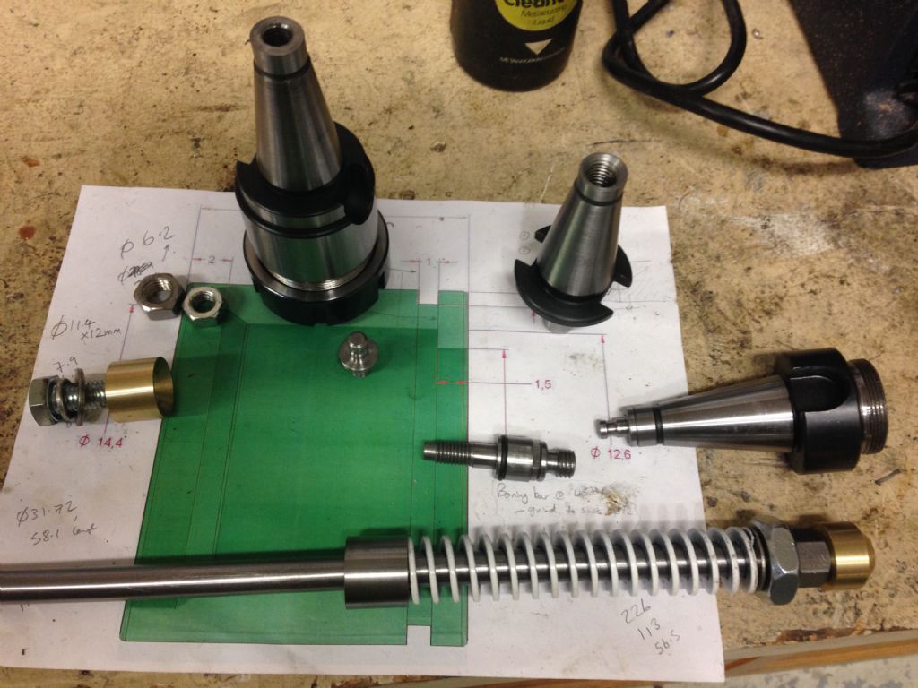

          The final part of the core assembly is the closing collar. I machined this in the lathe using a small HSS boring bar and achieved a pleasing finish and accuracy. The groove on the outside is to house an o-ring. This provides some drag on the collar against the bore of the machine spindle to open and close the mechanism as the draw bar moves up and down against the spring. It seems to work well.
          9 - boring the collar
          12 - component parts

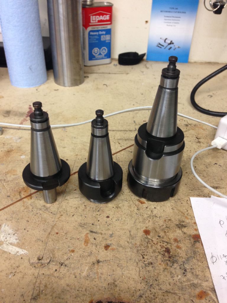

            I realised quite early on that in order to make enough space in the spindle cavity for the mechanism, I would need to shorten the (non-functional) parallel shanks on each tool holder to accept the pull stud. I ended up removing about 10mm from the length. I heated the shanks up to red heat to make them machinable without affecting the main taper. I can still use the original drawbar(s) if I need to go back.
            13 - toolholders

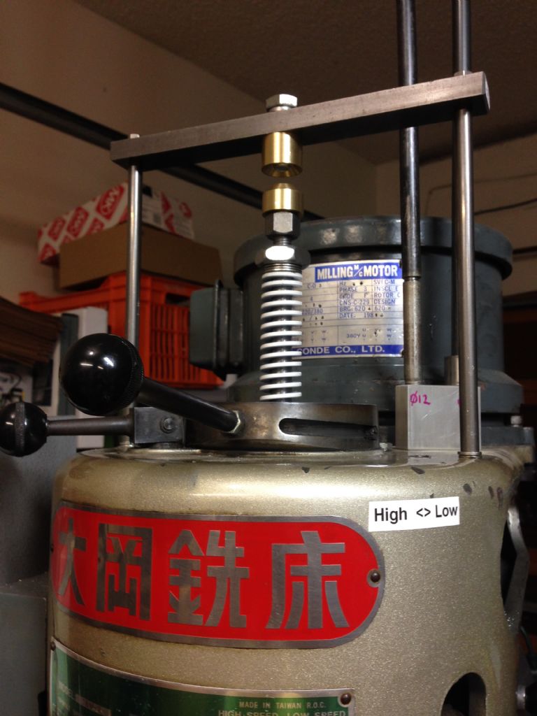

            I obtained a 4" long die spring with 1/2" bore that seemed about right for the application. My estimation of the axial force I typically applied with the existing drawbars suggested that the spring rate should be of the correct order to allow a sensible adjustment of preload.
            The drawbar has an adjustable tapered bronze nut at the top end that butts up against a hard stop. This allows the spring to be compressed when you force the quill up against it through the last 5mm or so of return travel, releasing the pull stud.
            11 - drawbar spring and release
            With the component parts hardened and tempered and the parts assembled, I checked that releasing the compression spring before the pull stud was fully inserted did not result in broken parts. This worst case condition puts a fair stress on the collar in particular but it and the studs seem able to tolerate it.
            I can now change tooling in the time it takes to drop one tool holder out and insert another, which is of the order of a second or so. That's a significant improvement on the endless palaver with the spanner, mallet and swapping drawbars which took nearer a minute. I will have to find something else to swear at now.
