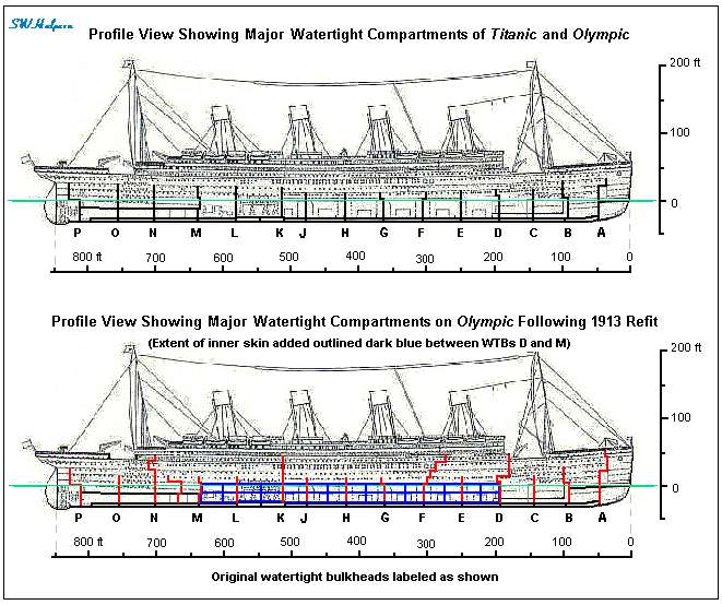

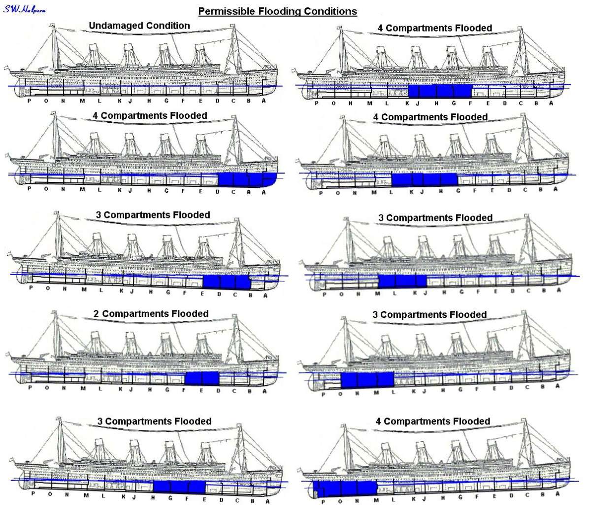

      On Steven C Said:
      Then it didn’t help that the bulkheads were open at the top, allowing flooding to spread into undamaged compartments as the bow sank.
      It should be noted the reason why Titanic’s bulkheads weren’t sealed at the top, was because it was and still is against maritime shipbuilding law to fit a passenger vessel with watertight bulkhead decks above passenger spaces with no means to escape. The only reason as to why modern cruise ships are fitted with watertight bulkhead decks is because there is no passenger accommodation below the waterline or anywhere near any of the subdivision on modern vessels. There are various other reasons why Titanic’s watertight subdivision was the way that it was. Titanic wasn’t the first nor last liner with open bulkhead “roofs” take a look at the S.S. United States, Queen Mary, and Queen Elizabeth.
      Not sure I understand this, if watertight  bulkheads extend to deck level, but there is a stairway in each compartment, people can still escape. I thought the problem was that bulkheads stopped well below the deck to allow grand ballrooms etc. Connection below deck through bulkhead would be by watertight doors which could be closed by the crew on the event of an accident.
      #725707
      Steven C
        @stevenc95127
        It is entirely possible to extend the watertight bulkheads to the deck level but then you’d run into the issue of the difficulty for both crew and passengers being able to traverse the ship. Titanic was a 2 compartment ship meaning she could survive with any two compartments flooded, most modern cruise ships are also of the 2 compartment standard. In reality, Titanic was closer to a three-compartment ship and in a worst-case scenario could handle 4 compartment flooding in her foremost or aft-most compartments. After the disaster, her sister ships Olympic and Britannic were modified to raise their bulkheads to facilitate up to 3 compartment flooding anywhere in the ship. There’s also the science of flood curves, to which it’s a little harder to explain with just text.
        Olympic_refit5fq3ws9cqxt81
