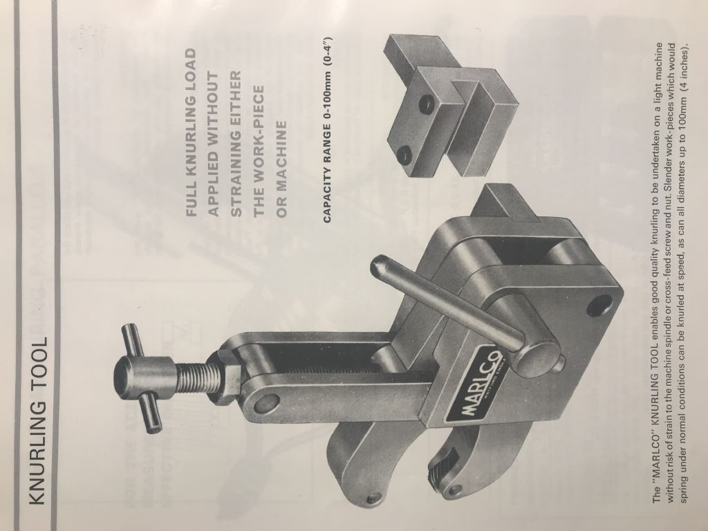

      I picked up a clamp type knurling tool today from a sale. It's a substantial thing made by marlco but it's missing the actual wheels. It's a long shot but does anyone know what size wheels I need? and where to get them.

          You will be governed by the pin size & slot width in the arms.

            The pin measures about 5.5x mm so I'm guessing it's 7/32". Chronos seems to have them with that bore size but it doesn't mention the width?

                Despite its massive construction, the Marlco wheels are relatively small. You are right that the pin is 7/32"
                The wheel diameter is 5/8", and the wheel width is 5/16" (a snug fit in the arm).
                They are a joy to use, giving a lovely knurl without effort.

                  I also have one of those Marlcos. The right wheels are Series AJ, 5/8" OD x 5/16" W x 7/32" Hole.

                                  I’ve bought a few Knurls at the shows over the years and they’ve all had 6mm or 1/4” holes for the pins.
                                  #515073
                                  John Hall 7
                                    @johnhall7
                                    Yes 7/32 does seem an odd size…maybe so you could only use wheels supplied by Marlco🙄
