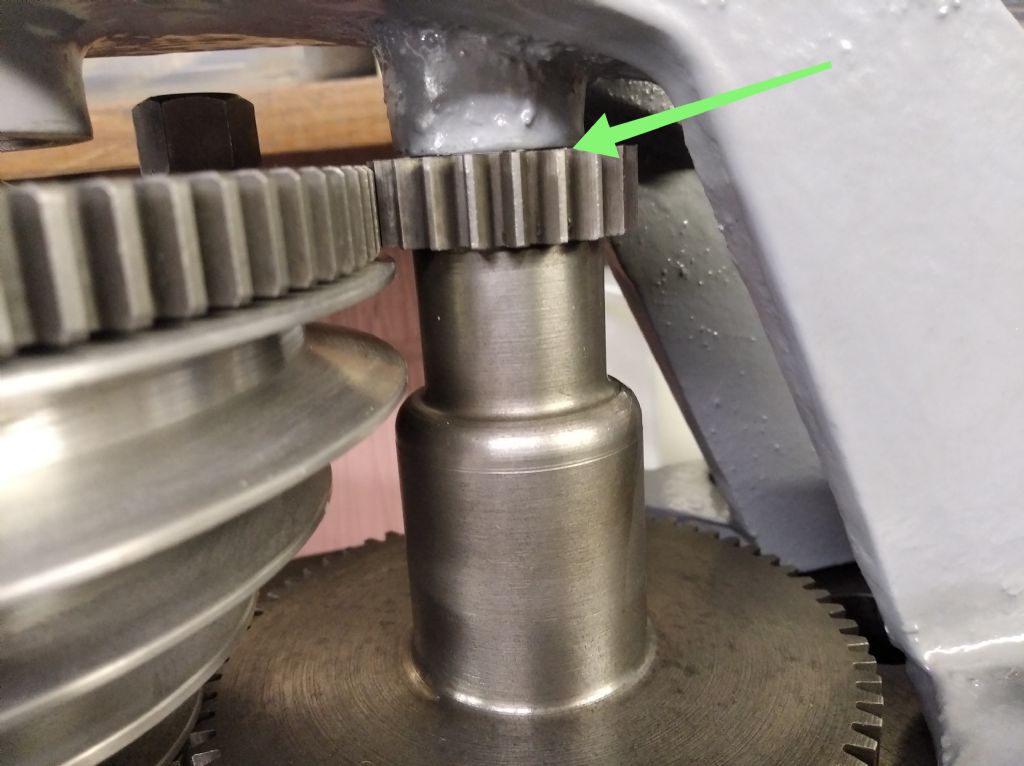

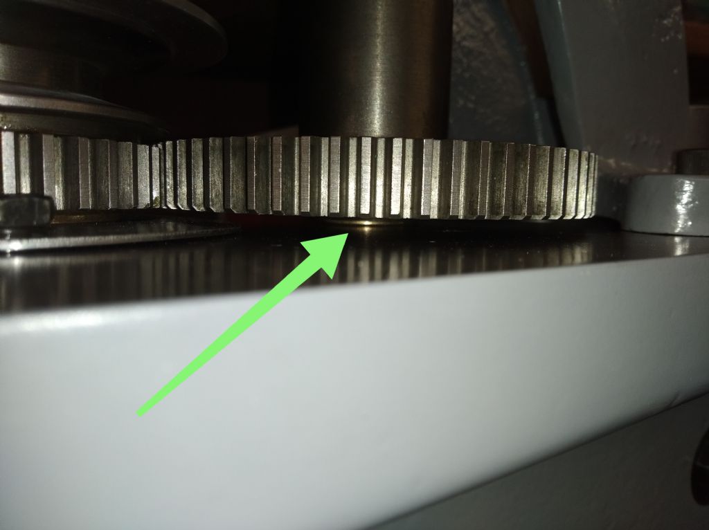

      Earlier in this thread you'll see the top of the drill casting had a slight wear mark where the back gear had worn into it, so I skimmed about a millimeter off the top of the back gear, so I could put an oilite washer underneath.

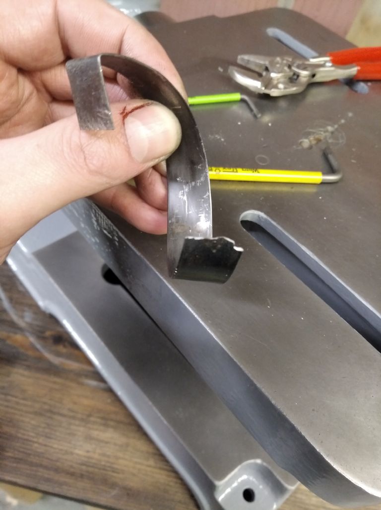

        Removing the quill spring was a mistake, I would advise against removing this for any individual thinking about this, trying to put it back drew blood on both hands, and snapped the centre part where it attaches to the pinion arbor, luckily I was able to anneal it and re-bend a flat to hold in the arbor split, the paint also got a bit damaged indecision

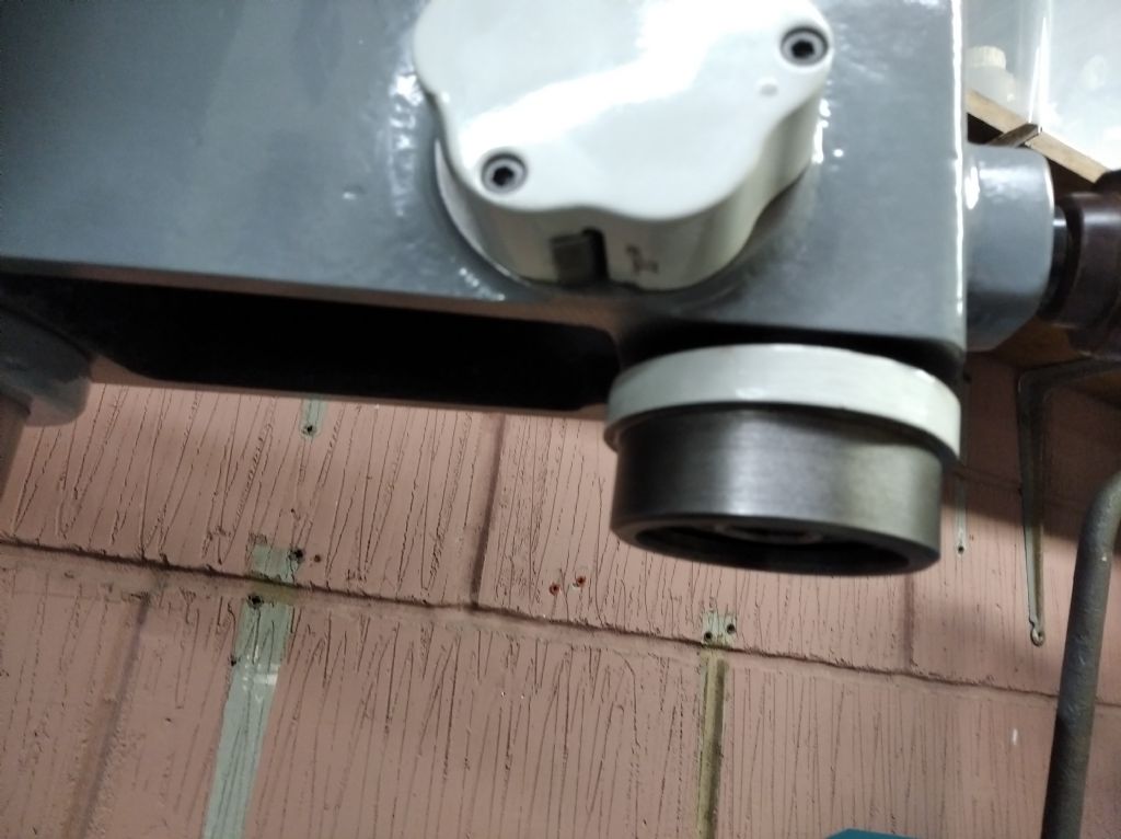

          For anyone replacing the bearings, on this revision the bearings are 25mmx52mmx9mm and 1"x2"x3/8" for the upper pulley assembly, and 1"x2 1/4"x5/8" deep groove, 17mmx40mm12mm angular contact for the spindle.

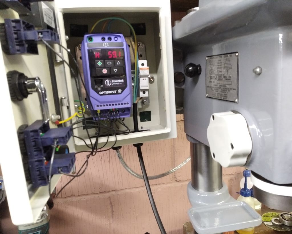

                Thanks both, I've wired up the motor and inverter, so over the weekend I'll have a play with that setting it up.

                    Had a play with setting up the inverter, ran an auto-tune which is supposed to make the vector thrust feature work a bit better.
                    It all appears to be working well.
