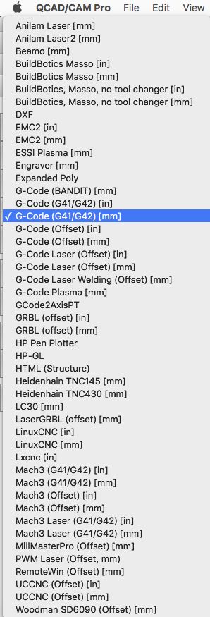

      This may be of interest to prospective purchasers:
      There is a long list of 'Postprocessors' available in the CAM configuration … I can find no handy description of their usage, but I do recognise a few of the names; and was particularly pleased to see HPGL
      I suppose it's 'need to know' … in the sense that you will recognise the name of something which you will need to be using.
      and … if I understand correctly, there also is a facility to create your own.

        Posted by Michael Gilligan on 19/11/2021 20:36:28:
        For ease of reference : **LINK**
        https://qcad.org/en/qcad-cam-postprocessor

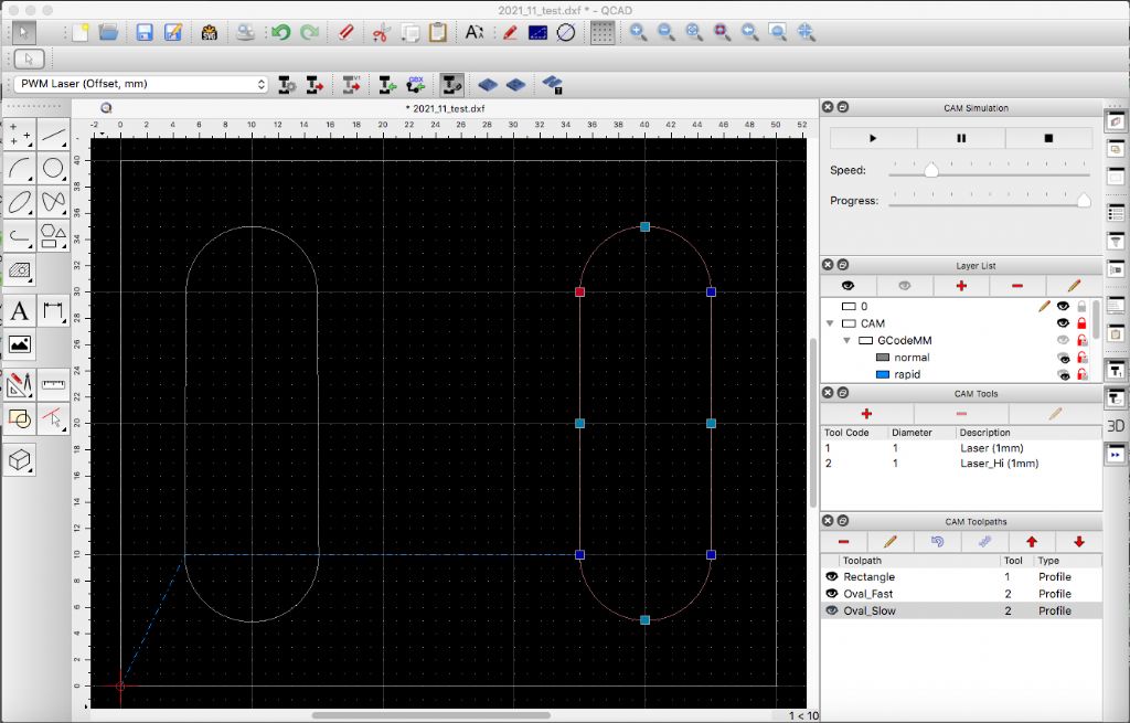

          I have, with a little difficulty, managed to configure QCAD/CAM to output suitable GCODE to drive my little Laser Engraver using Universal GCODE Platform [UGS].
          The ‘brief tutorial’ at https://qcad.org/doc/qcadcam/QCADCAM_Tutorial_en.pdf **LINK** is rather specific to one Postprocessor, and so it was very helpful to find this video on YouTube https://youtu.be/zy18Z2xYxHU**LINK**
          The Configuration [postprocessor] “PWM Laser (Offset,mm)” works nicely … and generated a file which runs correctly on my little engraver.
          The process, in brief summary, is to:
          1. Convert all the individual shapes in the drawing into polylines.
          2. Create one or more Tools
          3. Create a Toolpath [which calls-up a Tool and has other variables] for each polyline.
          4. Export the code
          5. Run the code in UGS
          6. Admire the result
          There is a lot still to learn, but it all looks very promising.
          My test piece is a 50×40 mm rectangle with two rounded-end slots, and the generated Code is clean and simple:
          The Toolpaths ‘Oval_Fast’and ‘Oval_Slow’ differ slightly, and are there to allow me to experiment with various parameters :

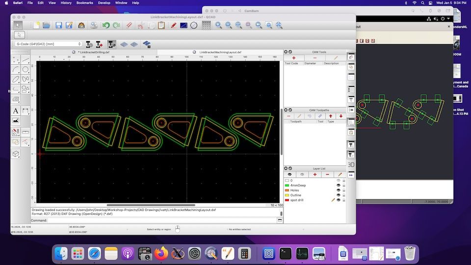

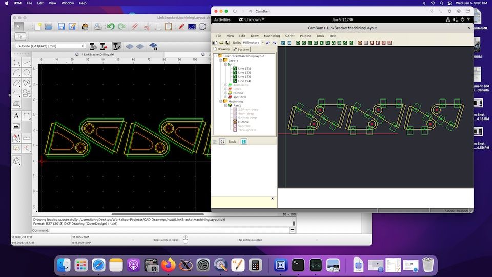

                I too have upgraded my old QCAD license to the latest, with the CAD side purchased as well.
                However, I'm so used to my (licensed) CamBam CAM program that I'm still using that.
                I have a Mac Mini computer with the new M1 chip, and what I do is I run Linux in a Virtual Machine, which contains CamBam. It works really well. I think it's faster than my older Intel based desktop.
                The only small niggle is that I currently have 1 directory shared between the MacOS system and the VM. Not the full directory structure, but that's ok and I can likely modify that later if I wish.
                I'm not sure about QCAM; will keep playing with it, but CamBam is incredible. Something to keep in mind for you should you find QCAM lacking.
                (the VM manager is "UTM", I used a Linux M1 build from the UTM people, and the Raspberry PI version of CamBam)
                FYI for what it's worth. wink
