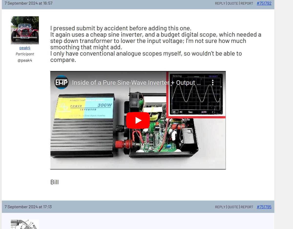

                      It again uses a cheap sine inverter, and a budget digital scope, which needed a step down transformer to lower the input voltage; I’m not sure how much smoothing that might add.
                      I only have conventional analogue scopes myself, so wouldn’t be able to compare.
                      Bill

                                That’s interesting, neither can I, it seems the post has been deleted.
                                I didn’t check the source of the inverter the guy was testing, so maybe it came from AliExpress or somewhere, but the reason I posted it at all, had nothing to do with a suggestion to buy the inverter itself, but was to show the form of the display on a cheap digital scope.
                                As an aside, I’ve just been up to the bedroom workshop to check the waveform output of a little inverter I carry in the car; I couldn’t see that either as my Phillips analogue CRT scope’s died. 😪
                                    Bill
                                    The transformer is likely to make the waveform look much smoother because sharp switching transients are choked by the core, whilst energy stored in it’s windings tend to smooth out the bumps.   Loading the transformer reduces the energy available for smoothing, so the waveform at full power as viewed by the scope might be jagged again.   Also have to be careful about digital scopes introducing display artifacts:  more expensive scopes reduce the problem by sampling faster.
                                    Fitting a tuned filter is the obvious way of making sure the output is a pure sine-wave, or at least close enough for all practical purposes.  Problem is filters at 50 or 60Hz need a hefty inductor – lots of copper and steel – and likely to be as expensive as the total cost of all the other components.  Good filters are more expensive than simple ones.
                                    An alternative is to convert to AC electronically and amplify the signal, which can be near perfect.  Efficiency is low though: bad news on a battery powered system, and the converter comes with a hefty heat-sink.
                                    Worst of all is a dynamotor – these are expensive, poorly regulated, heavy, inefficient, hot, and noisy!
