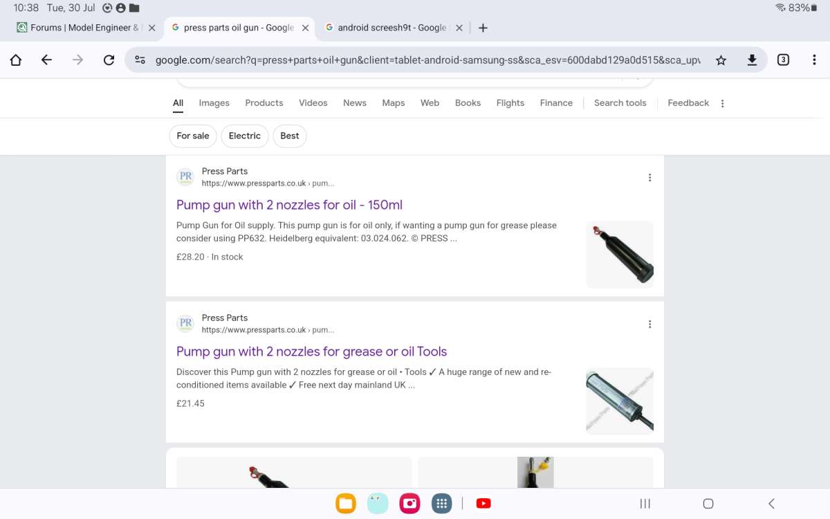

                          Thanks – the link takes me to a silver grease gun – there’s a note at the bottom of the page which suggests ‘PP1081’ specifically for oil, which is a black one – which do you have?
                          I have the silver one.  It seems the black one has been more recently introduced.  It needs someone with £30 to spare to buy one and see if it is suitable for our purposes 😀
                          In general, as Fulmen has suggested, these pump oil guns depend on O rings to make them work.  I dismantled my Wanner and replaced an O ring after more oil started coming out of the sides than the end but this only worked for a short time.  Probably need to find a more specialised O ring –  Viton perhaps.

                                Well I bought the ‘oil gun’ version – so far so good, except that the ‘tip’ which fits the Myford’s oil nipples is slightly too large to reach two of them – one on one of the pulleys and one on the back gear pivot under the spindle. They’re in a recess which is slightly too small. I think I can turn the tip down a few thou to fit – just ordered an M10x1.0mm die to make a stub to do this on. Will report back.

                                  I reduced the diameter of the tip and now can reach all the oiling points on the lathe – as far as I can tell, oil is getting in where it should , and mostly not squirting everywhere!
