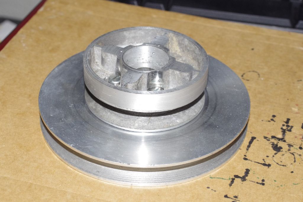

        We have a problem with a 2speed pulley system on the Atlas 12 X 24 lathe. The first set of pulleys from the motor is paired for two speed operation. The high range pair is satisfactory, but the smaller pulley on the motor is smaller than it should be, and is outside the adjustment range for the belt tension. I think the motor pulley pair is not the correct size and it also looks out of place being machined from solid rather than the rest of the pulleys which are castings. The drawings for the machine are no help as only a single speed is shown at that point. There is room inside the casing for a double pulley system from the motor.
        The undersize pulley could be machined off and be replaced with larger to keep the spindle centre distance the same in both speed settings if I could calculate the size. I could even make one if I knew the diameter,any help would be appreciated.

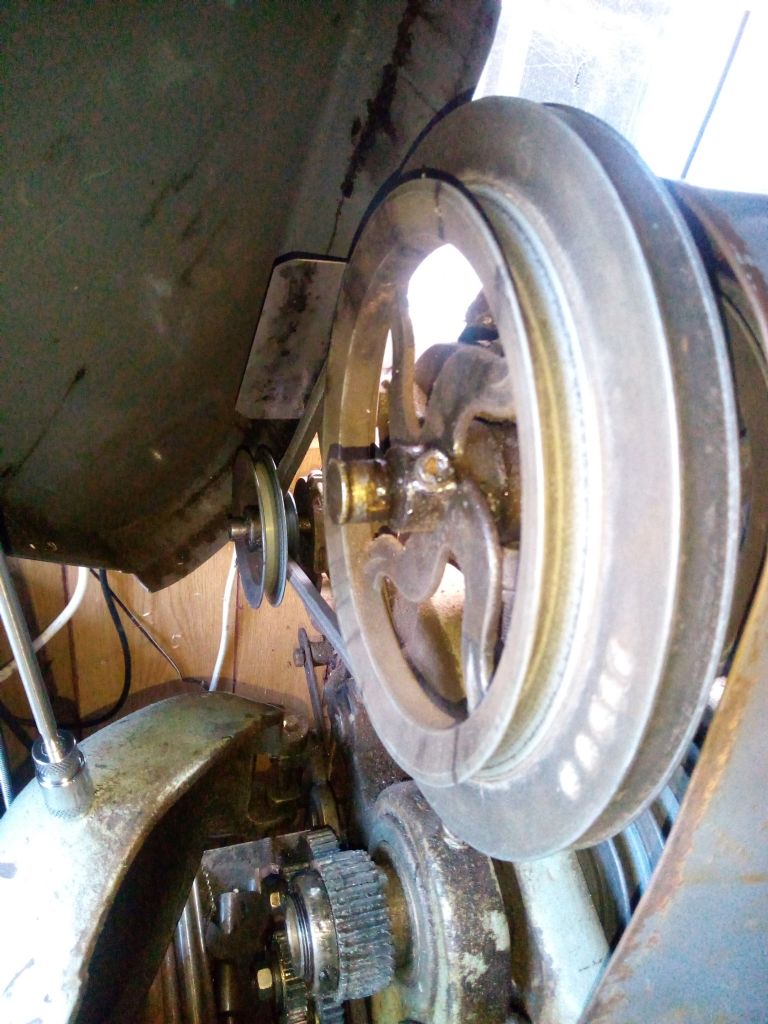

                    Old Mart,
                    I've got an Atlas with 2 speed primary drive. picture attached. Daft question but "do you have the motor pulley as my configuration? small motor pulley to large driven pulley, If not, try reversing the motor pulley on its shaft to look more like mine That works fine for me.
                    Hope this helps
                    Bob D

                      Robert Dodds
                        @robertdodds43397
                        Question.
                        In my photo is the belt set to high or low speed ? With the second cone set to top speed it does about 600rpm with a 1400 rpm motor.
                        Bob D

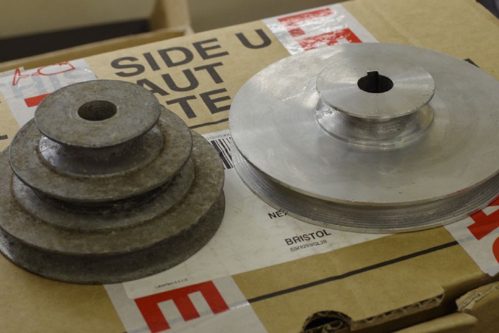

                                _igp2800.jpg_igp2797.jpgSince there were several pulleys knocking around in the junk boxes, I thought I would try out a likely candidate. First, I measured the pulleys. The motor pulleys are 2" and 5 1/4" and the layshaft ones are 7 1/2" and 9". It is the 2" one that is too small. One of the single pulleys was 2 3/4", and when I tried it, it was too small. There was also a triple made by Picador and the centre pulley was 3", and was exactly right. I was surprised that the small 1/4" diameter increase would make such a difference.
                                I shall be machining both pulleys and fixing them together, it will cost nothing.

                                  Posted by old mart on 17/06/2021 17:58:22:
                                  Edited By old mart on 17/06/2021 18:02:51
                                  Hi, well the 3" one would give you about 3/4" of extra belt travel for every RPM, that it does over the 2-3/4" one, multiply that by the motor RPM, which soon adds up to a lot more revs on the driven pulley.

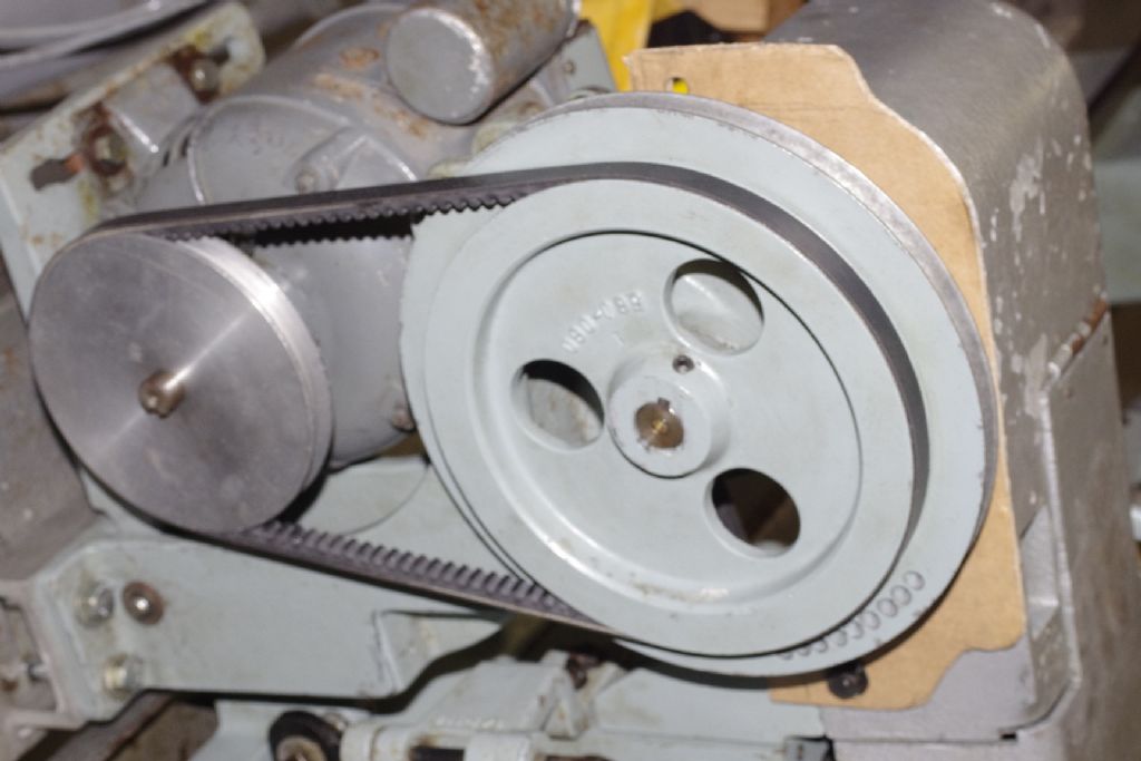

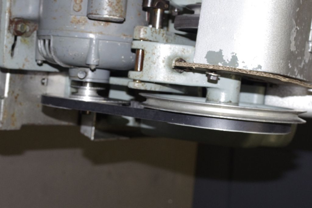

                                        I had a look at the belt system on the Atlas. Keeping the 5 1/4" motor pulley will give a maximum speed of about 1980 rpm. This fits in quite well with the speed of 2080 rpm on the speed label. The difference might be between 50 and 60 Hz.
                                        So I decided to replace the 2" motor pulley with the 3" one, they both share the same 8.5" shaft spacing. The pulleys are fitted together with Loctite 638, and I am part way through adding four 5mm screws for luck.
                                        We will still have to move the door to clear the 5 1/4" motor pulley.

                                          The 5 1/4" and 3" pulleys are now joined, I used Loctite 638, but have added four screws for extra security. The screws I had are going to be replaced with better ones which will be secured with Loctite 270. I will be leaving that plain diameter but will remove the centre part to just above the screw heads.
