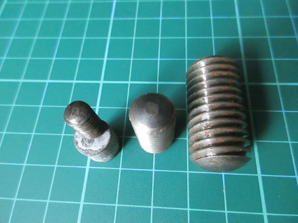

        Hi,
        The V belt pulley I need to fit to the electric motor for my grinding machine it the type which has a cone in the bore with an adaptor to fit various motor shafts.
        This is tightened up with a small grub allen screw, which has vanished off the bench and I can't find it.
        I need to know the thread type. At first I thought it was 1/4'' , but that is a fraction too large . Anyone had similar dealings with these cone adaptors and might know thread type?
        Mike.

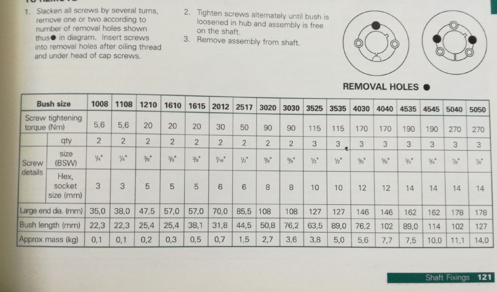

                Threads are BSW and the size depends on the taper lock number, they go from 1/4 in 1008 to 7/8 in 5040.

                  Hi, if it is a Taper-Lock and the shaft is metric, the screws a likely to be metric thread, imperial Taper-Lock ones are imperial thread, but whichever they are, the ends opposite the hex-key end are always slightly domed as in the photo below, if you use any other shape, it is possible that you won't get the taper to lock correctly and they may very well come loose.
                  P. S. Actually HowardT is correct, just looked at my data book.

                    Be aware that taper locks use a BSW threaded grub screw with a metric socket be they for metric or imperial shaft

                        Something I should have done before writing the post is to check the TPI of the split hole.
                        Are the two plain holes for locking pins ? Not conversant with these taper locks. By the way, someone had welded the taper lock to the end of the motor shaft . Took some careful grinding to remove it. Luckily most of the welding was the worst I have ever seen and 50% not penetrated. Good thing is motor is saved. Shaft size is 24mm. Looks like I might have to bore out a new pulley if I can't fix this one.
                        Mike.

                          The holes without the screws in are for extraction of the hub. Take out the clamping screws and put them into the other holes to jack the hub off the pulley.

                            Hi, the the removal holes are shown in an above post of mine, if there are two holes for holding the bush in place, there is only one hole opposite the split to remove it, if the bush has three holding screws, there will be two removal above the two holding screws above the split.

                              There is only one holding screw , or was !! The thread TPI is 20. OD of the missing screw must be just under 0.250. A scan of all the thread charts is now a must.

                                Hi Mike, if there is only one screw holding the tapered bush in, I doubt that it is a "Taper Lock" one. The only 20 TPI thread I can find that is slightly smaller than 1/4 is an ASME 14 / 20 which is 0.242" with a core of 0.177"
