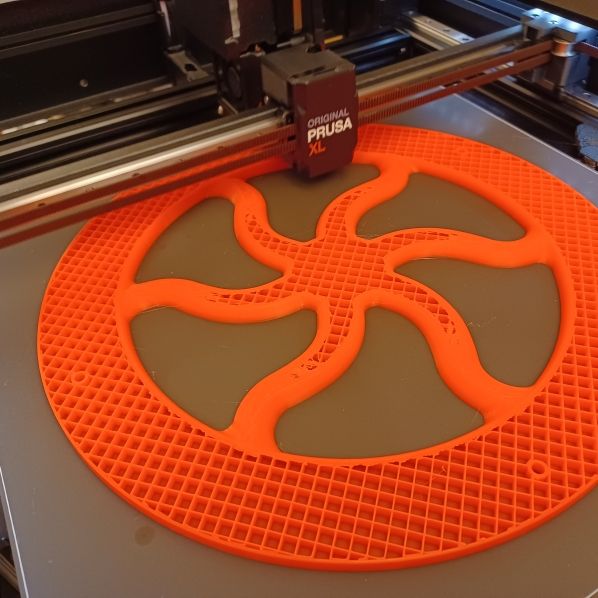

      I purchases a new Prusa XL 3D printer the other day, after being on a waiting list for perhaps a year.
      While I don't have much time to use it yet, the reason I went ahead and ordered one immediately after getting an announcement is that Prusa has had severe supply chain issues, and continues to have issues, and so first days orders take a year to ship.
      I figured if I waited, the delivery could be years away.
      A quick review of the machine in some online videos seems to indicate that many/most folks seem to be very please with their XL's (the few who have been lucky enough to snag one).
      I have tried a few prints on the XL, and I must say it seems to be a very stable machine, with no first layer adjustment required, and so far no bed lifting issues like I have had on other machines.
      JasonB has provided a magnificent flywheel pattern in 3D to me to use as a test, and I am very impressed with his design.
      Jason's flywheel pattern halves printed well with no problems.
      I had hoped for slightly better surface finish, but overall I am very impressed with the XL.
      Print area is 14" cubed, so best to stock up on filament for this printer.

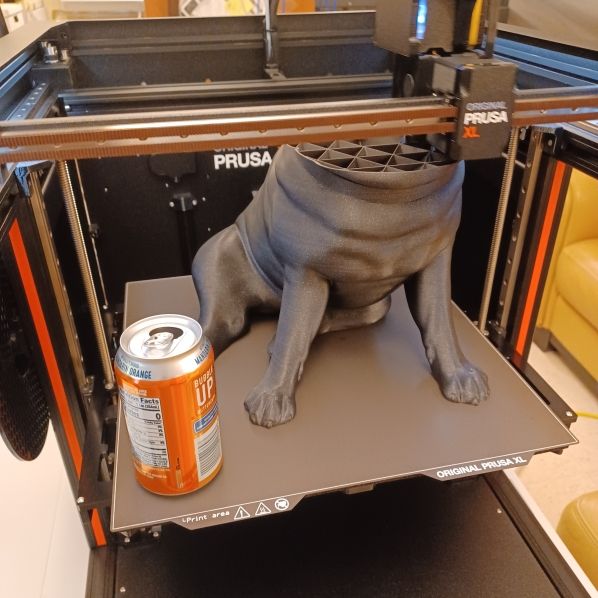

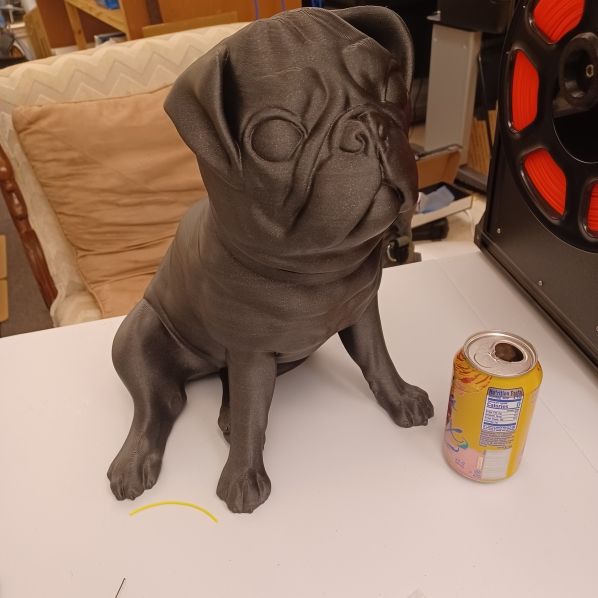

          My first print was a file that was furnished with the printer, and I tried it to gauge the accuracy of an irregular object that took up a lot of the printer's height.
          Again, my only complaint is surface finish, which is slightly more rough on curves surfaces than I would like.
          I was surprised at how well this print turned out without any supports under the disjointed canteliever pieces.

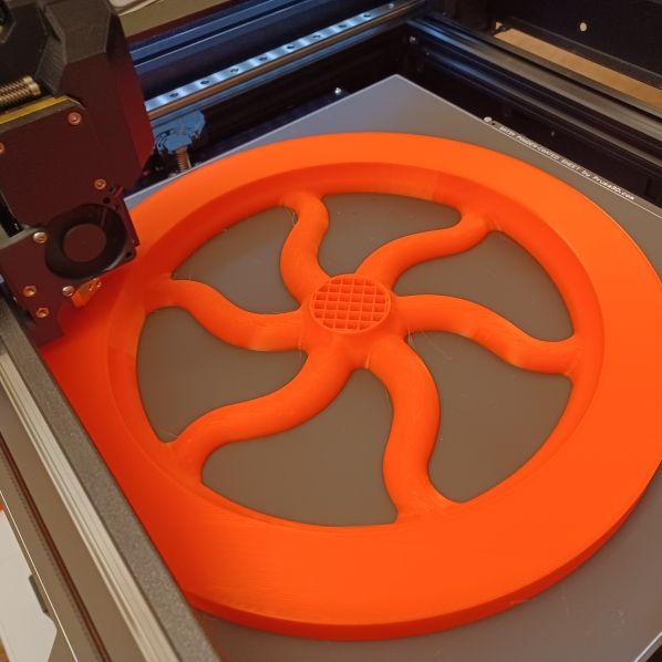

            Next print was JasonB's lovely flywheel pattern halves.
            I printed these at 12" diameter, and I will use these as pattern halves for an upcoming engine build.
            Edited By PatJ on 15/07/2023 11:52:27

                      It would be worth doing some smaller test pieces to try and improve the finish, some of the suggestions about settings and different nozzle sizes suggested on HMEM would be a good starting point before you print anymore large patterns.

                        The prints look impessive but what as you have commented on is the surface finish – the most important thing in foundry pattern making that seems lacking ! Only remedial work will make them usable. When I first heard about 3D printing I thought it would make pattern making so easy but having had several patterns presented for casting that could not be removed from the sand without much additional work either before molding or after casting, I became rather disappointed ! Noel.

                            I've found that default layer heights used by slicer programs are very much a compromise between surface quality and print time. If surface finish is critical, try half the layer height but be prepared to wait a long while!
                            Also, it's worth ensuring that the layer height used equates to a whole number of motor steps. Otherwise it plays catch-up every so often and you get a thicker layer.
