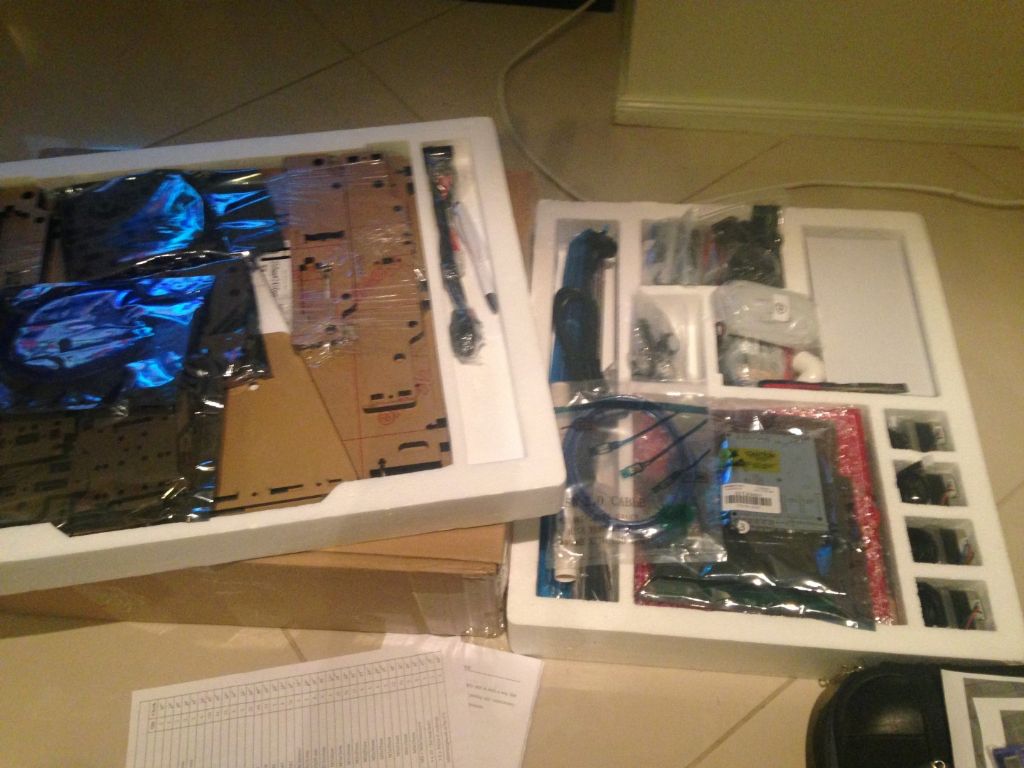

                                Paul Lousick
                                  @paullousick59116
                                  New toy has just arrived. Now to check that all parts are up to spec before I start the assembly. Never enough time in a day though. Neil, where did you get the AS blanket ?
                                  Paul.
