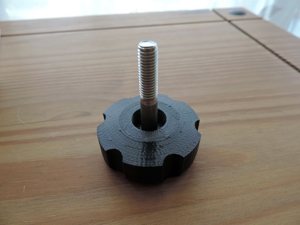

          Doing rather well on a very hi-res 'Benchy' but it came loose when nearly at the roof – too low with the bed temp, I think
          Currently printing a 2" diameter knob to fit an M8 machine screw.

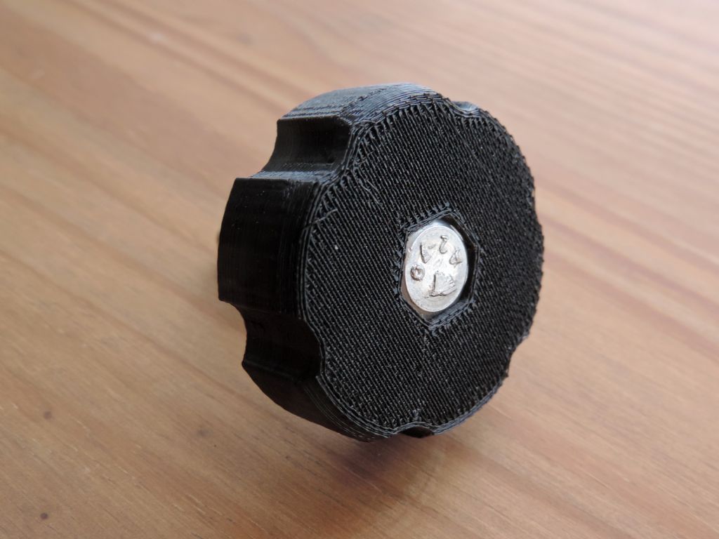

              Well that turned out even better than I hoped!
              Oversize by about .25mm in X and Y, probably largely due to filament ooze, thickness would be dead on 19mm, except I couldn't get the brim (extra 0.4mm) to peel off!
