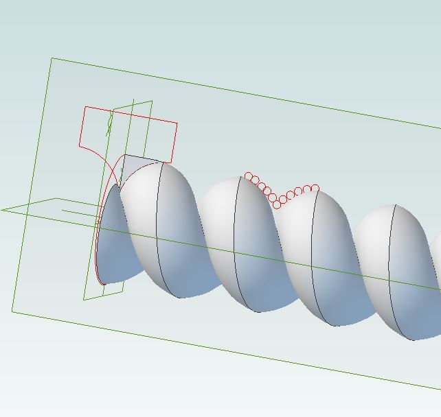

                              John, out of interest what are your CAD skills like? You would need to be able to draw out these spiral shapes as a little spindle like that could only use small diameter cutters so your profile would need to be cut in many passes unlike using a large barley twist type cutter that could be moved in a simple spiral by simple Gcode.
                              #359629
                              john constable

                                  Posted by JasonB on 27/06/2018 12:21:57:
                                  Hi Jason. CAD skills not too bad. Use Visio for 2D and sketchup for 3D and at a pinch I can use Autocad.
                                  Would it not be possible to rotate the work and introduce the cutter, moving it at a chosen speed (like thread cutting on a lathe)?
                                  Edited By john constable on 27/06/2018 12:45:02
                                  #359636
                                    A lathe uses a tool th ewhole width of teh "v" of the thread much like a router-lathe uses a cutter the whole pitch of the spiral typically 60mm for a stair spindle as I said in one of your other threads.
                                    With a small Dremel or engraving spindle you probably won't be able to use a tool much over 1/8" dia so the profile will need to be built up with a series of passes along the helix, you could work out the co-ordinates and manually move the cutter for each pass but with 4-axis CNC and the right program it will do all that for you.
                                    Simple G code will move the cutter a set amount along the work for a set rotation and give the spiral movement but without a full width tool you will simply get a spiral groove much like that shown in the Quorn photo.
                                    EDIT
                                    Profile on the left in read is basically a barlytwist cutter and the shape has been produced buy using a helical cut in one pass as per a router lathe or any other method that can use a full size cutter. If you only have an 1/8" tool then you will need to make multiple passes as shown by the group of circles, the closer they are together (stepover) the smoother the resulting surface.
                                    You may bet away with 0.5mm stepover so on your 2" spindle with 60mm pitch double start that would be about 380 passes, which would be easier to let the CNC work out rather than you manually set the tool for each pass.
                                    Edited By JasonB on 27/06/2018 13:36:39

                                        It will do it but not just a case of one simple spiral cut along the length of your workpiece. Hopefully one of those suggesting using a CNC Router will chip in and say whats involved better than I can. Anyone?
                                        #359685
                                          This is a good example of how one of those small gantry routers will go about cutting a spiral.
                                          #359696
