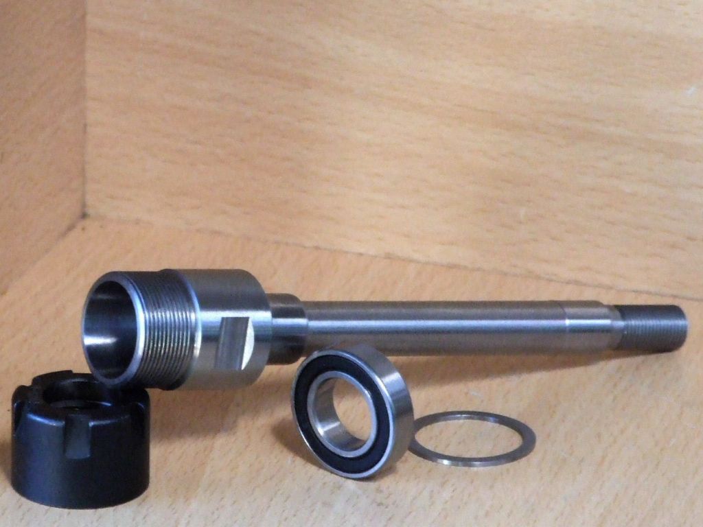

        I have had a chance to make a start on the new spindle for the Proxxon Milling Head which is shown below.
        The front bearing has been increased to 15 mm diameter to make the spindle a bit more rigid without having to modify the quill housing. As this bearing is 1 mm thinner than the original a 1 mm spacer shim is required. While the bearing is rated slightly less than the original I am prepared to live with this. The manufacturer has probably over specified the bearing anyway.
        All I need now are the ER 20 collets to go with the spindle. As regards the associated tooling for this spindle that will now have to wait for a few weeks.
