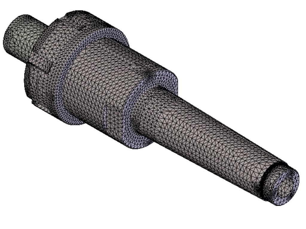

        Posted by Mark C on 19/09/2016 10:59:01:
        i tried saving the report as a pdf but there does not seem to be any way to up-load it, sorry.
        Mark,
        Depending on the content and size of the report; I could convert it to jpeg quite easily.
        eMail it to me & I will have a go.
        #256808
          Here is Mark's FE Report, as a set of 14 images
          **LINK**
          http://www.model-engineer.co.uk/albums/member_album.asp?a=42201

            Thanks Michael G for putting up Mark's pdf. If I was almost "lost" at page 1 by the time I got to 14 I was completely lost !! This is the kind of tests that real engineers would understand and the type of tests that yield valuable data for those that understand them. Well done to Mark for taking the time and trouble to perform the FEA.
            Mark, I notice the bulge in the collet, so that must be why there is only point contact [not even line contact ] and why the collet does not grip at all in the middle, only at the ends. and thus why the test bar was only showing contact at the ends. That may be why they are unsuited to High feed High performance milling. I have a stand alone FEA for Siemens Solidedge but I should NEVER have bought it because it is far too complex for me to understand, so in effect it was a shed load of dough [even with a good discount ] wasted . Ahh well we live and learn. and often at great expense. So Mark well done with the FEA. Thanks.

              Converting to jpg has inevitably reduced image quality, so; I have added a couple of details of the mesh.

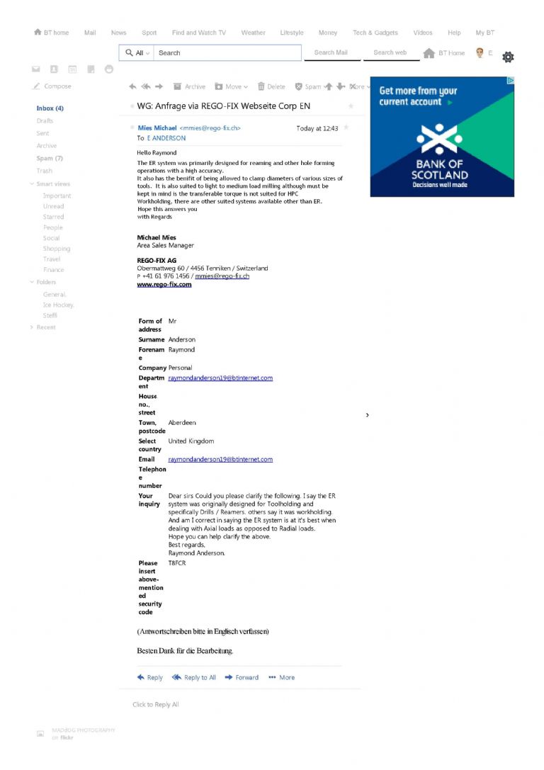

                        Above is the e-mail received earlier. I think it is the same chap who sent me the er details for a previous thread on the er's.
                        I have enjoyed the [sometimes heated ] confab on the subject. I and I think a few others have found it interesting.
                        and thanks to Mark for doing the FEA.
                        I will reiterate once more that as a toolholding system for our [hobbyist ] needs it can't be beat. I wouldn't say otherwise.
                        cheers

                            Point 1 I said they were designed for drilling and reaming , outcome correct.
                            Point 2 That they are weakest at heavy radial forces ie heavy milling
                            Outcome, correct.
                            Point 3 that there are better workholding systems ,Outcome correct.
                            You would have us believe that you know more about this than the originators. Ive got news for you
                            ” big fail ”
                            Do like the attempted side step though. You executed that move like a ” natural “
                            Still haxent seen any of this extensive machinibg experience that you have ???

                                  At the start of this thread a member simply stated that the er system was not designed for work holding only for toolholding, he was met with the reply "utter tosh" . I replied that he was correct. I also stated that they were originally designed for holding Drills / Reamers. again proved correct . I also stated that they were not the best toolholders, I never specified in which scenario that was in. I will concede that I should have specified in an industrial setting. they lack the clamping power for High feed milling. and in our "environment and many industrial scenarios, they are great.
                                  I have proven what I stated in all 3 areas. ie their original design intent , Torque / Rigidity at HPC, and the workholding scenario. As far as I am concerned the case is closed. I have no interest or need to argue this "Ad Infinitum".
