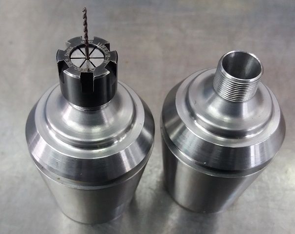

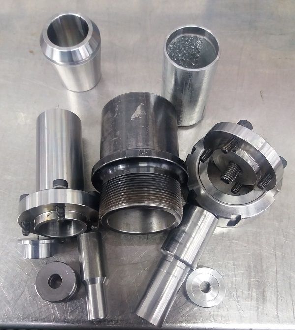

          er40-collet-chuck-with-end-stops-1.jpgThis is what I made for holding various parts at work. I make support pieces to support the collet at the back end, either as a button or as a combined end stop and collet support. For some jobs I make a collet specific to that part with a step in it or what it needs. The outer shape of the ER40 blanks is a standard program in the lathe, so just need to edit the ID detail. These normally work over a small part size range, less than 0.1mm variation. I have also made some Delrin solid colets, and use them as distortion collets. The part neatly slides into the plastic with an end stop on the collet chuck body. So makes it into a dead length set up. Then the plastic distorts and holds the part nicely. With a steel step collet and stop I can hold and second op some quite thin parts down to about 1mm thick. Neil

            Very nice Nick, Is that the collet holder in the center ? Is it held in a 4 jaw ind and dialed in, or is it held in soft jaws. Either way very nice set up. In the top left I think is an Aluminium blank, to get the 0.1 mm range how many times do you slit it ? I take it the parts with the Cap heads are the combined length stop and plug. I like it.

              Posted by Neil Lickfold on 18/09/2016 08:07:32:
              Hi Neil
              Thank you for showing us a practical example of a ER40 collett chuck.
              If you took one of your blanks and shrunk fit a milling cutter into it. Would this alleviate the line contact that is mentioned in the above threads?
              Cheers Michael

                          The collet blank is just from P20 tool steel. I put in 4 slits from the front to about 4mm from the back. Most times the parts are better than 0.02mm diameter and the 4 way slit is good enough. If more range is needed, I add 4 slits from the back and finish at the retract groove. The blackened collet chuck body, sits into 50mm bored softjaws that are torqued to 90NM on the M12 capscrews to keep it all the same. The hydraulic chuck pressure is set to #10 of 24. It was bored and threaded in the softjaws when it was made. It has dedicated softjaws and is always set in the same radial position. A really important and often over looked aspect of the chuck body is the concentricity of the outer thread for the nut and the 8 deg bored taper. If these are out, it will not work as well as when it is actually concentric. I make the thread to be quite a neat fit to the nut that is going to be used and only use the one bearing nut in this case, as it is used to hold parts and not cutters.
                          The plate sitting on the nut is the standard stop and can be used with the tube as an extension needing greater than 25mm diameter but less than 30mm. The cap-tube is the standard extension that takes 25mm diameter stop blanks and can be used with the other tube as an extra 75mm extension to the cap-tube.
                          I have made for carbide cutters with my CNC router which uses the ER16 collets, I made some shrink holders. They work really well. But I have access to the use of an induction heating unit which makes it easier to heat and get the cutters into the holder. Also I needed to modify the diameter of the collet at the front of the groove, otherwise you can't the nut onto the collet. There is a limit as to how long of an extension nose you can make and it's diameter in order to get it all together. I also made some other tools, like a 4 mm ball end with the ER16 shank to use as a setting piece to touch off with and finding the work piece position.

                            Certainly a well thought out piece of kit. very impressed. Neil , How are the blanks held for slitting ? obviously the ones that you slit from both ends have to be machined first then slit . The ones that are only slit at the front are they slit whilst still in the raw state, ie a bar before they are machined. The shrink fit holders you made will certainly provide a massive grip,. especially for use in a router. Excellent. work.
                            Ps, What is the make of lathe you use and does it have live tooling.

                                        Raymond, I put a piece inside the collet that is about 0.01mm smaller than the bored collet. I just cut them slowly with a slitting saw on the cuter grinder, so not milled. Then debur them. I also make adapters from the ER40 to ER11 for holding 1mm drills etc. I also use them in the collet chuck when holding small parts, less than 6mm diameter. I wish that I had live tooling but it just has a 12 station VDI 50 turret, 6 outer and 6 inner.
