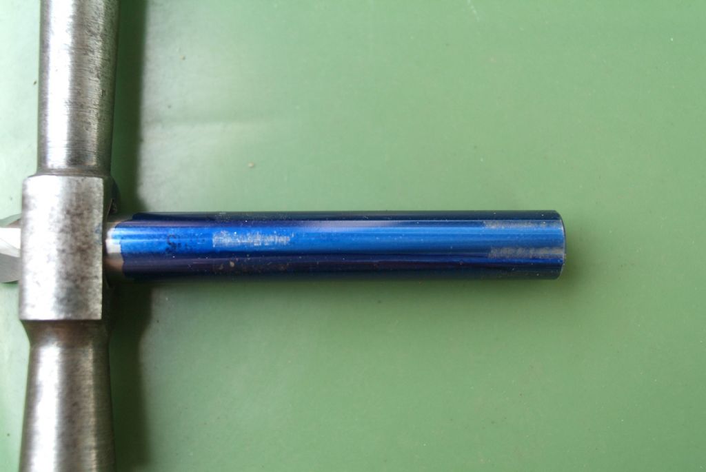

      Belay That,
      I thought I'd take an ER40 Stevenson's Collet Block, a good 11-10 collet, a length of 10mm silver steel and a layout marker and see what happens.
      This is what happens when you apply a 5 degree turn with a pipe wrench with the collet not quite fully locked up but still pretty tight,
      – Nick

          Read the post above yours for an empirical demonstration of the contact achieved with an 11 to 10 ER40 closed down to 10mm, it's 8 point contact at each end without firm contact in the middle, that's where the flex can occur and an accurate CAD Model could show this but modelling a distorted collet is even harder than working out in your head what's happening and it seems that's also very, very hard,
          – Nick

            Nick,, I can see at least 2 lines of contact in the pic [ towards the end of the bar ] Also was the collet spotless, and the bar also ? Also noticed the flex in the center Vey interesting. I could have a go at modelling one in Solidedge which also has FEA, but i've never used the FEA module and would'nt know where to start, and what I would probably come up with would be nowhere near the real happenings.
                  It's a 10mm bar, approximately how close to the end of the bar?
                  #256449
                  Raymond Anderson
                    @raymondanderson34407
                    Looks about 20 odd mm from the end. 1 area going towards the far side of the bar looks like partial cleaned, and the other 2 cleaned areas are toward the front.. Thats why I asked if the collet was spotless and the bar also, as any tiny piece of dirt ect will give a false result. Actually there are too many unknowns doing this to get any accurate findings. The Closer should be torqued to the specified amount for the Ø, and there is no certainty that the silver steel is perfectly round, just because it has a ground finish doesn't mean it is round. It can be lobed, it all depends on how accurate the grinder was set up. So I think any findings are irrelevant.

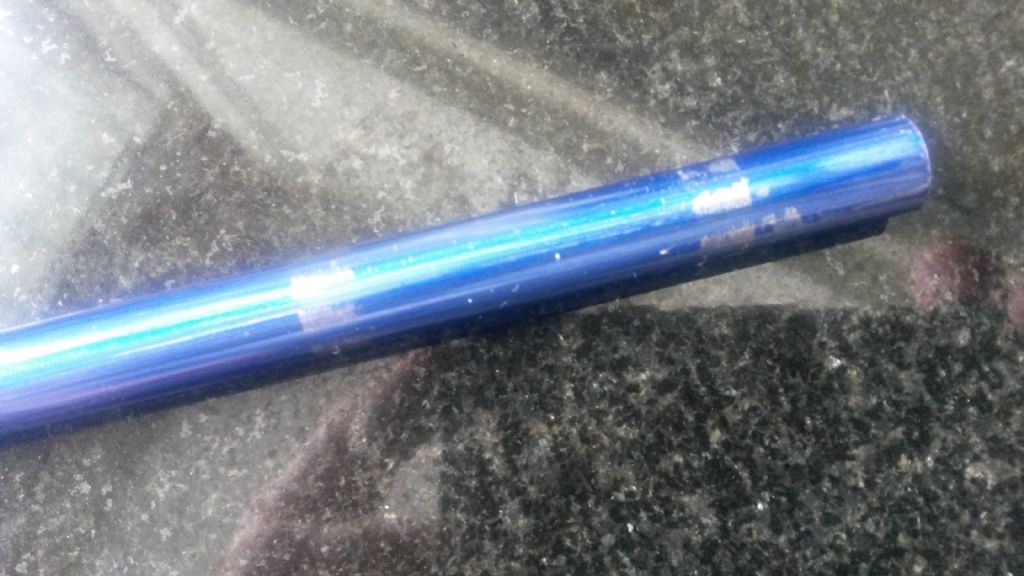

                        As one of the few with extensive machining experience using ER collets and apparently the only one willing or able to get off their fundament and do something I was motivated by Raymond's correct observation that Silver Steel can be out of round to take a solid Tungsten Carbide endmill, grind a flat on it for a tap wrench to grip and repeat the test.
                        With the chuck tightened gradually and the endmill rotated a couple of degrees back and forth each increment to the point where it became impossible to move the endmill with both hands on the tap wrench these are the results –
                        I'm pleased to say that any lines between the contact points are lighting artefacts, thanks to Raymond for inspiring me to use something accurately cylindrical to once again be the only one to get off my fundament and prove this

                          That appears to be line contact with a small rotation applied – what else would explain gaps that wide?
                          The huge area in the middle with no contact at all doesn't look too good though does it!
                          Martin.
                          Edited By blowlamp on 17/09/2016 17:46:22

                            Posted by Nick Hulme on 17/09/2016 17:42:03:
                            – Nick
                            If you're arguing against the 'line contact' theory, why have posted 3 pictures that seem to reinforce it?
                            Martin.

                              It's not a surprise, based on experience it's where I though the "space" would be on an 11 -10 ER Collet tightened down to 10. But as a realith check that's 2 concentric 8 jaw chucks around 30mm apart in a system where all the side load at the contact points is taken by solid metal in compression with no "space" for sideways movement?
                              How bad do you think that could be?

                                All you have proved is what has already been said, that there will be "line contact " As for no experiment , best to let manufacturers R & D departments handle that. where no doubt it will be carried out under correct procedures. As for one of the few with extensive machining experience using ER's Pray, how did you arrive at that conclusion? You seem to know a lot about other forum users and what their experience amounts to . Oh hold on, you must be another of those who sits at gods right hand side. You appear to be the type who could give us the square root of a jar of pickles, but couldn't tell us how to get the lid off.

                                                    Actually, I have learned a bit more in the last part of this debate, because of Nick's photo's and in particular for me, the second one. It shows quite nicely how the gripping points alternate around the bar and from end to end in relation to where the slots finish.
                                                    I think the pictures go to show just how stiff the collet must be in these uncut regions and why it makes sense to insert the tool or workpiece as deep as possible into the collet for best support.
