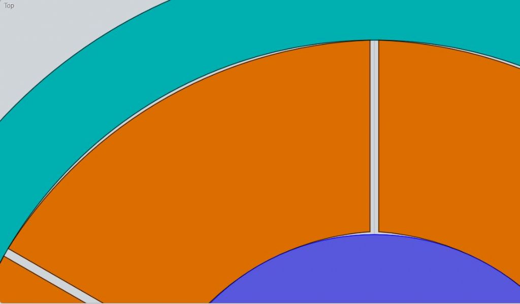

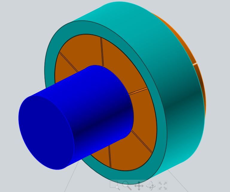

                      I would imagine the ER collets are just about as rigid as most other systems when used at their largest holding capacity. However, with the collet pulled further into its holder, as when gripping smaller tools or workpieces, the collets will have only line contact with the collet holder and the item being held,
                      The first picture is of a simplified holder/collet/tool setup and the second picture is my attempt to show where the gaps would be between the holder, collet and tool.
                      How much this affects accuracy or rigidity I don't know.
                      Martin.

                        As you show, when the tool (or work) is smaller than the nominal size of the collet it will only make line (hopefully broad lines) contact with whatever it is gripping. The OD of the collet though should still make full contact as it is a cone within a cone.
                        Ian

                                    Posted by Ian Phillips on 05/09/2016 20:12:24:
                                    Martin
                                    Ian
                                    I don't think it will Ian. As the collet closes in on itself, the radii of the segments stay the same, but contact at a smaller diameter of the cone.
                                    Martin.

                                      Posted by blowlamp on 05/09/2016 21:36:21:
                                      Martin
                                      Ian
                                      Martin.
                                      Yes I see your point.
                                      The more we look into this whole collet business the more one realises how imperfect they ALL are.
                                      The cone within a cone only make full metal to metal contact in one axial position, for the ID of the collet to reduce the collet has to move axially so immediately compromising the fit.
                                      I suppose we could liken collets to the bumble bee which carries on flying even though the laws of aerodynamics say that it too heavy (or something)
