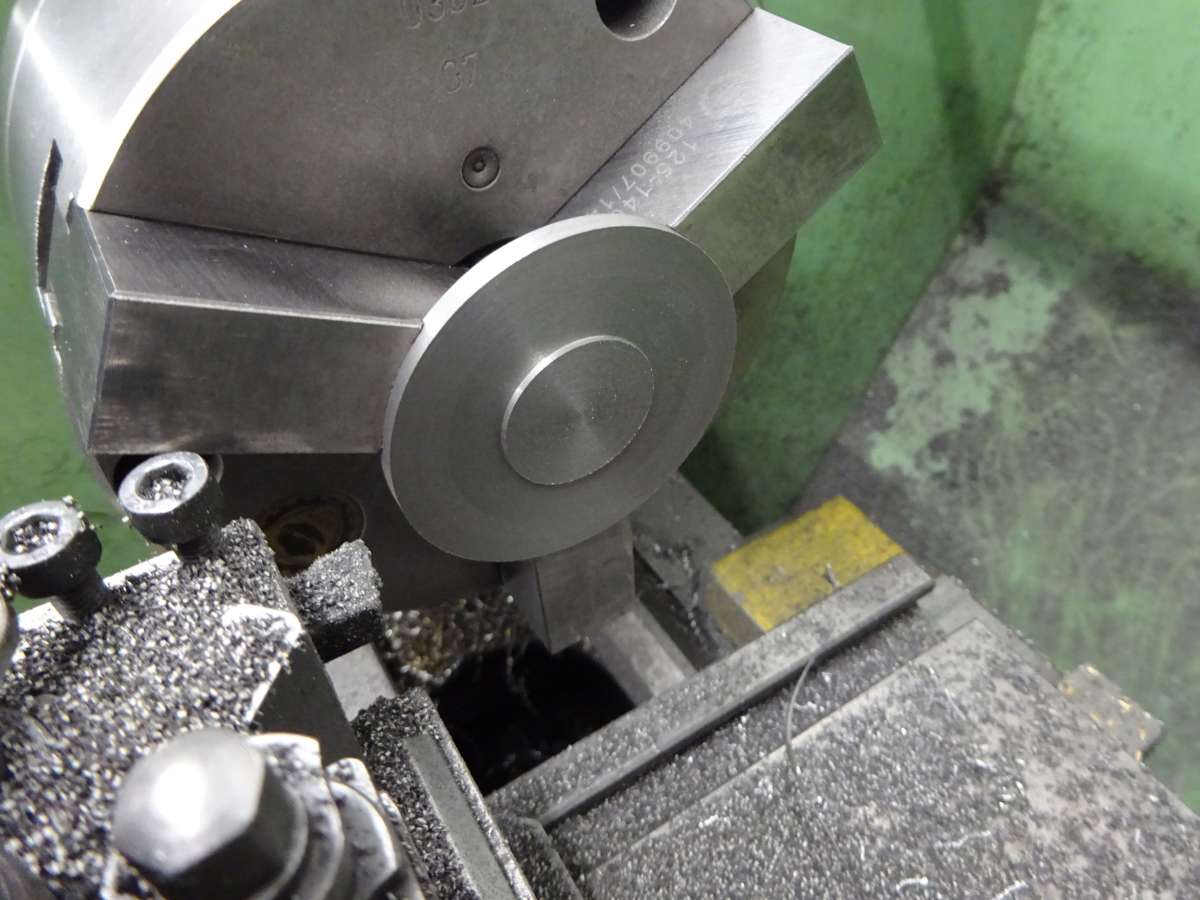

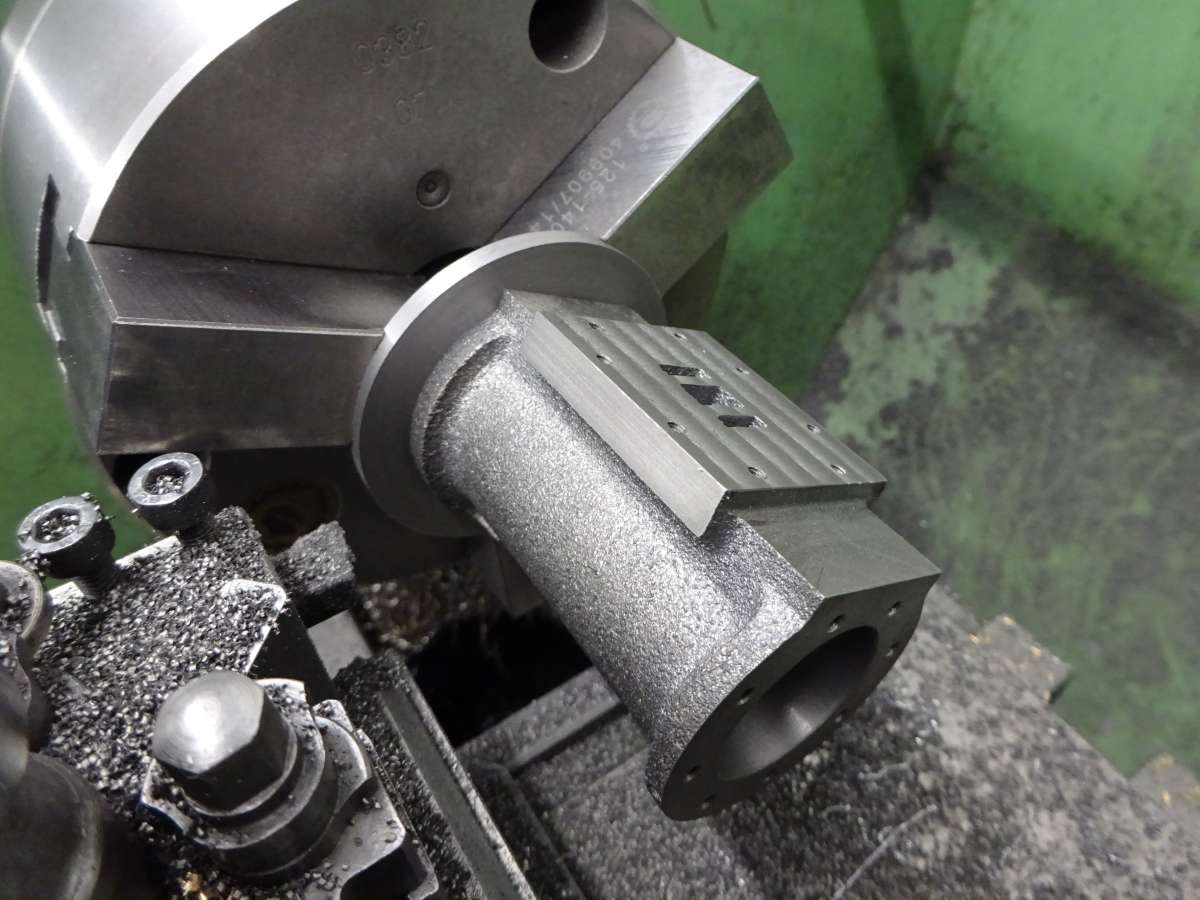

            Or even less expense it to stick with the chuck you have and just get some soft jaws. I was surprised I was the only one who suggested them for getting the front and back face of work running true. Also takes care of concentricity which may be a problem with a mag chuck on a lathe and you are not restricted to magnetic materials

              I thought someone must have mentioned them already – perfect for this job.

                  What chuck is it?  – AFAIK it possible to find soft jaws for most of them, certainly Arc, Warco, and Chester sell them, Rotagrip, Ebay and maybe Chronos or RDG might fill any gaps..
                  Edit – it’s not only the accuracy that is an advantage, because they give such good grip, it’s possible to hold work securely on the slimmest of margins and with a bit of imagination, allowing more surfaces to be turned at one setting..
                  ..or thin-walled or delicate parts without squashing them..

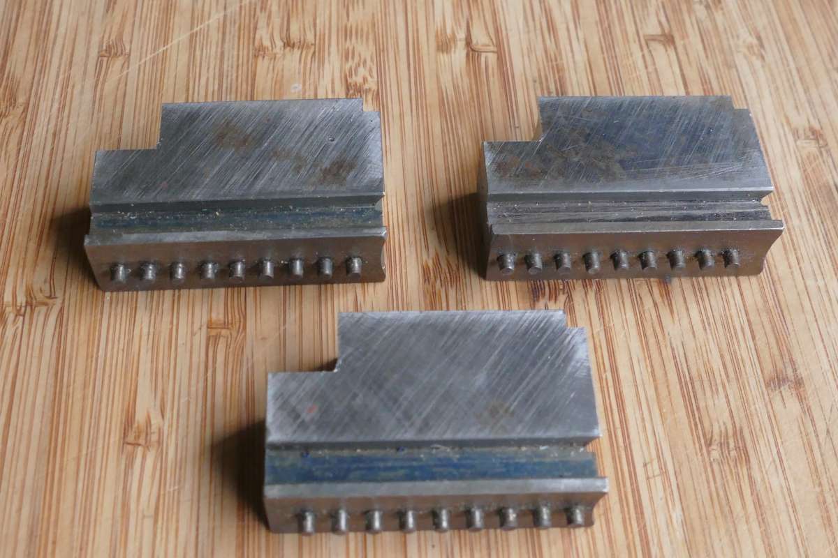

                    Rotagrip do soft aws for imported chucks, that is where I got my first set.
                    Also several options for making soft add ons for standard jaws.

                      Or, on the basis that you are not going to be cranking down hard on small delicate parts, make your own with some mild steel and off the shelf dowels.

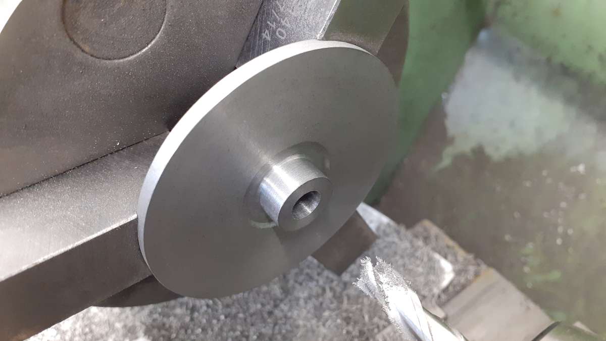

                                The wobble from the arbor is likely be to the short length of “hole” you have in contact with the arbor. Your part only has 1/8″ length of hole in contact due to the rest being a larger counterbore.
                                So if your arbor is just using the diameters to hold the part in position it is likely to have wobbly faces due to the ratio of contact length to diameter. Also any clearance between the two diameters will make things worse.
                                A better way would have been to make the arbor from some more of your 1″ bar. Face the end, turn a spigot that is a light push fit into the larger 5/8″ hole and about 5/16″ long.
                                You can then push the part onto the spigot with a small amount of locktite and use the tailstock to make sure it is pushed up tight to the shoulder of the arbor.
                                Once Loctite has set take gentle cuts to face the outer end back to length. Remove arbor and part, heat to break the Loctite bond and you should have parallel faces.
                                Do not remove an arbor from chuck once it has been machined until job is complete.
                                #725054
                                  I mentioned a light push fit above, this shows the sort of fit that is. For hobby use feel is what is needed not two measurements.
                                  Here is a short 1mm long spigot that has been turned on the inner face of a cylinder end cover. (Softies in use again)
                                  DSC04479
                                  The cyliDSC04479
                                  With just light hand pressure the cylinder can be pushed onto the spigot and stays there.
                                  DSC04478
