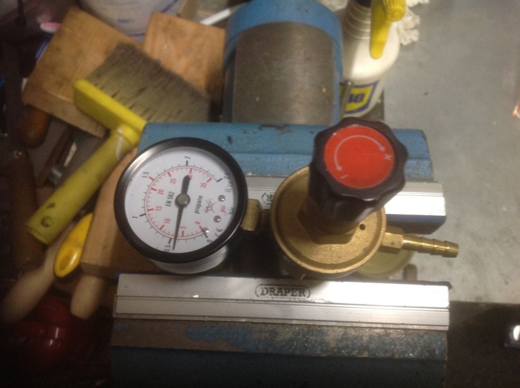

        The regulator pictured was bought new last year and has only been used a handful of times. It is for use on disposable Bernzomatic style gas bottles.
        The problem is that the needle won't return to zero, and wildly erratic readings now result when it is used.
        Does anyone know whether there is a cure for this sort of problem, and if so what?

          Dis-assemble gauge and repair if possible or get a new gauge.

            The most common cause is simply the needle fouling the dial or the glass, easily fixed if the bezel will come off.

                The needle isn't fouling anything visible to me.

                    Maybe a bit of FOD has got into the gauge, which is preventing it returning to zero?
                    I notice it says not to oil it, but could you remove the gauge and alternately apply pressure and vacuum to try to dislodge whatever is causing the jam? Something like a large plastic syringe might do it, with the appropriate tubing and adaptors..

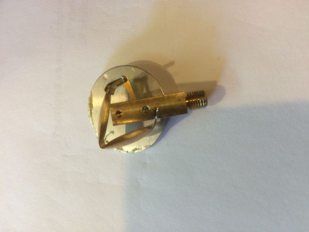

                                      #644217
                                      Bill Phinn
                                        @billphinn90025
                                        Just to round this thread off, I got the needle and the dial plate off, and found a spring inside had become displaced from a toothed half-wheel. After a few trial efforts I worked out where the spring was supposed to sit to get the needle resting comfortably back at zero.
                                        I've been using the regulator without problems for a few weeks now, and I'm confident it's reading the way it was designed to. It gives very stable readings and there is certainly no evidence of any leakage in the system anywhere.
                                        I'm not saying this is a permanent fix, nor advising anyone to follow suit if they encounter a similar problem with their own regulator, but given the way my regulator is now behaving and the fact that it has never been over-pressurized I don't think its safety is necessarily any more compromised now than it was as a result of the way it was originally assembled in the factory.
                                        My motivation for saving it was, as I've already said, the fact that this kind of regulator is no longer for sale anywhere in the UK; if someone one knows differently, I'd be pleased to know where.
