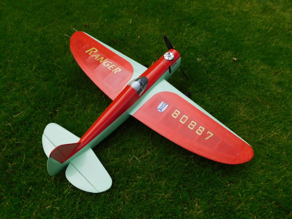

                Just to get you in the mood here's a new model – it's an enlarged 30" span KK Ranger with an OS 20FP glo motor converted to diesel.dscn0632.jpg
