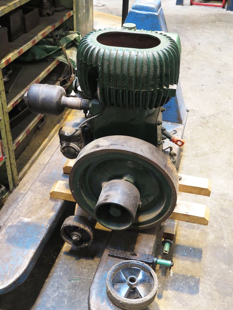

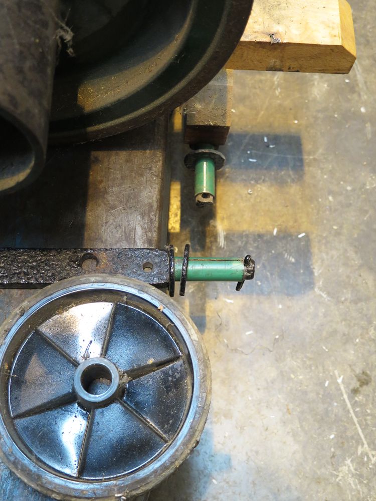

Anyway. He has half a dozen static engines that he bought years ago and never done anything with. One of them is a Wolseley that a previous owner had put plastic wheels onto the trolley of. He had bought 4 cast iron billets years ago to make 4 new wheels with but never got around to making them. …….. I said I would.
On strip down it became evident that new axles would also be needed.

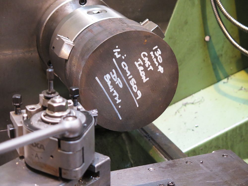

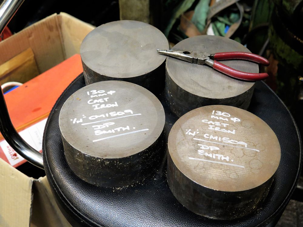

The cast iron stock. – Amazing that although they have been dumped on the floor or the workshop for years they show no signs of rust. I don't know where he got the stock from but they must have a very good saw as they were incredibly square and only varied in length 3 thou between the 4 of them.!

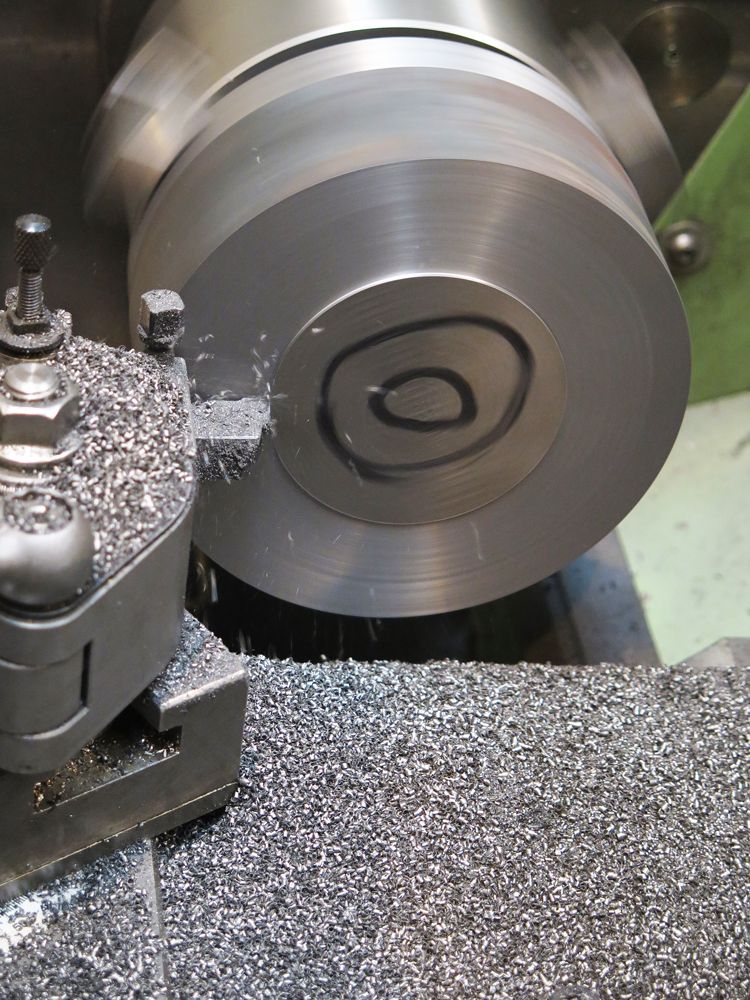

Into my little Boxford.

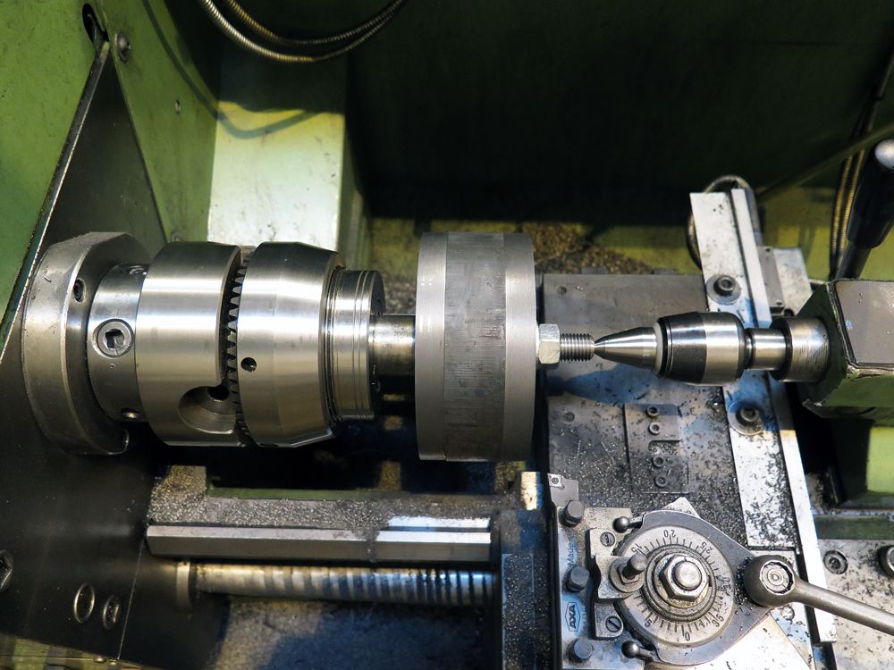

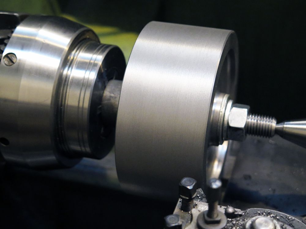

Faced off 8 sides.

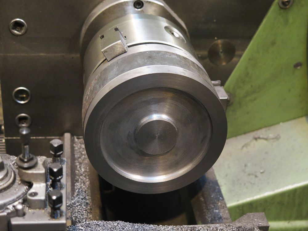

Machined a recess into them – Well I have actually only done one so far.!

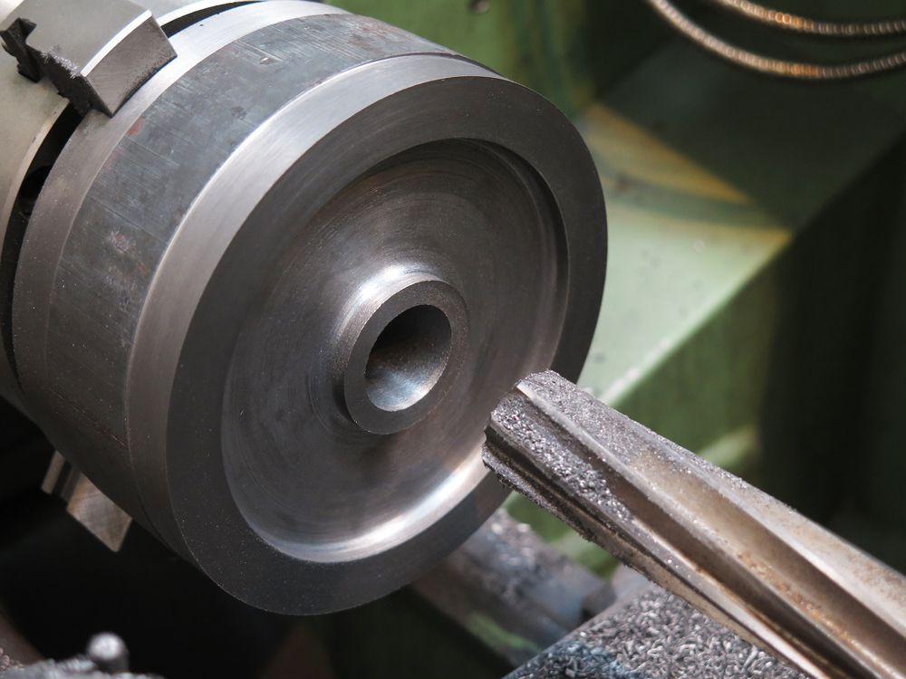

Drilled and reamed to 1"
The bored I will make a bearing for to take a 3/4" axle. Probably no bearing on the original but using one will not do any harm and is good practice for me to make. The originals would also probably have had a deeper recess and even possibly also have had holes. But these ones ain't going to do.!
